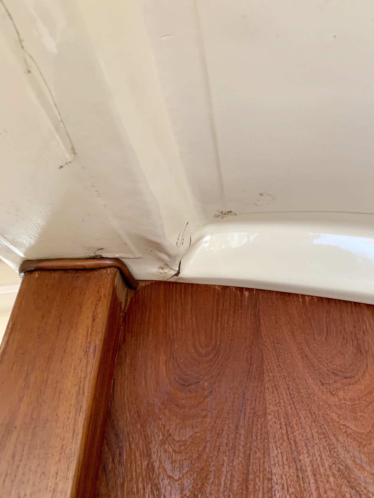

Is this damage serious?
Jun 15, 2019
4
Hunter 25.5 Avl
I am looking at a Hunter 25.5 in pretty good shape overall for a 1985, the only thing of concern on the entire boat is this damage I noticed in the photo above. The owner has a fantastic reputation from what I have gathered and seems to be one of the most reliable guys for partially restored older sailboats. I brought it up to him, he said he noticed it right away when he originally was buying it, took it out and sailed it in strong winds and sat watching for movement. Says there was none and he has sailed it weekly for the past 4 years with no addition cracking or signs of problems with the mast. He is not sure how the damage got there without having other signs of a structural failure. This photo is looking up from the vbirth, wood is the bulk head separating living area. Deck has no signs of damage around mast. Is this something I should worry about? How could one dig into whether this is serious or not?

Hunter built these boats with a FRP liner. That's what you're seeing.
They flex and sometimes crack in spots. It's not a structural problem unless a 'tabbed' bulkhead has come unglued.
8,191
There are signs of water intrusion there. Yes - to be taken seriously.

How would one go about digging into this further to have some confidence before buying?

The wood post in the photo is a compression post, that supports the top deck.
I would carefully inspect the post (top and bottom) for signs of rot or other deterioration.
As noted, the fiberglass you see that is cracked is a liner and is not structural. So if you don’t see signs of damage to the compression post or other concerns, I would not be worried about it.

Those FRP liners in Hunters can be a PITA to take down. But that's what I would want to do. You could then probe the compression post for softness. Sound the underside of the deck. Drill out small parts of the lower deck skin to assess the core material. Or you could have a surveyor test the area. Mast step is a critical area of the boat structure. Watch and wait isn't the route to take. When the "Great Guy" who is selling the boat tells you he has been watching it for four years, he is also telling that there has been water intrusion for four years. Who knows how long before that?

As for the compression post visually I did not see any signs of damage whatsoever. The owner also said he had another guy look at it when he bought it and said he had seen similar damage in other hunters due to over tightening of the rigging. Sounds like it may be a valuable first step to try to find someone that could test for moisture and maybe narrow down first if it’s water intrusion or a physical failure. Sounds like more people are leaning towards water intrusion.

I hear ya. I’m not overly worried about cosmetics, I understand it’s a 30 year old boat it’s not going to be perfect. As the new guy though I don’t want to be the idiot that buys one with a potential serious structural issue and either has a failure or just can’t resell it down the road.

Sadly the inspection of the interior cabin ceiling and the compression post would be a very involved process. The actual compression post is inside the teak veneer casing that we see in the picture. once that's removed, you could inspect the actual cabin top/compression post area and perhaps effect any necessary repairs.
I agree
You need to “dig”until you find out where this water is coming in.
You are potentially looking at a delaminated deck
Not tracking this down is like turning up the car radio to get rid of the engine noise.

I have posted several times what marine yards use to do to find leaks above the water line if hard to find. This is a two person job
First close up the boat and put tape around the hatches so air cannot escape. Cover the companionway with plastic and tape down slitting it with a small hole inserting a leaf blower thru the slit. Tape the slit to leaf blower.
Have a second person with a bucket of soapy water and big brush on top of the deck. Turn on leaf blower and essentially you are pressurizing the cabin and air has to escape. Take and brush everywhere to include fittings with soapy water and where you see air bubbling thru are indicators of leaks. Hope this helps

There are way to many boats out there to be worried about deck delamination and leaking water around the mast. Personally , I’d keep looking. Not only that , but it’s front and center where even a bobsleder could see it. And you are going to buy it? Move on to another project.something you can handle
