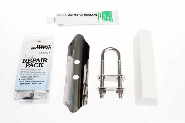

It is at the bow and used when pulling boat into the trailer.
Just in case you use that eye like people do for small power boats...
A keelboat is not a light powerboat. The bow eye is for securing the boat. You FLOAT the sailboat onto the trailer, and use the bow eye to secure it in position and from sliding backwards while you drive up the ramp.
Like other have said, check for cracking inside the hull and re-enforce it if needed, with a backing plate or some other system.
The c22 is a similar sized hull with similar sized eye. The c22 sub forum has some threads about doing that.
Hopefully just gelcoat damage.
You can buy a nice stainless protective plate for the outside.
Here is what the c22 repair kit looks like.
White thing on the right is backing block.
I have seen similar for other boats.

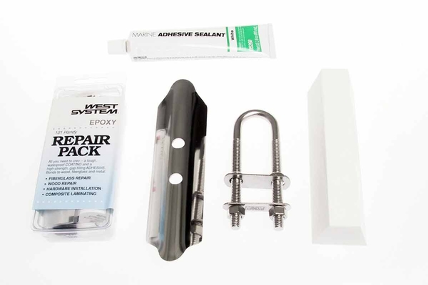

This is perfect and seem like juts makes the most sense to be safe. I will inspect the inside for sure but options like these are great to have.
