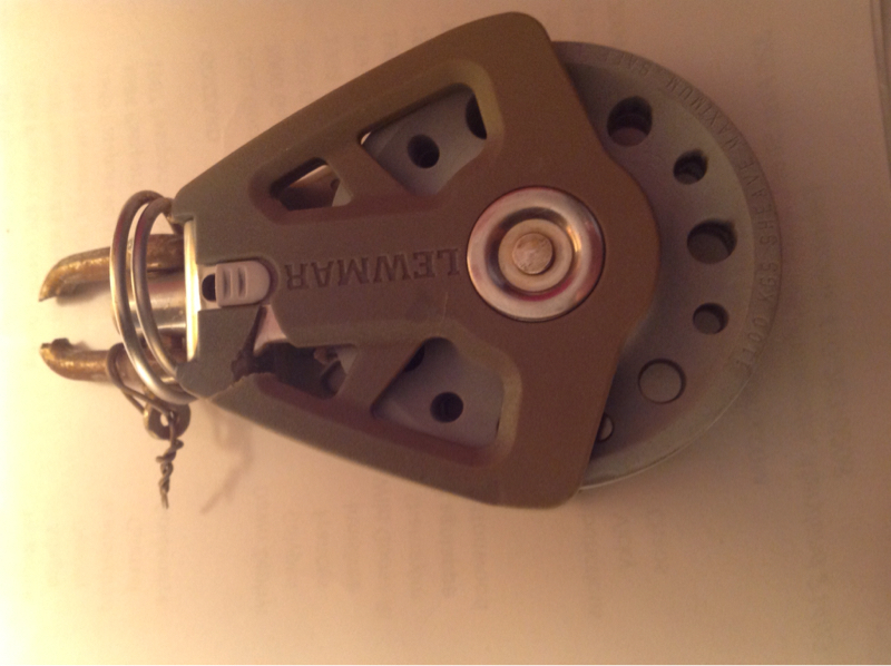

It was stormy, windy and tricky on Biscayne Bay today. With winds gusting to 20 knots I decided to add a reefed main to the already reefed Genoa. Turn to windward, ease the outhaul, furl some main and tighten the outhaul. BANG! What was THAT? A quick survey showed that the block at the base of the mast which directs the outhaul back toward the cockpit had broken.
Note that both the shackle and the block itself are broken. My boat is a 2006 and the blocks are original. Do I need to change them all? Any quality issues with this Lewmar? Suggested replacements?

Probably a shackle only failure.. The plastic is not load bearing and probably cracked from the impact after the shackle failed. You could replace the shackle only.. Do inspect the other block's shackles .. that looks like a substandard piece because of the large amount of rust on the "stainless".. Ya might want to take some good pictures and talk to the Lewmar folks.. they may want to replace it for you, since that is not a normal failure.

Lewmar would have bought the shackle from a supplier.. That one looks like it is not the correct stainless recipe .. probably from an "offshore" supplier.
Glad that Lewmar stepped up and corrected it for you. I think they took a step to "the dark side" a few years ago and are now getting back to better quality control..

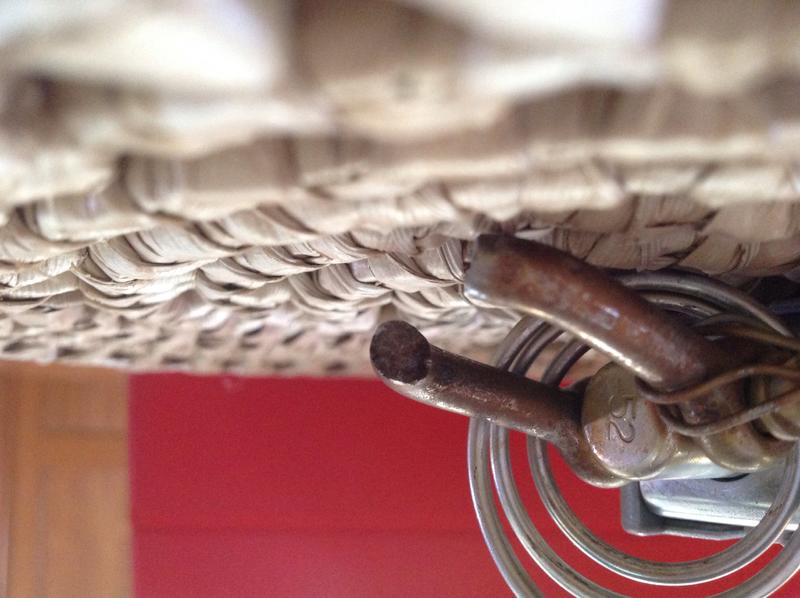

I used a jeweler's loupe to have a look at the metal. The SURFACE looks fine - just discolored. If I used a polish on it, I think it would look brand new. But the metal INSIDE is absolutely "spongey" looking - not pure metal - absolutely porous.
10,115
Yup.. really a bad piece of metal.. (nice picture) You probably would have seen a crack that made the rusty stain, had you looked at it before it broke.. Good inspection job ! .. notice how the stain is speckled in many places .. the furthest away shackle leg, about half way along it .. you can see speckles.. different from the way rust stains look from not being passivated correctly..
Stress corrosion cracking is probably what did the break..
