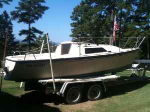

Hello! I am a new participant here. Long story short, my 14 year old son and I have developed an interest in boating in general, and sailing specifically. We live in central Arkansas, near several lakes.
I have found an O'Day 22 foot boat for sale. It appears to be a 222 but I haven't had the opportunity to go see it yet. I am wondering if this is a good boat to learn on... is it forgiving? Is it high maintenance, or rugged?
I see this being a day boat in Arkansas lakes: not a lot of high winds/waves and always in visible sight of shore.

Howard,
If this boat is an O'Day 222 and it sure looks like one, it's not only a great boat to learn on but it's a keeper. It's a boat that you're going to hang on to for many years to come provided you don't get "big boatitis" and you'll wind up kicking yourself like my friend Walter did when he sold his.
These boats have keel/centerboards and the keel weighs in at 800 lbs so it's a great boat to learn on because it's pretty stable and forgiving for it's size. Also, you can sail her with just the Mainsail with a decent wind and take her through the tacks. Some boats don't respond too well without a head sail, but this one will. I generally sail my 222 about 30 miles every week out on the bay and spend at least two days on her. I don't see these boats as high maintenance. I leave my boat on a mooring at our yacht club so I need to apply anti foul bottom paint to the hull about ever two seasons.
The rudder blades on some of the O'Days including the 222 have been known to break. I went through two and wound up buying a solid blade off Rudy at D&R Marine and haven't had a problem. If you can get the VIN numbers off the upper right hand side of the transom and post it for me, I can give you more information on the year and month that the boat was built. One other thing that needs mentioning is that there should be a 1" metal tension bar in the cabin that supports the mast from the square post on the galley cabinet. O'Day didn't install them on some of their O'Day 222s for some reason. This is called a mast tension bar and it's needed. Check the boat out good especially the rudder blade for cracks. These are rugged boats and they will cruise just about anywhere that their big sisters will go. A good one is worth hanging on to.
