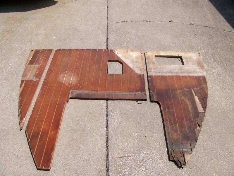

I found this picture on the site and noticed that the sole has the same soft/rotted spot as my H34, right between the engine and the ice box, at the tip of the panel.
I'm in the process of replacing all the teak and holly and was wondering if there is some issue which is causing this problem.
Leakage through the companion way? Ice box leakage? Water in the bilge or below the sole?

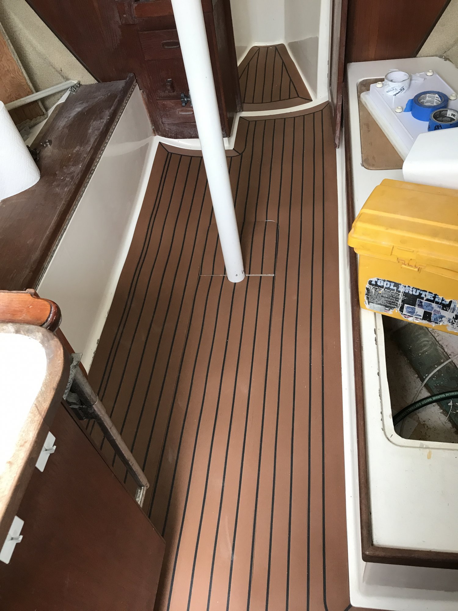

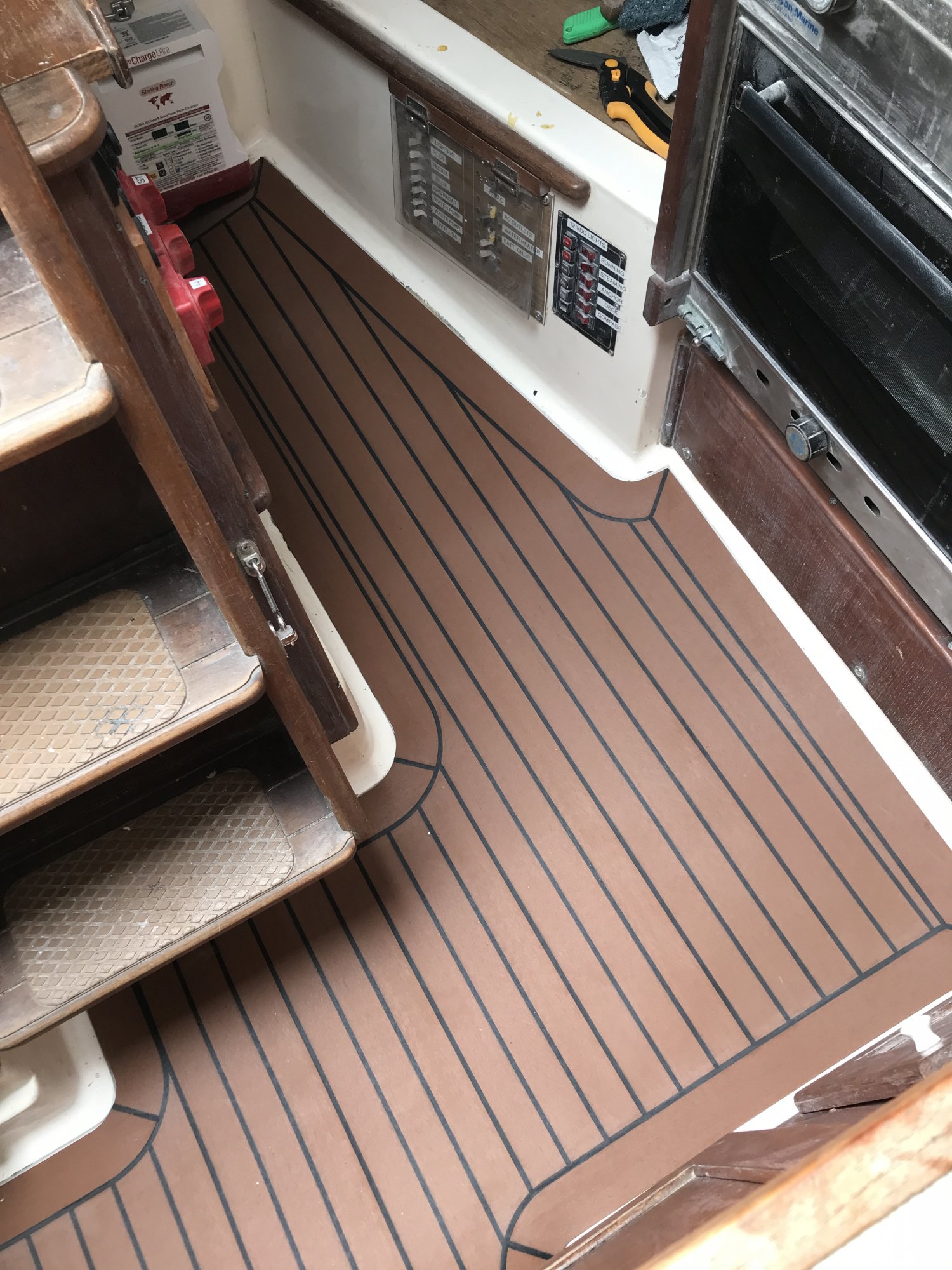

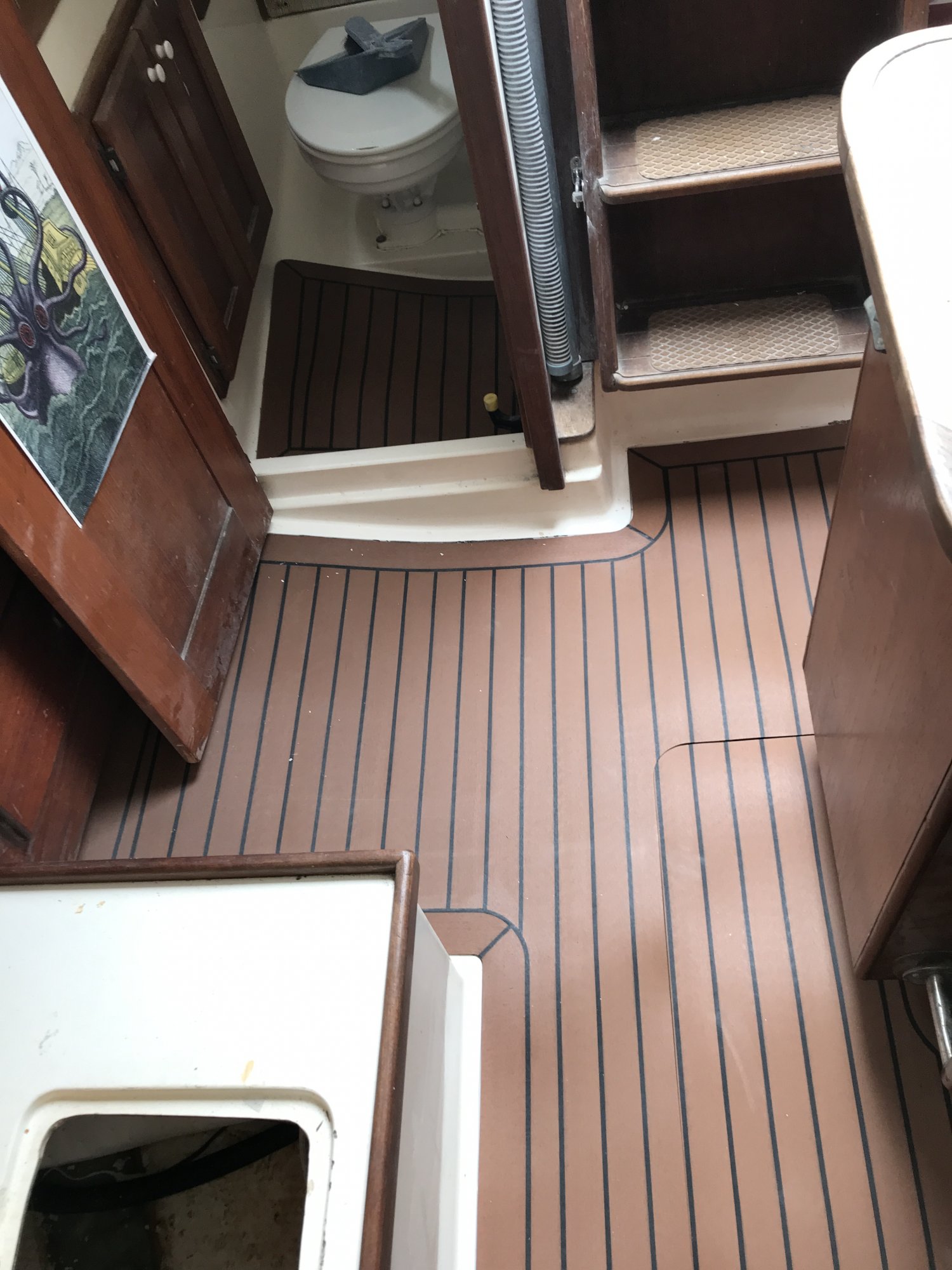

I have a different boat but it originally had the same plywood veneer flooring. Mine was destroyed by rain coming through the companionway over the years. I replaced the entire cabin sole with a PlasDeck Vinyl product. This product is made for outside decks and should not be affected by rain or UV light. The photos below are before the flooring was glued down, just as it came from the factory made to a template I supplied to them.
View attachment 208857View attachment 208858View attachment 208859
Roy,
Did you lay that down over the existing (old) flooring?
RoyS
Jun 3, 2012
1,742
I removed the old plywood flooring completely down to the fiberglass liner. The plywood came up with a lot of prying. The greater difficulty was removing the residual silicone caulking/adhesive that held it down. Careful scraping with razor blades and messy sanding with scotch pads eventually got it all off. The new vinyl flooring is almost the same thickness as the old plywood and fit nicely in the fiberglass liner recess.
