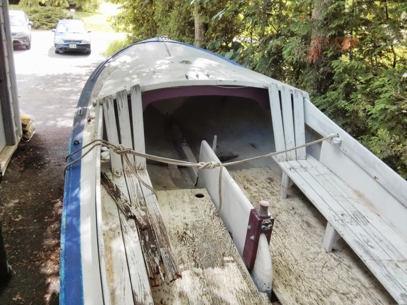

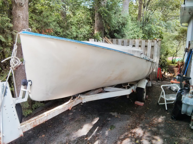

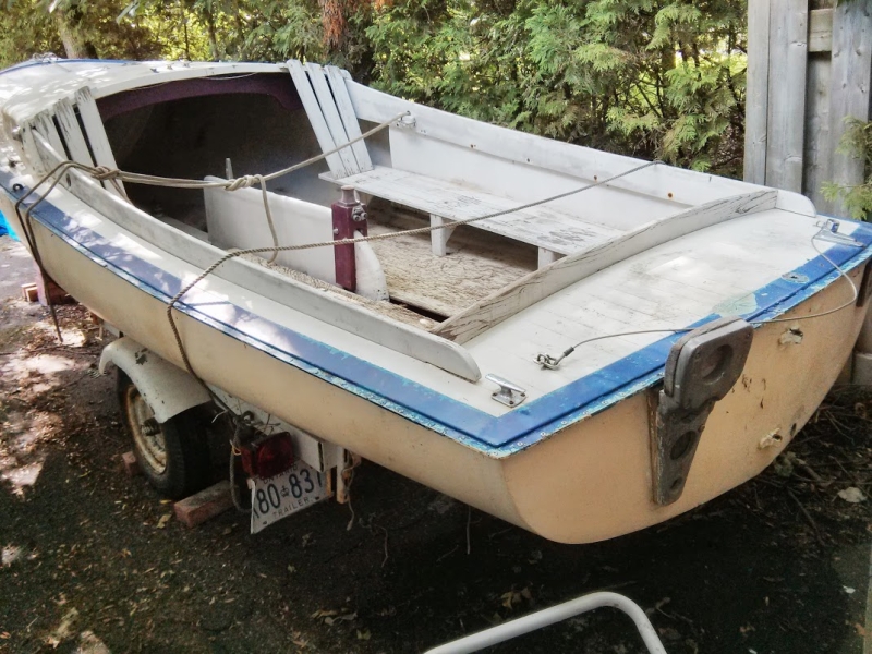

Hi All,
I was recently given a 16' O'Day Daysailer. My brother's in-laws bought it and the trailer about 10 years ago and it's been in storage ever since. As the pictures show, it's in desperate need of some fibreglass and wood work (and soap!). The hull number is 1985, class 249.
As far as I can tell I've got most of the major bits and pieces. The mast, boom, daggerboard and rudder. I've got the sails but they were just stored in a garbage bag, and I've yet to give those a good inspection.
Structurally, the hull looks to be in pretty good shape. There's some stress cracks around the opening to the cuddy. There's going to be some fibreglass work to do.
I think the 'gelcoat' (I'm not even sure if it's gel coat or just multiple layers of paint) on the hull will have to me all sanded down and new gel coat applied.
All the interior wood will have to be redone. I read that extra floatation was added to later models of these boats to make them easier to right after capsizing. I'm a bit concerned when I look at most pictures of Daysailers and see the fibreglass bench seats. Is there additional floatation under there and should that be a concern to me.
If I wanted to get a little outboard motor to put on this, any suggestions as to the size and type of motor.
I'm wondering, when you guys look at this, what would be your main concerns or recommendations? Do you think it's worth the time? I'm in no big rush to get it on the water, I'm approaching it more as a nice project to keep me out of the wife's hair!

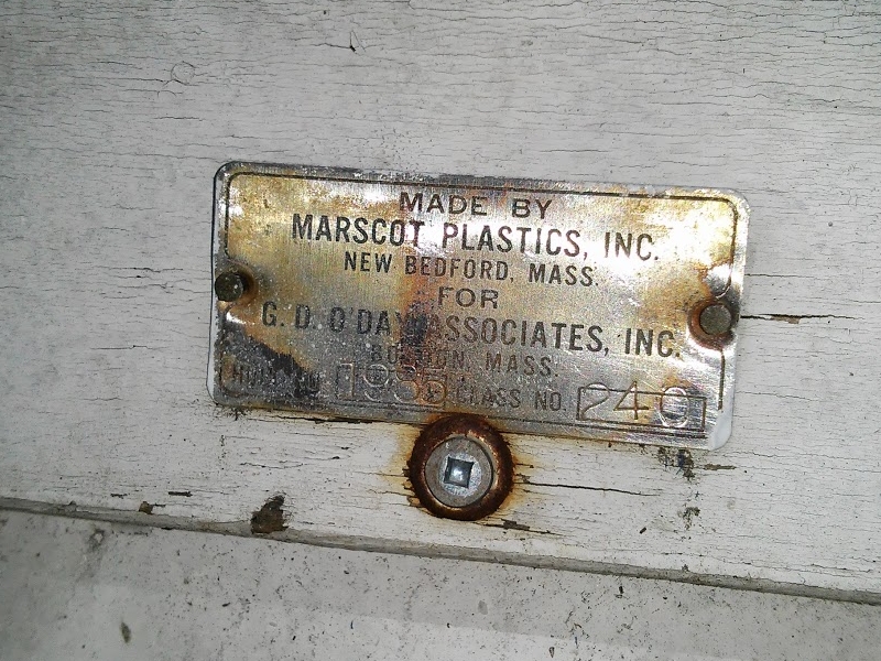

Well, the only thing I'll add at this time is that Hull# 1985 CLass# 249 would be a 1959 or maybe 1960 DAY SAILER. In other words, built during the first or second year of production....... fixed up, she is worth something! Fixed only enough to go sailing.... she is still priceless to you. If you were to lose interest....... an ad on the Day Sailer Class Web Site will bring many inquiries.... www.daysailer.org
The early boats had wooden seats and you may notice that the sides of the cockpit extend to the hull bottom, unlike later boats.... that area contains the foam and was meant to trap air as well for flotation, one concern might be the hatch cut into the section under the after deck, but that could be resealed or maybe a watertight hatch fitted. I have added a few pictures of 1958-9 models to help explain what I'm refering to. The seats on the later DS I boats did have flotation foam under them, but they did not have the foam under the side decks like the 1958-9 models. The Day Sailer II model (introduced 1971) has the closeable cuddy and molded-in cockpit that is "self-bailing" these changes were made to allow much easier self-rescue from a capsize, the DS I may be harder to recover fro ma capsize, but that would not stop me from owning one! There is plenty of flotation in even the early DS I to float the boat and ocupants, although check to be sure it isn't waterlogged.... if so, replacing hte foam is a good idea (just not easy to do!) Installing inspection ports that can be sealed to allow access to those under-deck areas wil lhelp to dry out any dampness.

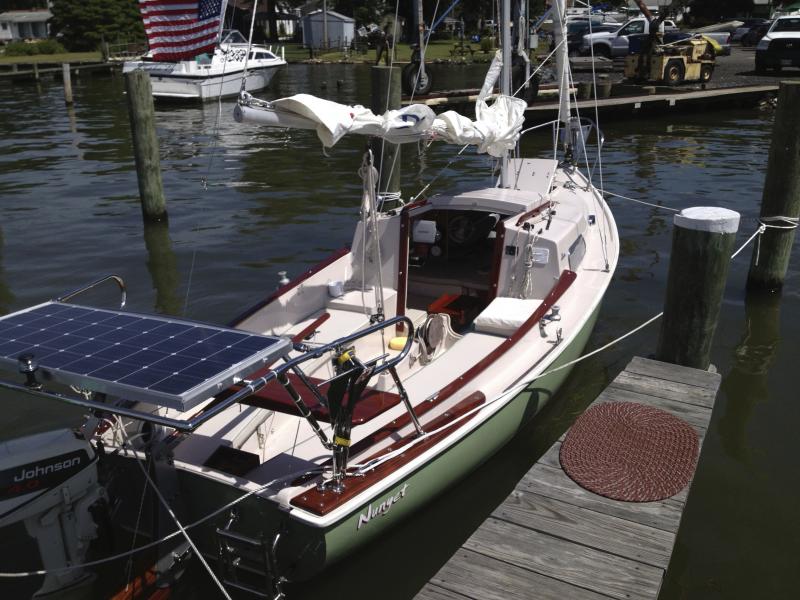

Before and after.
robj
p.s. How do you make a $600 boat worth $3000?
Spend $6000 on it!

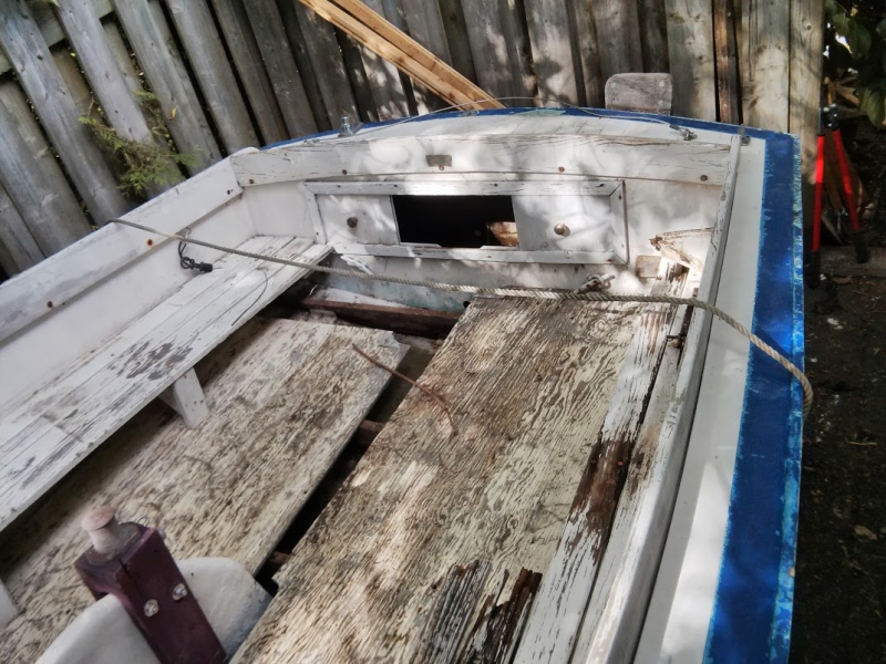

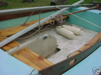

From your pictures, you will probably need to replace the wooden benches. It is not a difficult task if you have any woodworking and epoxy/fiberglass skills.
Styrofoam blocks can be used for added floatation under the seats. Attach the blocks to the underside of the seats, not the floor of the cockpit so they won't absorb water. Do things in small steps. Don't try to redesign the boat but do make incremental changes that make sense since technology and materials have changed since this boat was designed.

It looks like the floors are plenty good enough for patterns, so your cost there would be a sheet of plywood and some paint, as long as the stringers are solid enough to screw to.
Same for the seats. If you are not looking to "restore", nothing says you couldn't use plwood with some limber holes for drainage for the seats as well.
That, and a gallon of paint would go a long way. [Google "house paint for boats" if money is an issue]
As far as the appearence of the hull, if it's been painted I would not worry about trying to remove old paint and re-gelcoating, just sand, primer and repaint.
If it's not been painted, it's pretty amazing how well old gelcoat can be restored. I think way too many jump right to paint when there's plenty of life left in the gelcoat.
