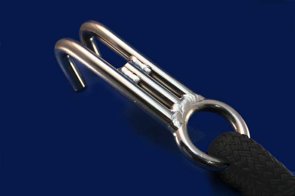

My Hunter boat has 2 reinforced cleats and a through "eye bolt" inside the Anchor closet. The boat came with a chain link double forked SSteel that grabs a single link and connects to the Eyebolt with a smaller chain (see picture). That is what i called the tensioner but should have called snubber, I guess.
One fork snapped and one bent straight so it was inadequate during our 4 hour ordeal. We now have a 5/8" cable and snap hook that will take 15k lbs of impact tension, but no shock adsorbing snubber.
I just did a quick anchor snubber search, which should reduce the impact of anchor strains/shocks in addition to our tensioner/snubber.

Forget those "shockles" things, they're worthless. That chain grip thing you have was most likely designed to stow your anchor while underway. A nice long length of triple braid nylon rode gives you the kind of stretch and shock-absorption you are looking for. Take it to a cleat, not that eye in your anchor locker.
BTW, scope is for keeping your anchor in the bottom. Not for absorbing snatch loads when you anchor somewhere you really should not anchor.
