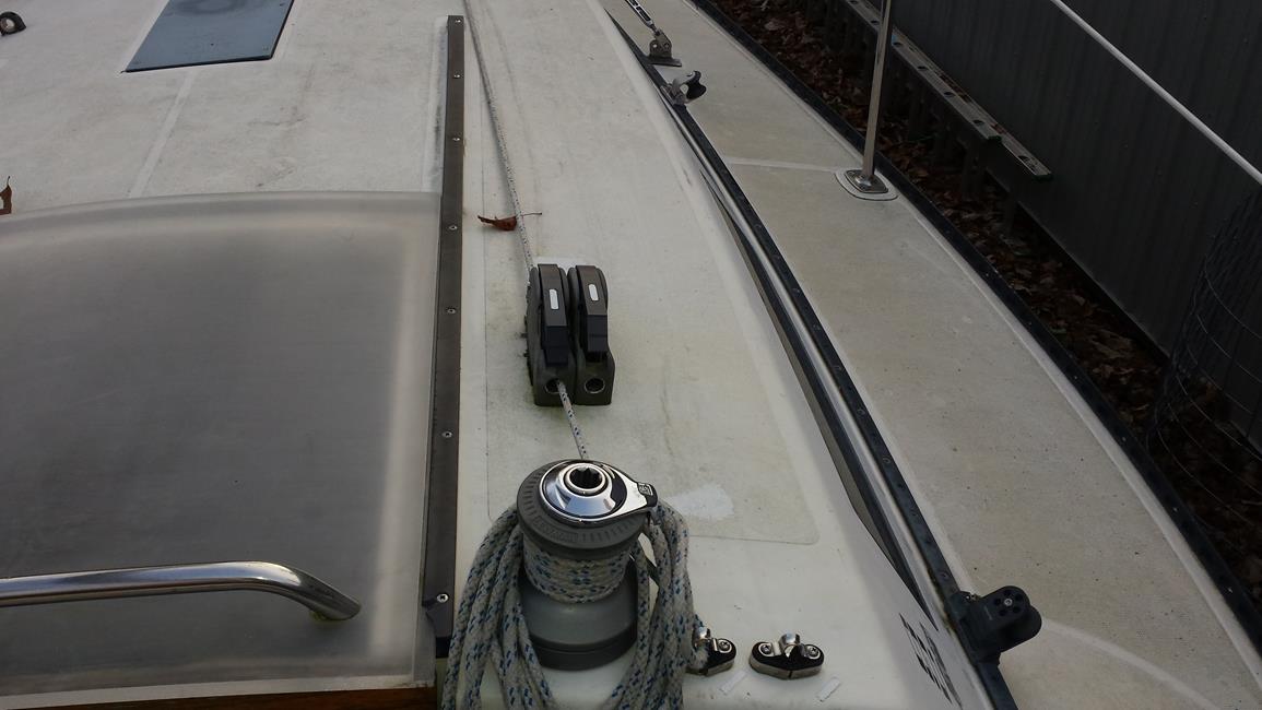

I am attempting to fix split hatch railsfor my boat, and since I get better responses here than elsewhere... (you know NOT a capri).
I know I can buy sheets of starboard in 3/4 inch by 54 or less.. what I need to do is 1" by 50" cut into a C shape (see black tracks below)... My thought was to laminate 2 3/4" inchers together, then route out a groove for the hatch itself to slide in...
