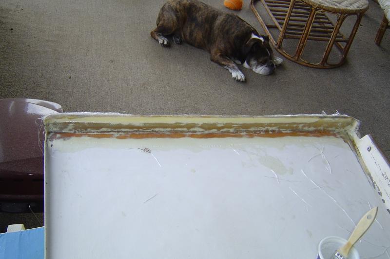

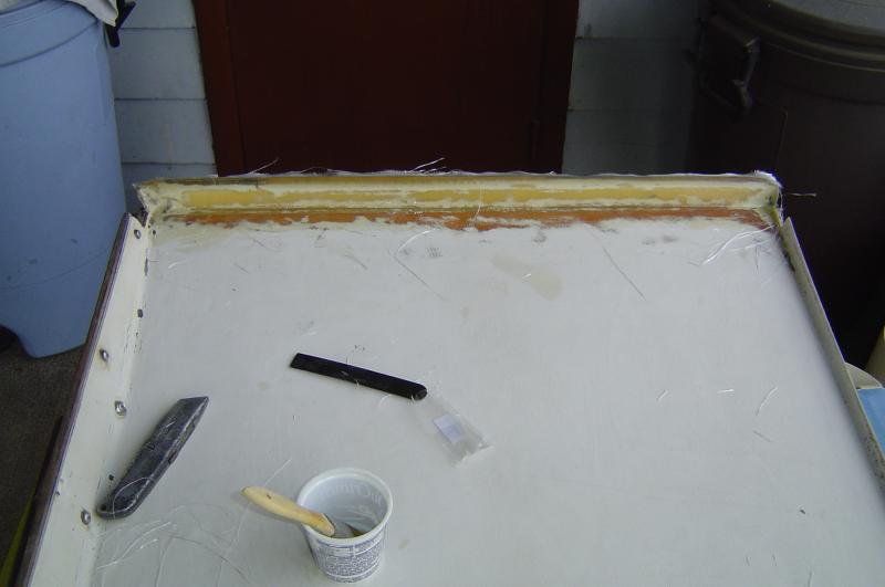

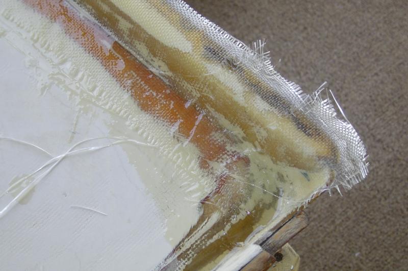

I used epoxy on the slides/flanges when I rebuilt them. Simply used blue painters tape (3M brand picked up a roll at one of the big box store the other day paid the 3M price but got some inferior blue POS tape, the big box store started with the letter L I look much more carefully from this point on) :evil:, anyway tape was used to build a dam to hold the first layer of epoxy.
Then built it up using mat to get the thickness desired. Once satisfied with the thickness, it was ground back to proper width then painted using epoxy paint.... this area is really hard to see so wasn't worried about using paint.. besides it was only 1/2" on the outside and the underside needed to be nicer anyway. :)
I also rebuilt the rails, they'll wear too. I used epoxy mixed with graphite then ran them through a table saw to get the proper grove. Makes for easy sliding of the hatch afterward.;)
