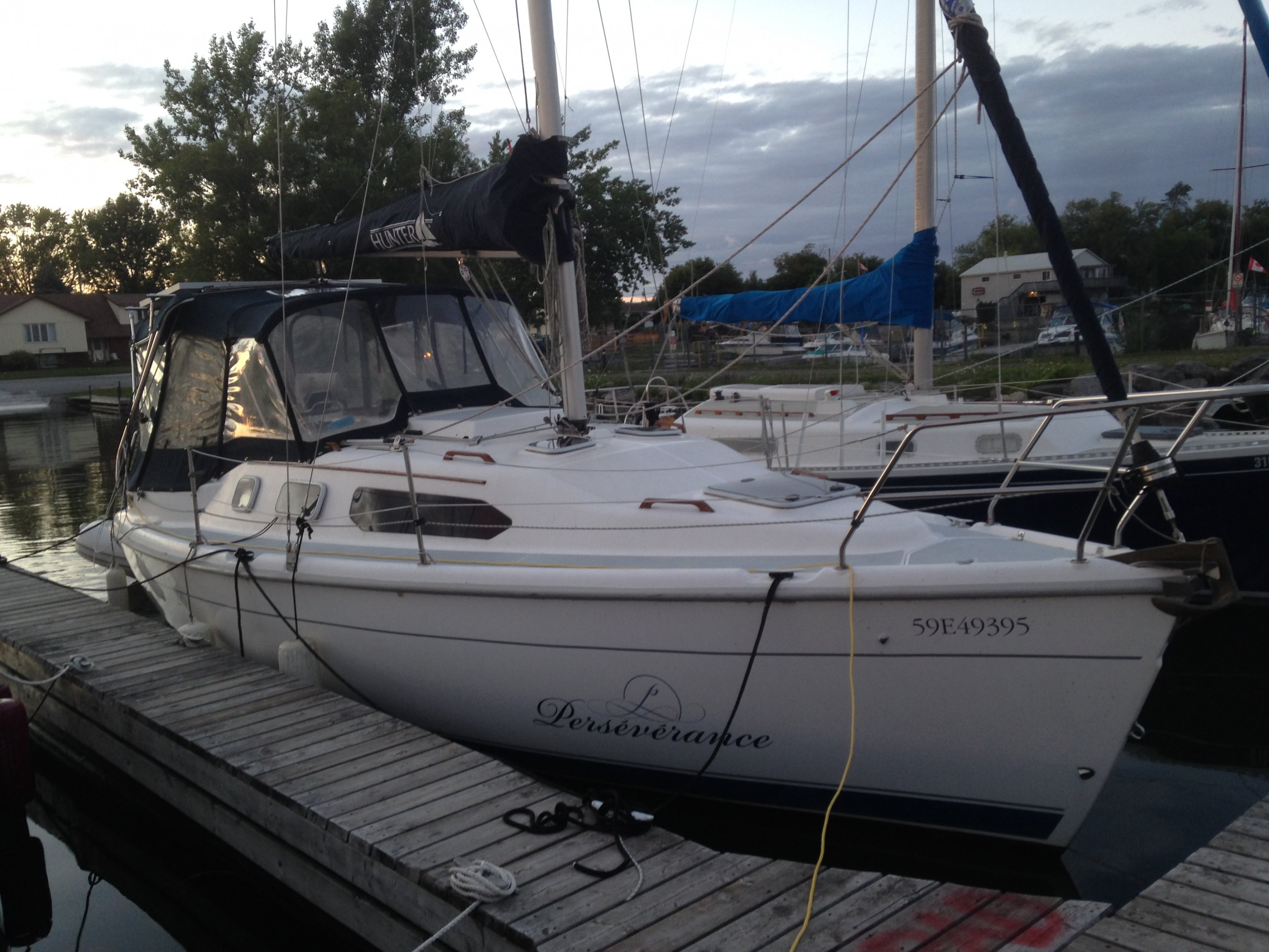

We have our jib tracks on the coach roof which allows nice tight sheeting angles for pointing, but when breezes are light and on the beam, the jib hooks really badly and seems to backwind the main. There is certainly no way to make a good slot and so I end up with the main not out far enough to really be well trimmed. For such a fat little boat, she does pretty well in light breezes on every other point of sail. Do I need to rig some kind of barber hauler or is there some other way to shape that jib?
I am really enjoying getting great trim now that I have all my rigging set properly and I would like to do as well as I can here too. A new sail will not likely be bought till we get a new boat!

You certainly have room to install a set of Genoa tracks to allow for wider sheeting angles. If jackdaw's suggestion, or clipping a block to a stanchion base to rig a barber hauler, proves beneficial you might consider the more permanent, and costly, solution.
