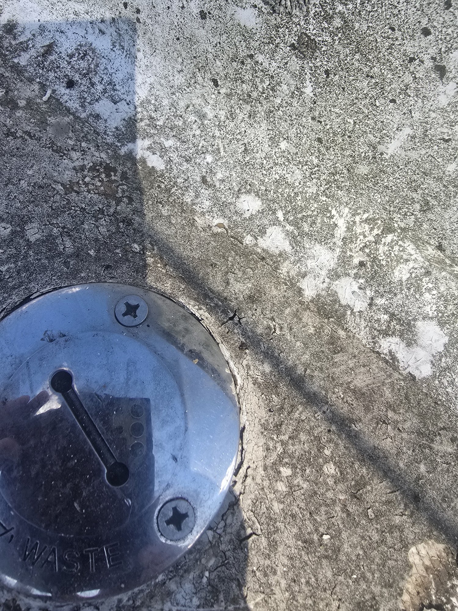

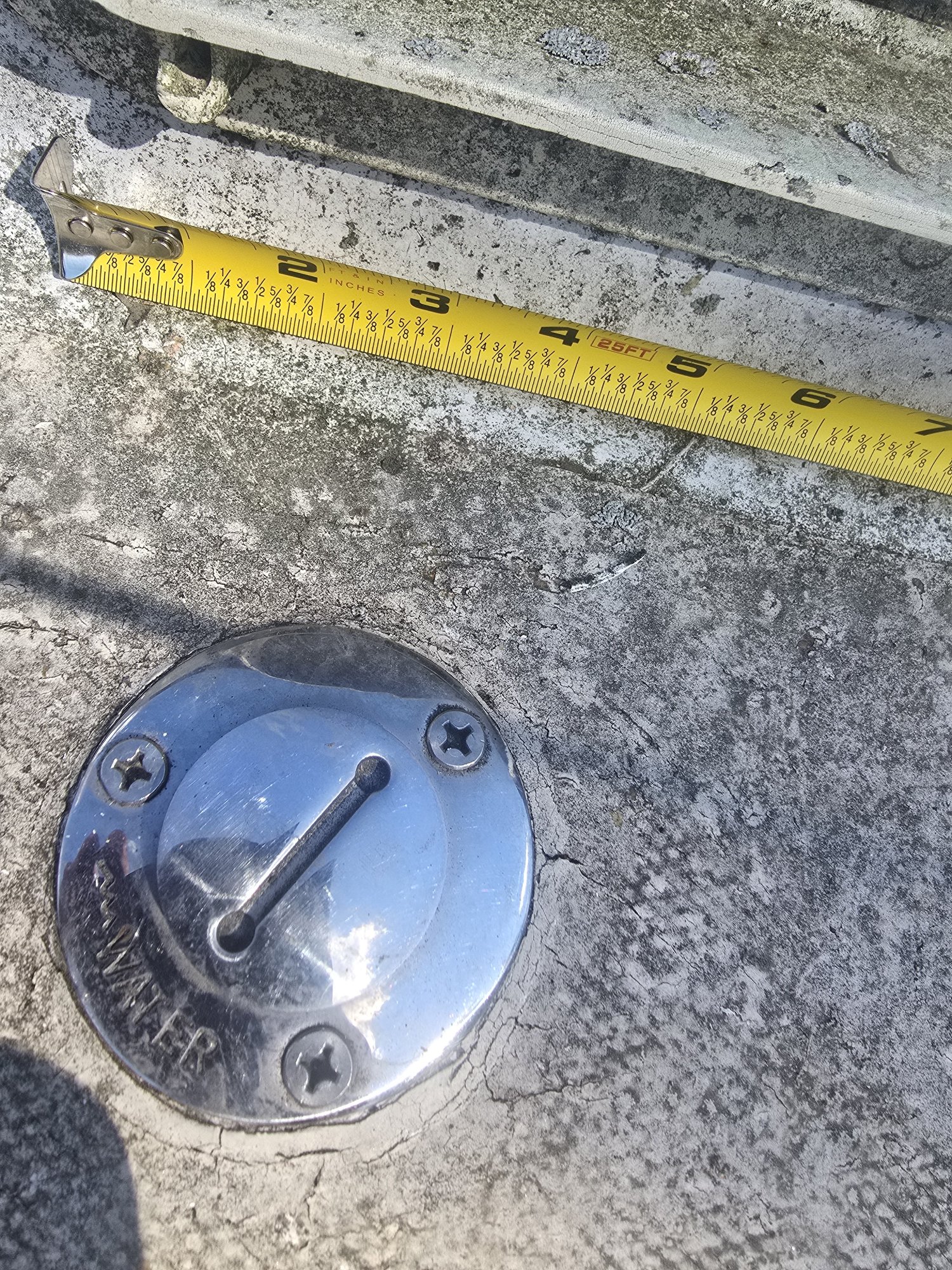

I'm sorry it's a 1970 23ft irwin. It has a head but not sure how it works. There are ports on the front starboard side for waste and fresh water.
Sep 28, 2025
18
Irwin 23ft Tamaroa
It needs alot of attention but we're willing. Need help with the head. Not sure how it works. It appears to be self contained but today I found 2 ports on starboard side one marked waste one marked water. Both stainless. So......

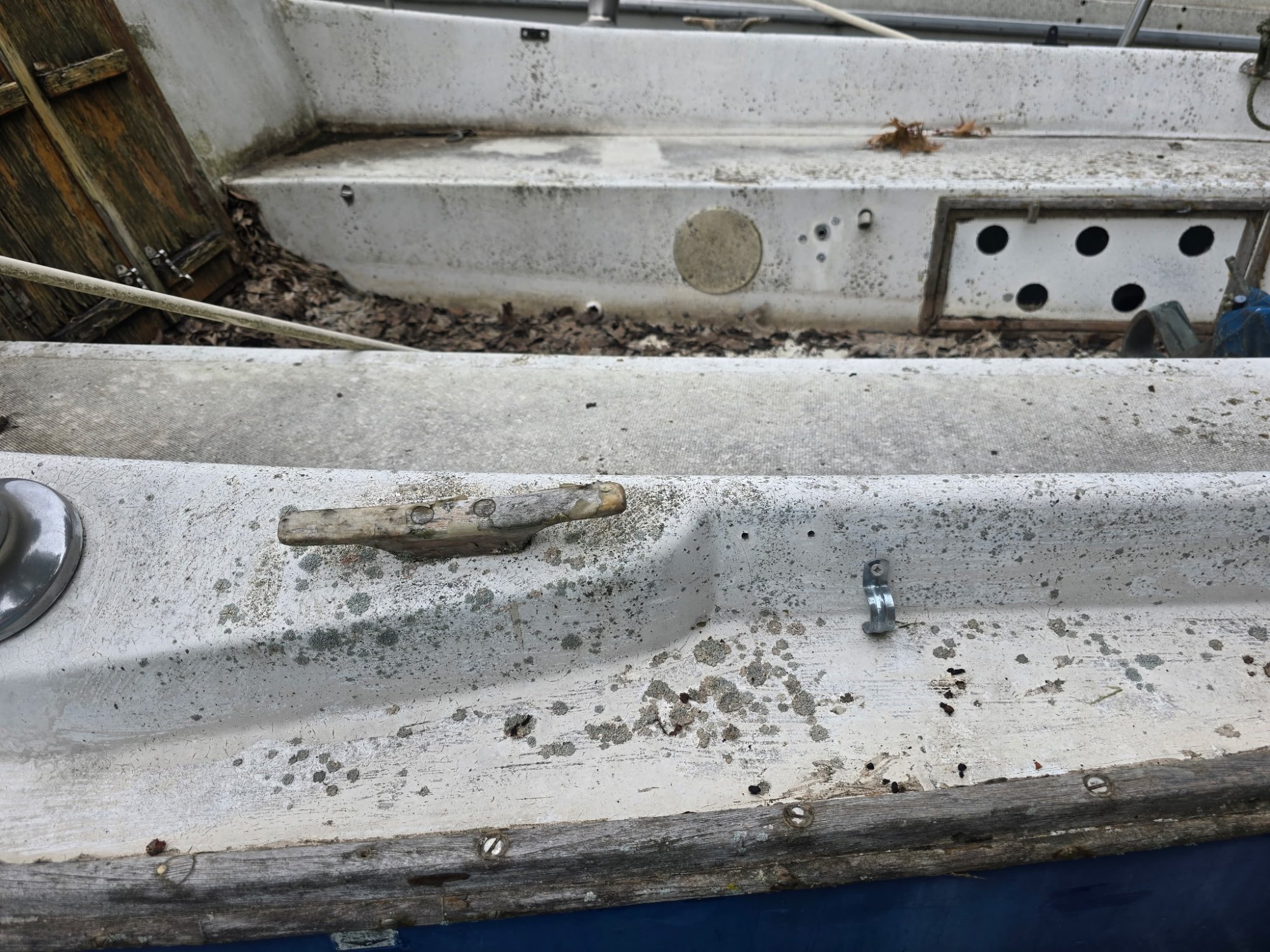

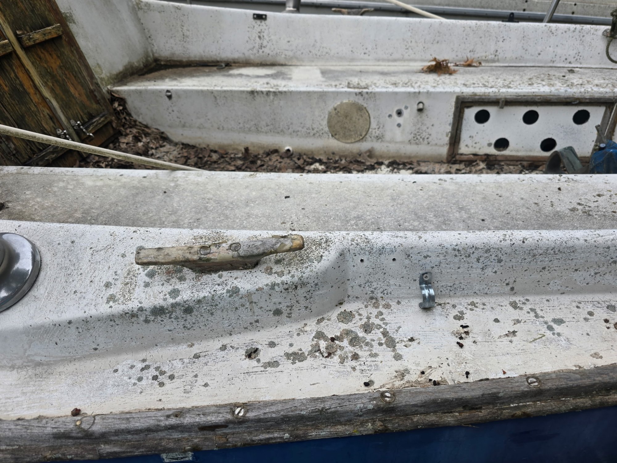

I think the "Water" port is to fill water tanks and not directly related to the head. The "Waste" port is for pump out - whether you have a holding tank or a self contained Marine Sanitation Device (MSD).
1970 was about the time holding tanks were required. It is possible your waste system is retro fit. We'll see what you have.

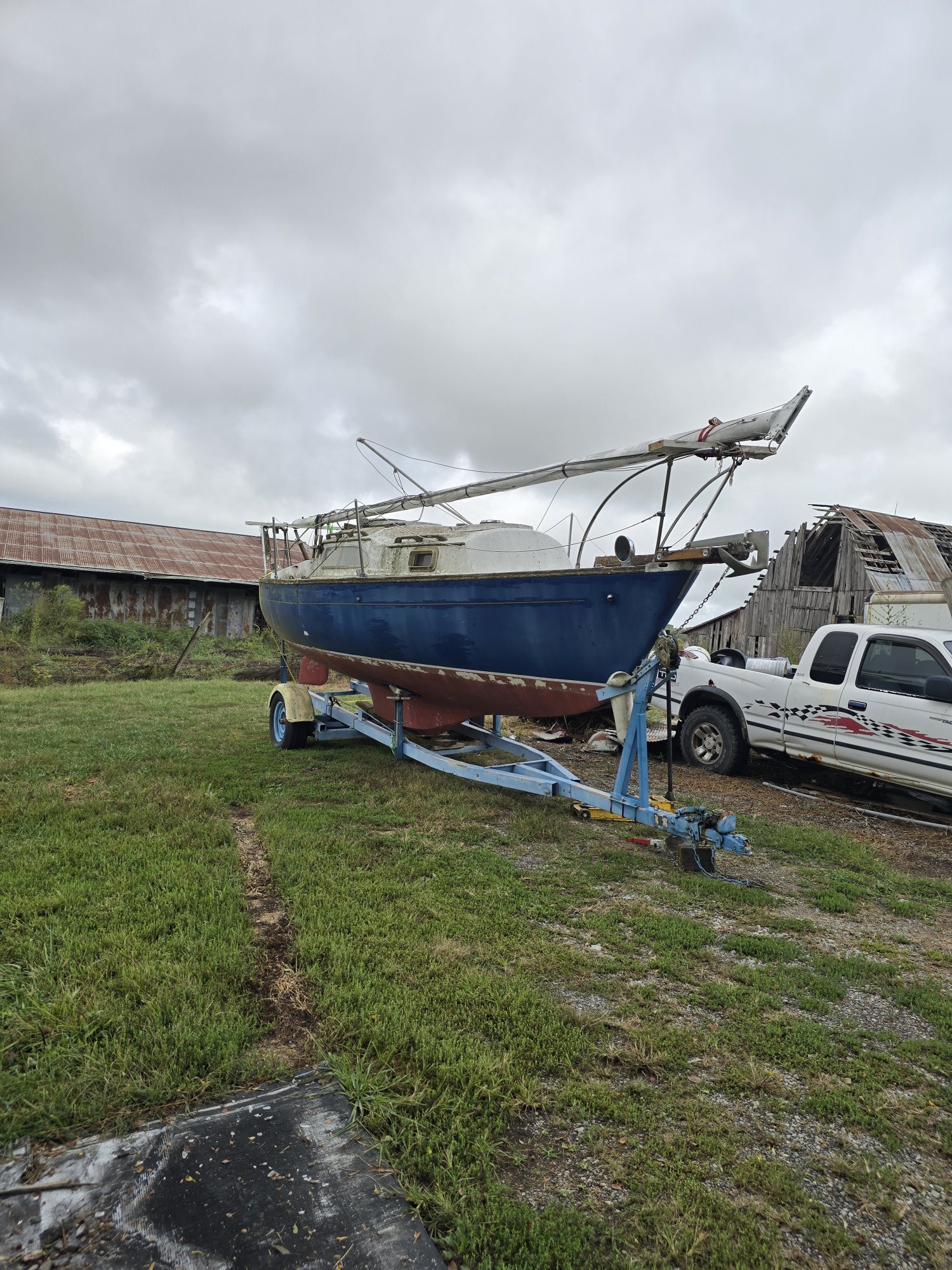

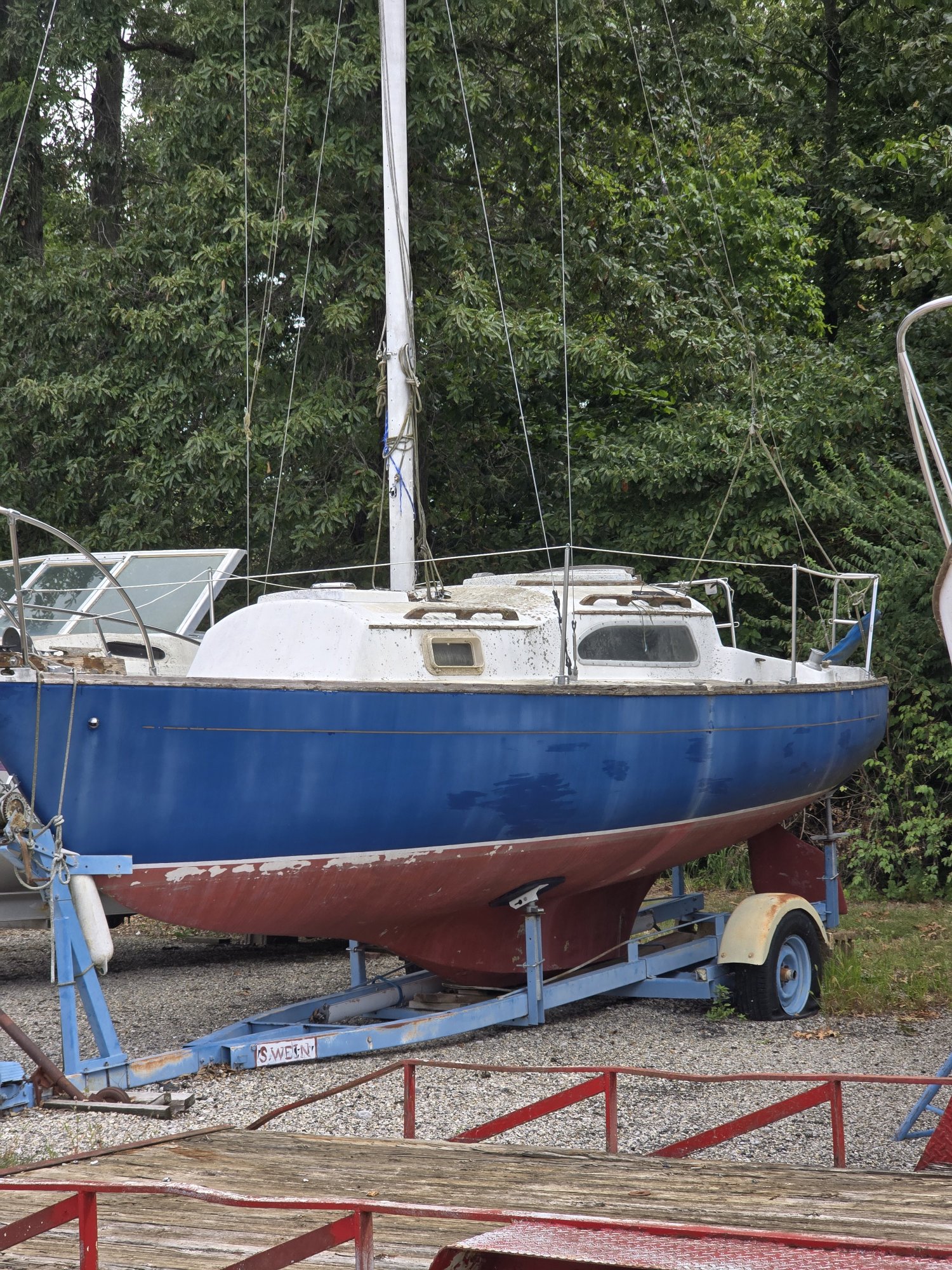

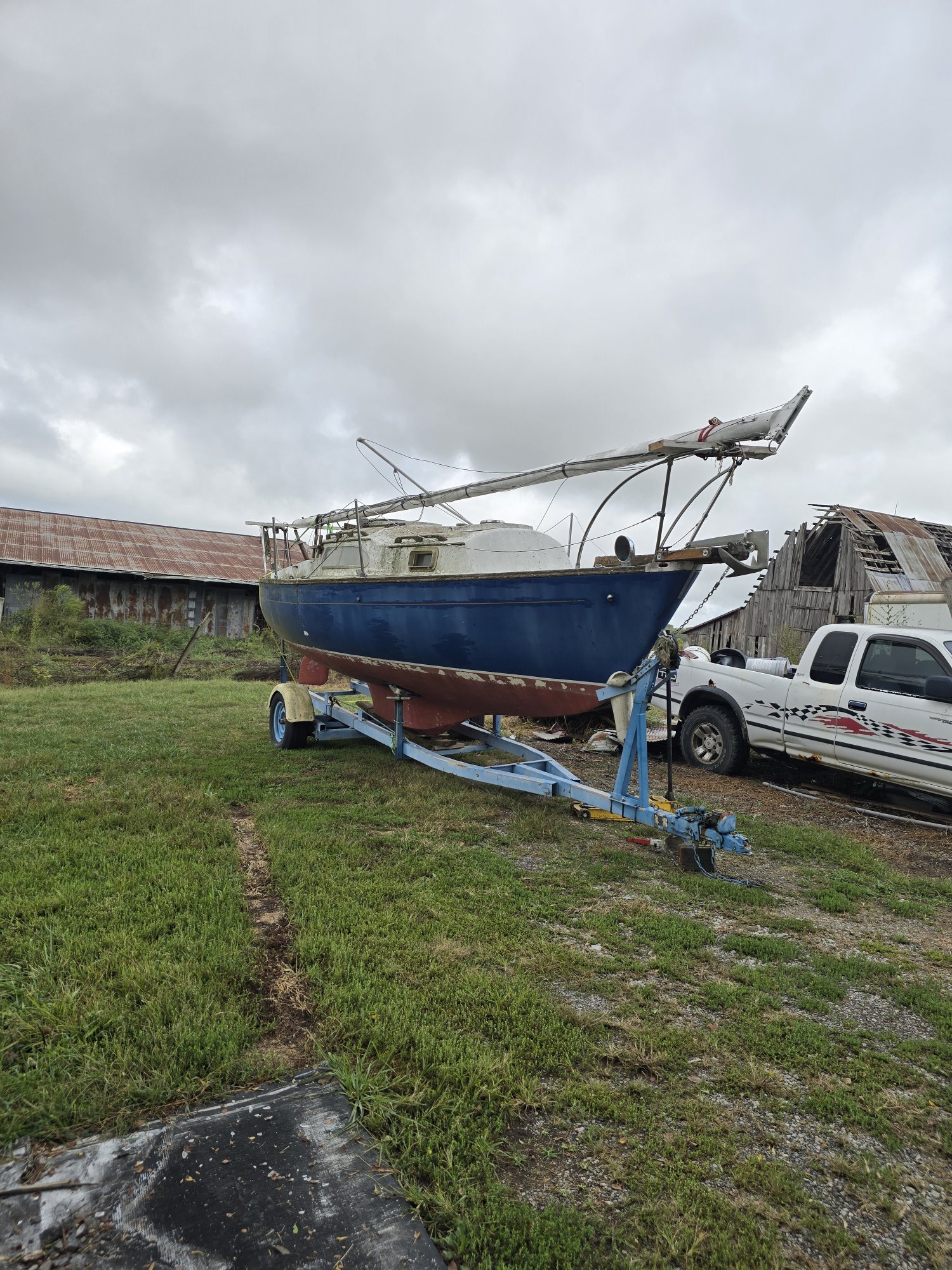

The bottom looks decent, at least on the port side. It needs some attention near the waterline but I don't think it's a full bottom job - good!
You're going to paint the top sides which has been painted before - don't bother trying to restore them. Please restore the cove stripe. It will make the lines of the boat more pleasing.
The deck will be problematic. Painting a deck is way more difficult than the topsides because of the non-skid areas. I would use the power washer and see what you get. The deck around those fittings looks pretty rough. The water fill needs re-bedding and the waste prolly does too.
Soft decks are maybe the biggest problem with boats like this. We haven't heard anything about the decks.

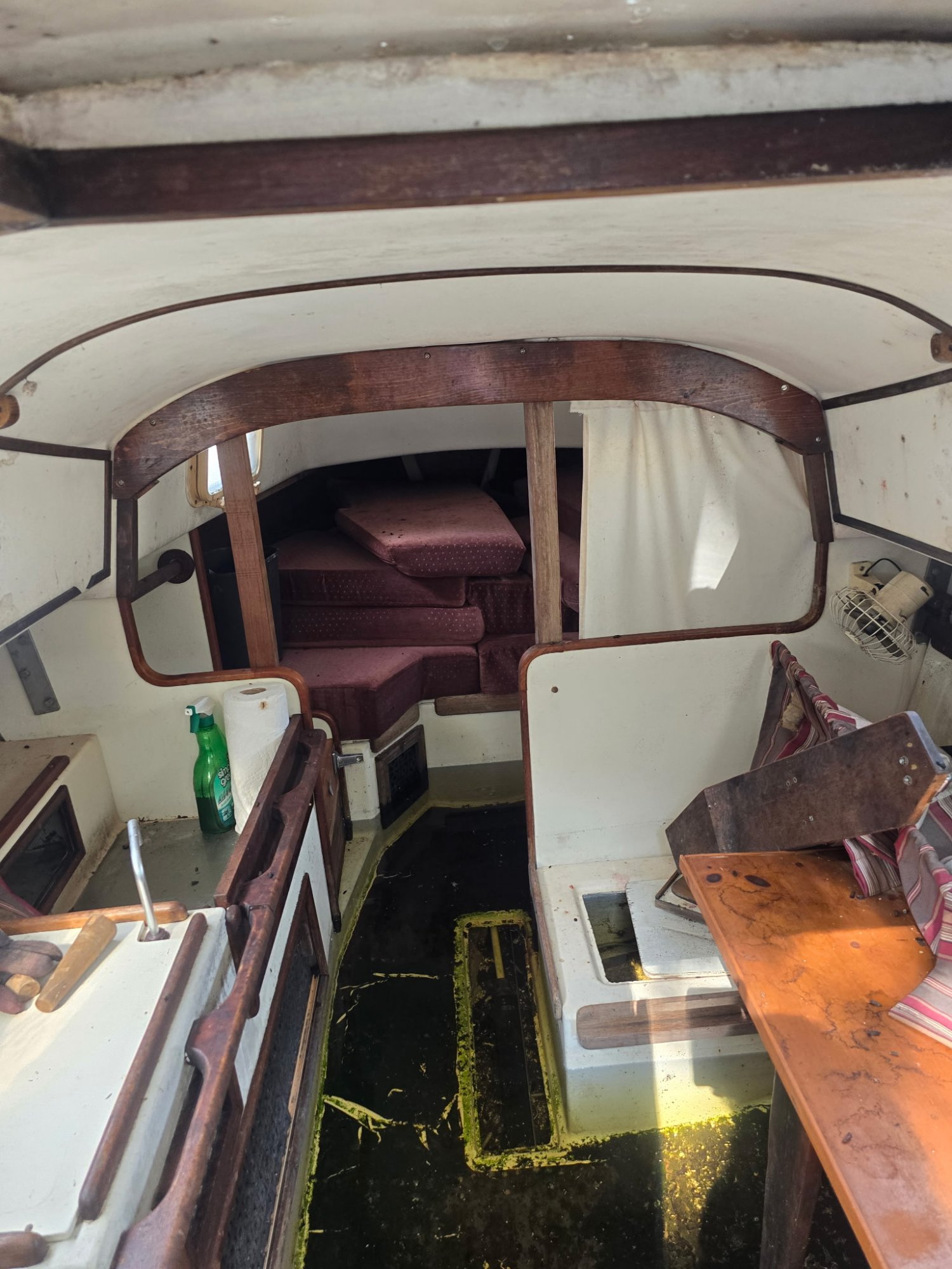

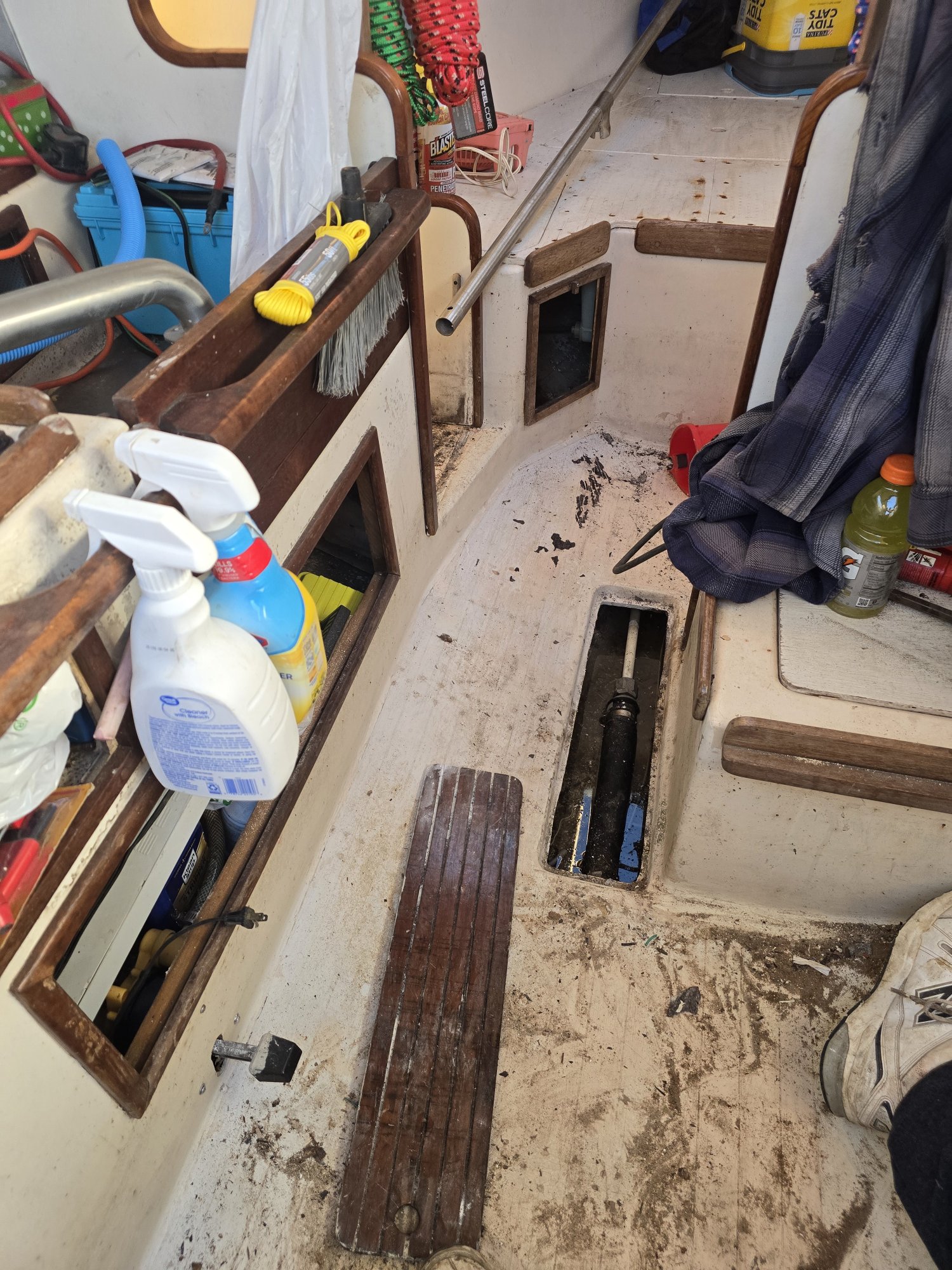

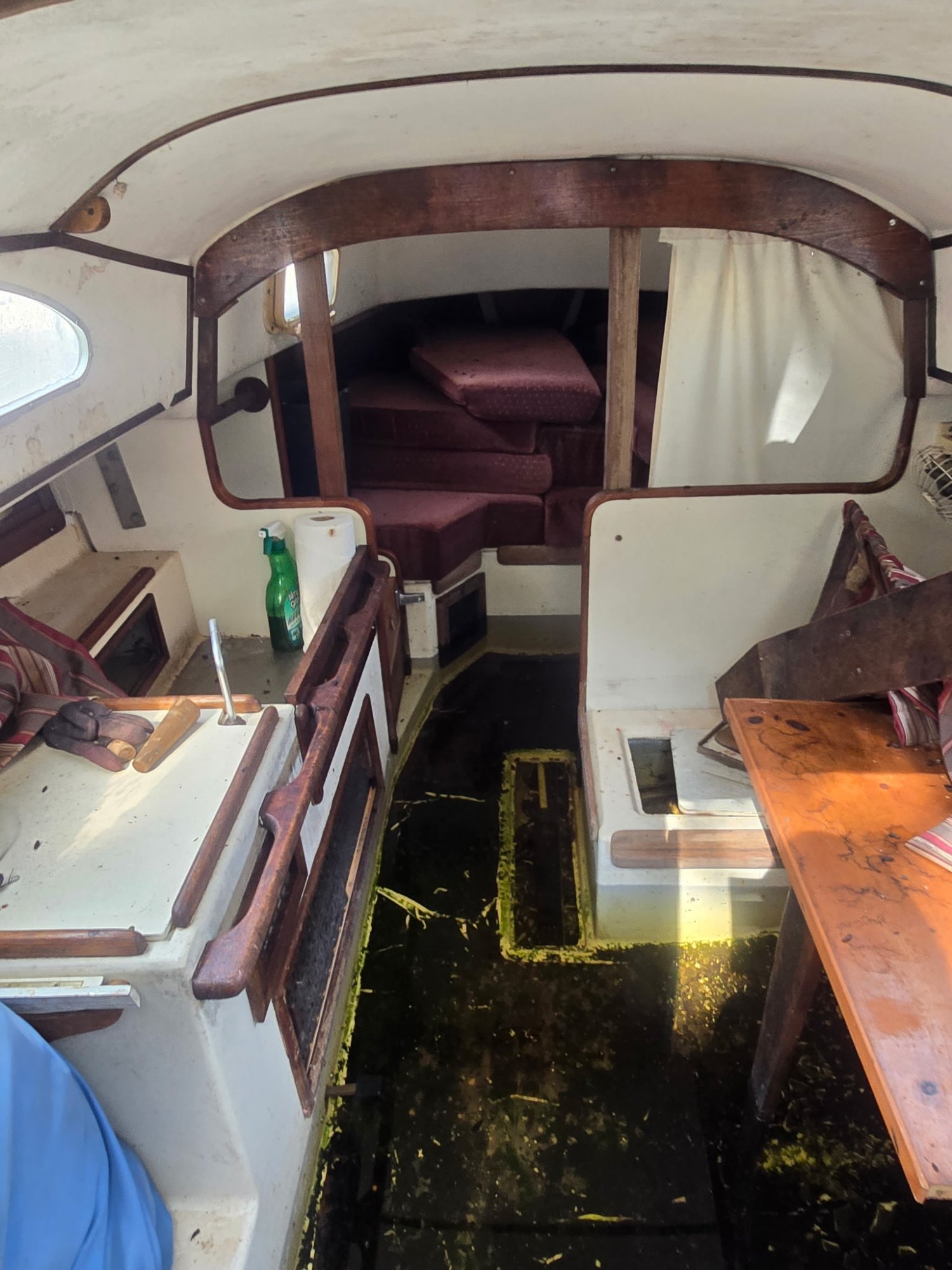

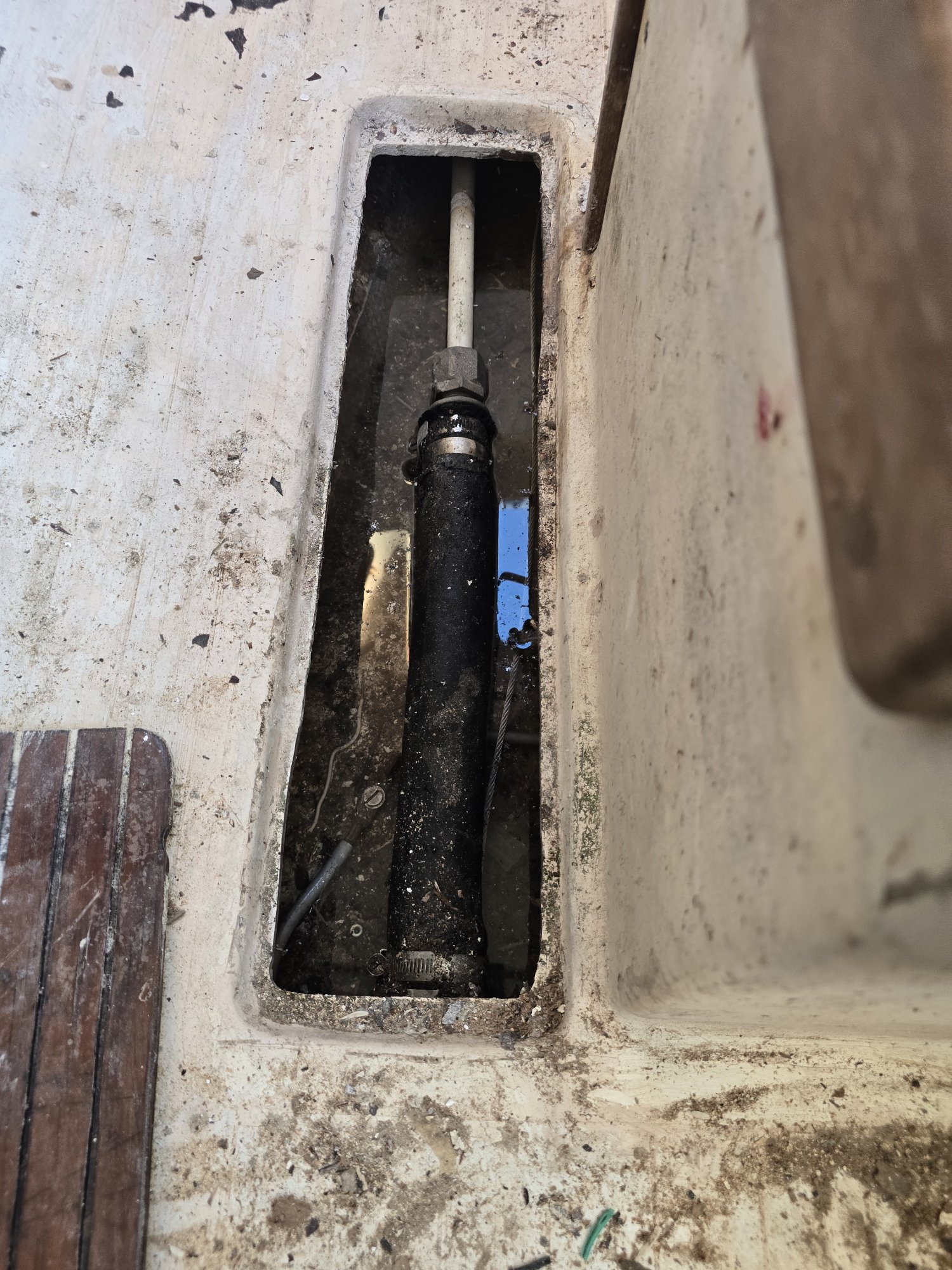

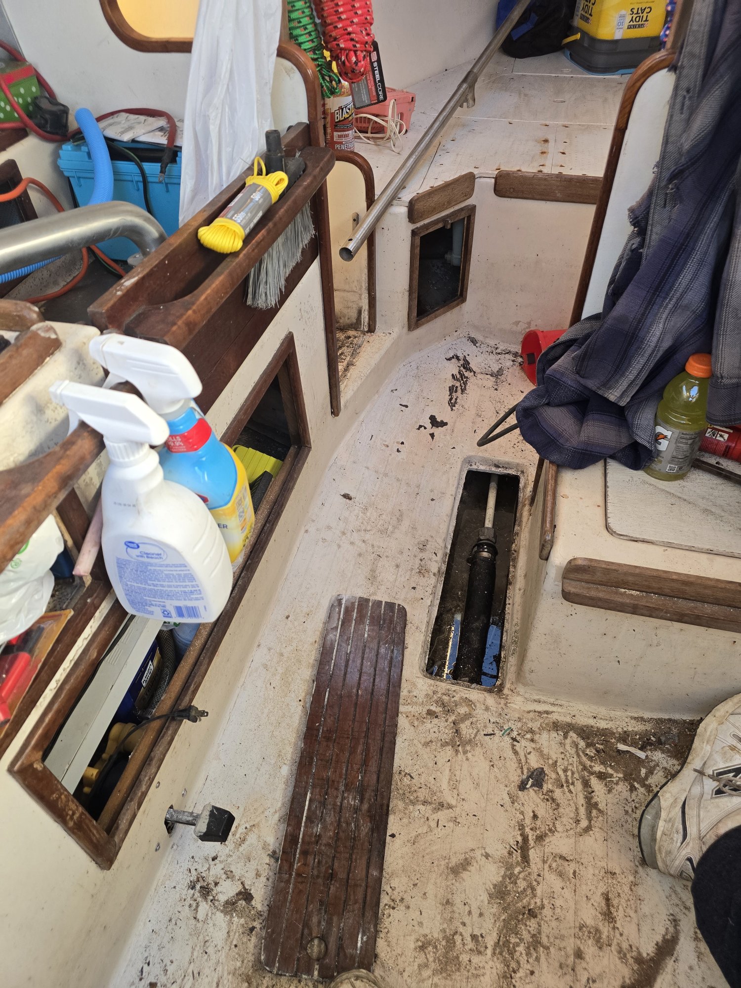

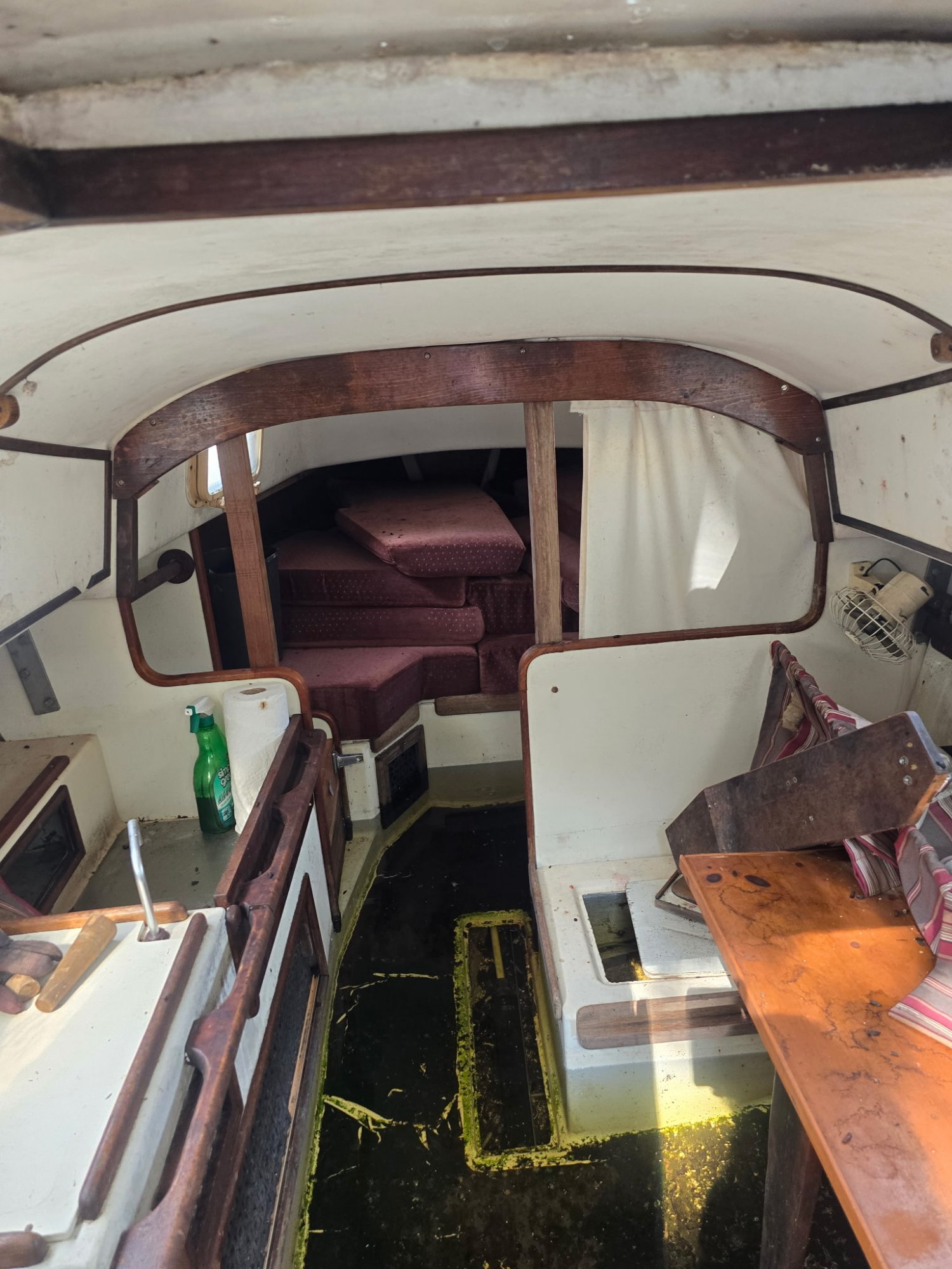

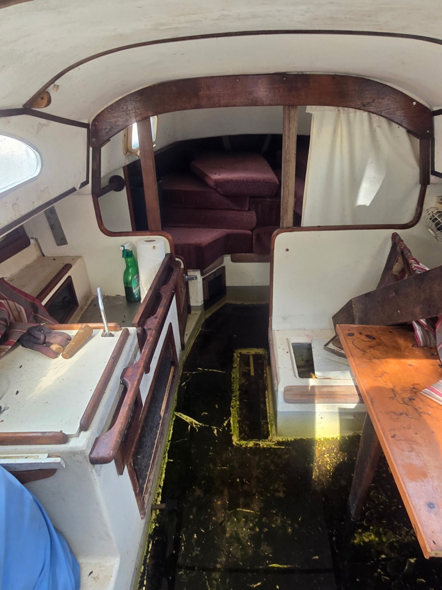

I really appreciate the feedback. I have a pipe/tube that runs the bottom and not sure where it starts or where it ends. Any help? It does have a cover but get alot of water in that area after a rain. What do I call it? See it in the center. This is a old pic I'll have to update that area in pics.

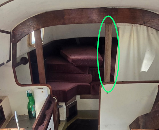

If this is what you are referring to, then that would be the compression post. For cleaning, I suggest the following: magic erasers (look on amazon for knock offs), acetone, and Spray Nine
7,742
I can't see a pipe in the pics.
The area with a cover is the bilge, I think. If you have leaks, which is likely, that is where the water should end up. But you need a way to dewater that area - an electric bilge pump, manual bilge pump or a portable pump. The simplest system is a manual pump (Diaphragm type) and a hose to somewhere that drains outside the boat. I'd be surprised if your boat didn't already have such a system.
The hose may drain a forward area like the chain locker or other dead space in the bow. Or maybe it's the hose for a manual bilge pump located outside the bilge. Look in the cockpit - they are not hard to find.

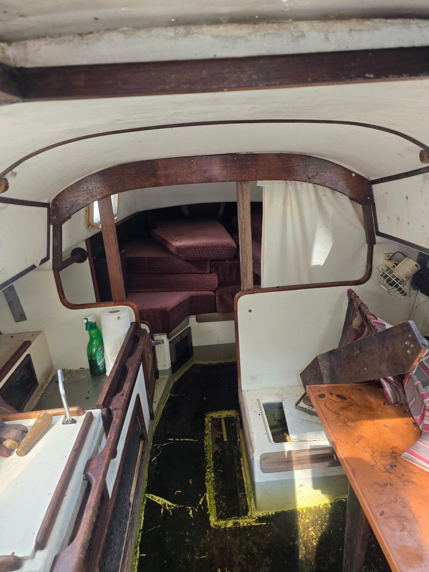

I like the layout of the interior. You'll have a nice pocket cruiser after it's fixing up.

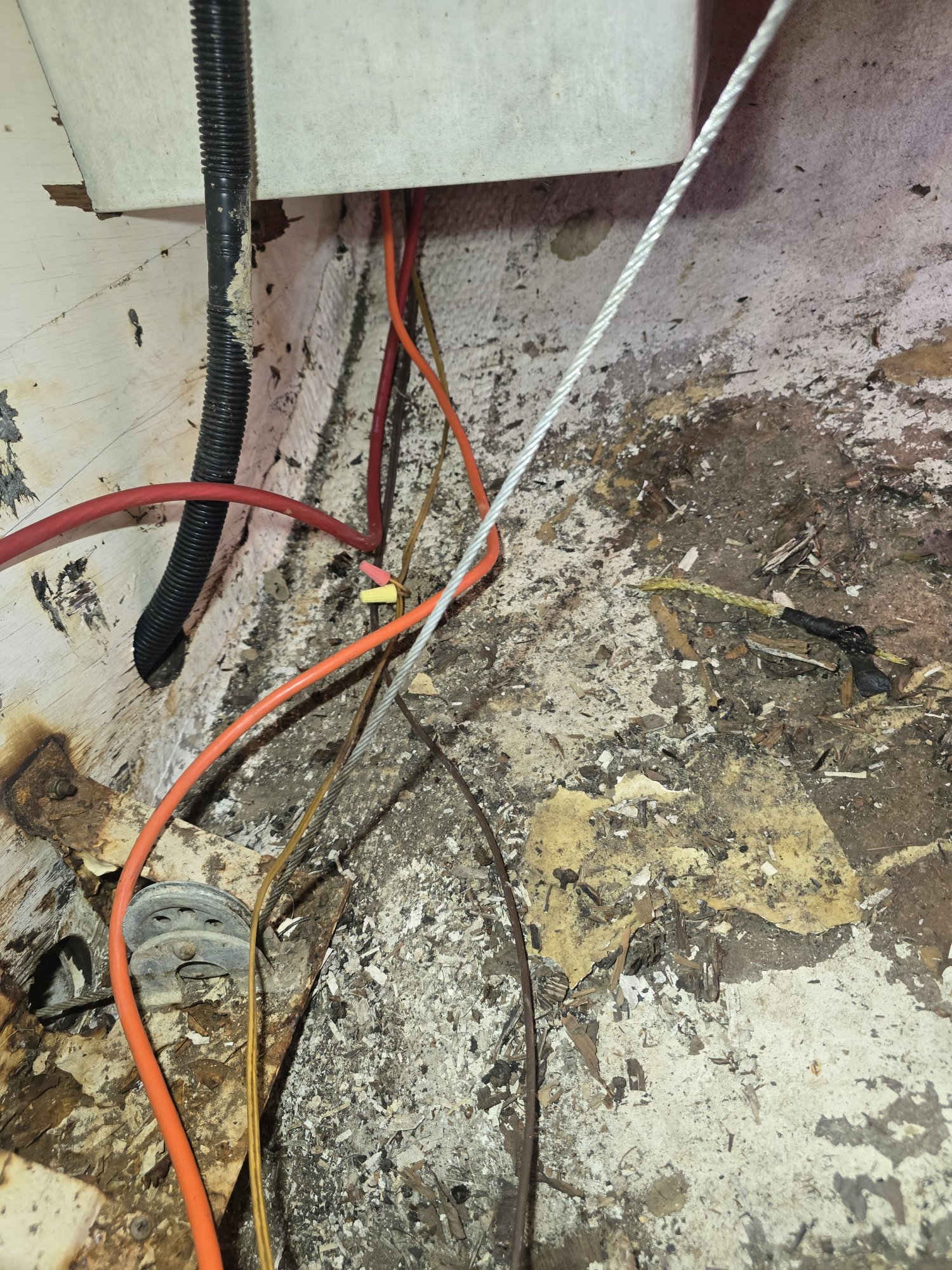

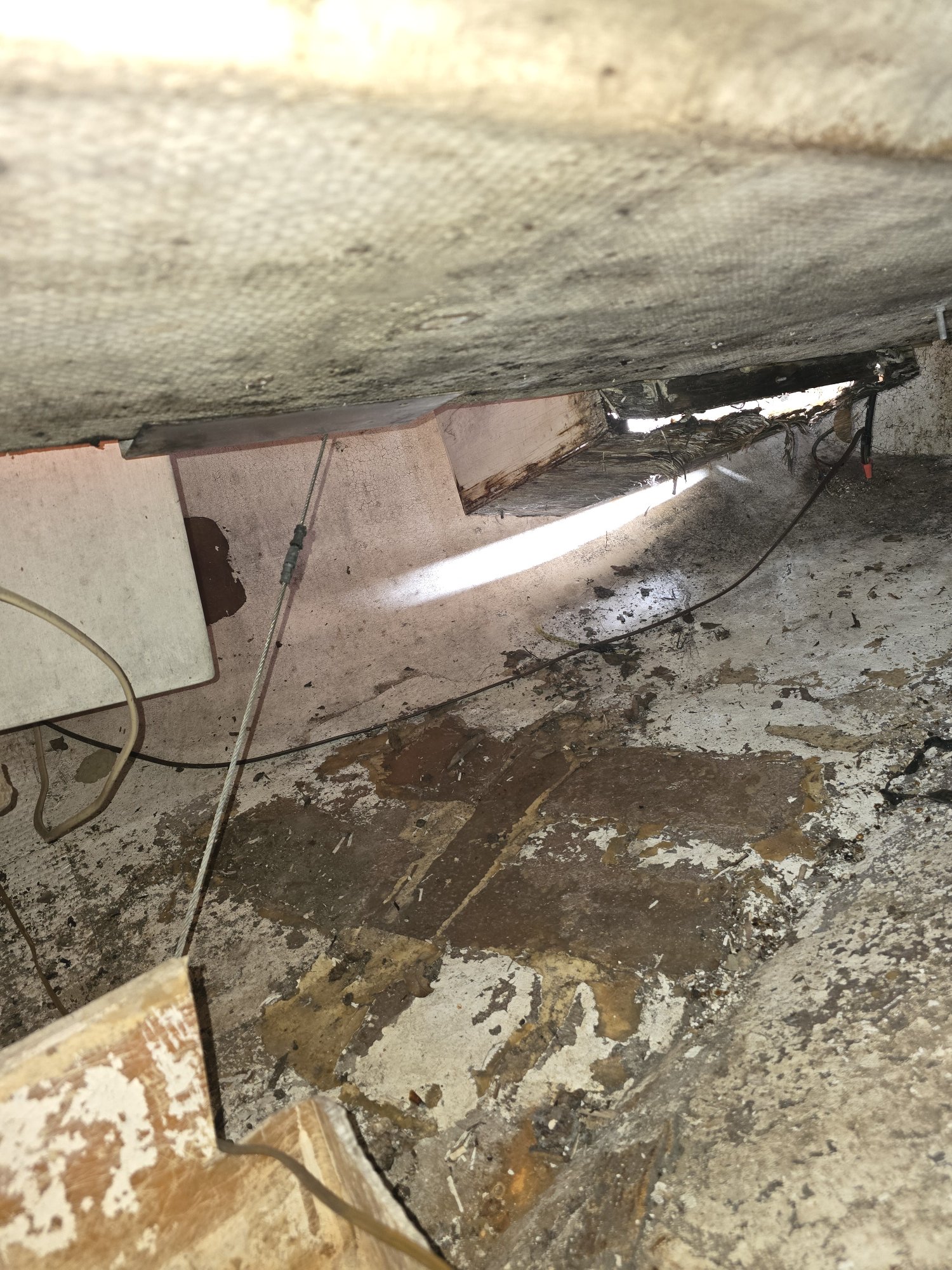

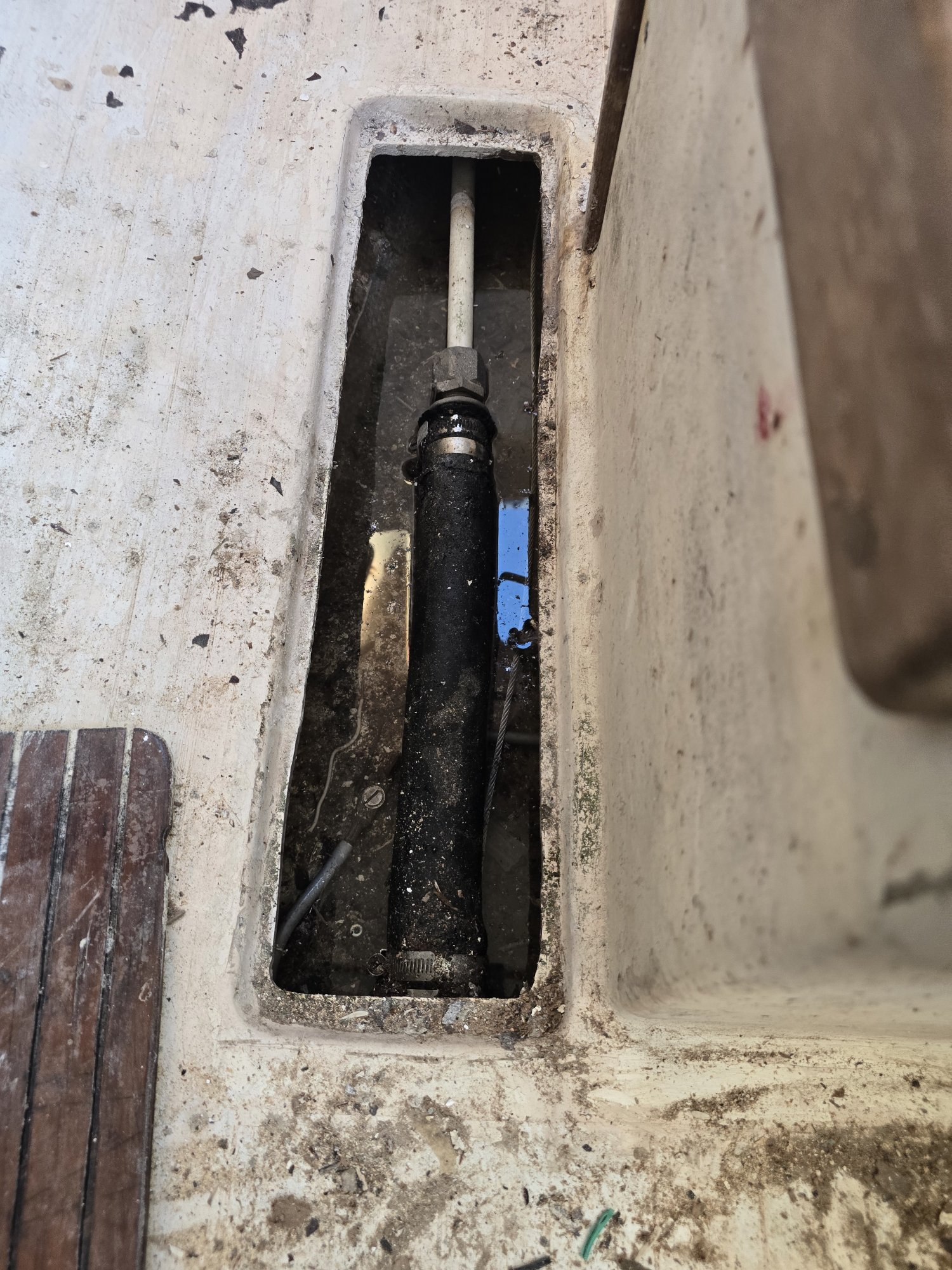

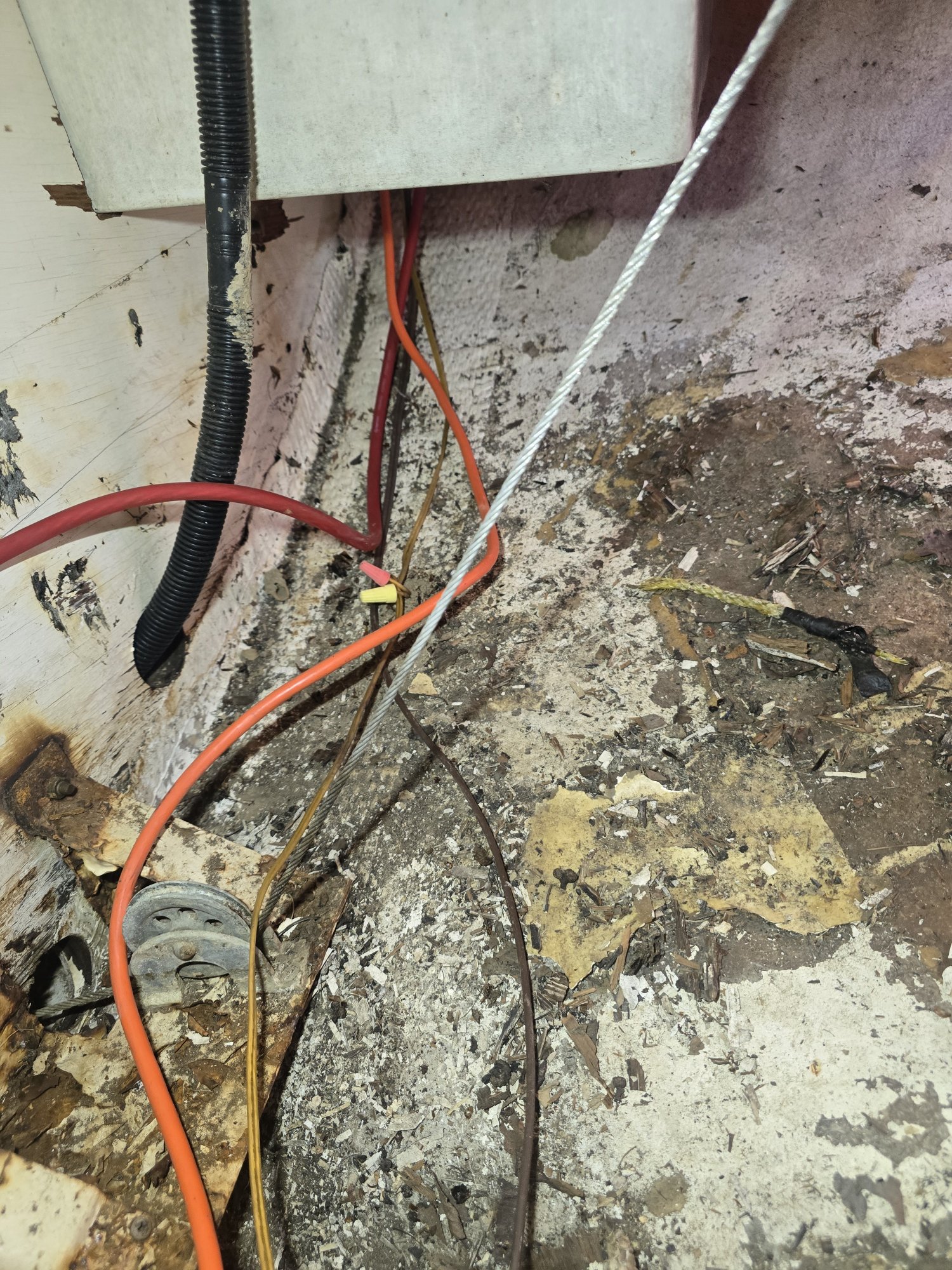

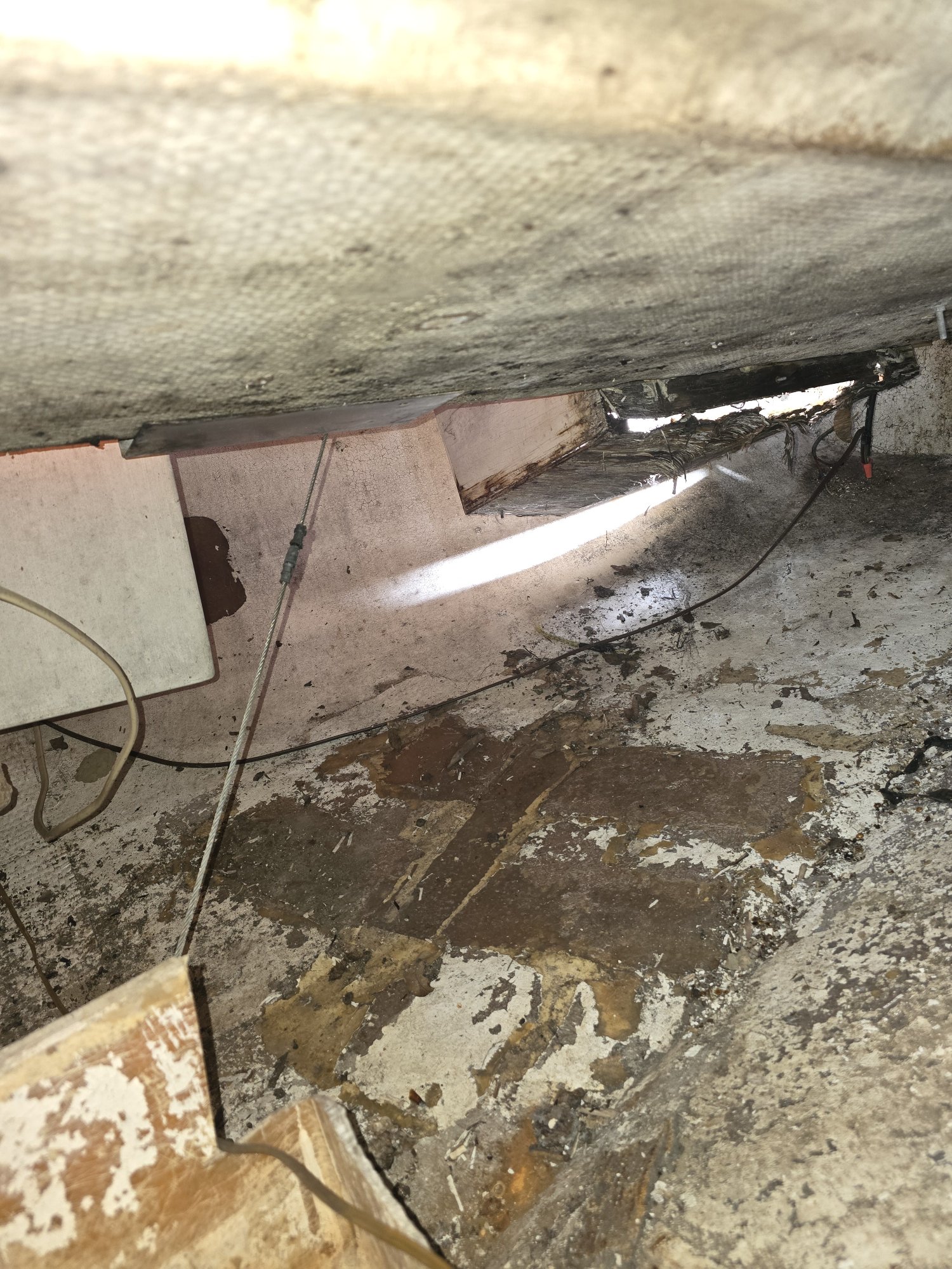

Need help with a cable that runs from the starboard side in the cockpit it's hooked to a side winch and goes forward but haven't found the end of it.somewhere forward. It runs right beside a tube/hose in the floor.first pic.in the floor the cable goes through to front somewhere. Second Pic cable comes from winch up top threw pulley to front. Last Pic is winch in side of cockpit. What is it and what is it for? Please help im going nuts......

I'm not seeing any evidence that the Irwin 23 ever had an inboard so I'm a bit stumped on what the shaft and stuffing box looking contraption really is

I as well.the cable in there runs through to a pulley in the belly/butt of the boat up to a winch on the starboard side in the cockpit. I haven't had it off the trailer yet but wounder if it has a swing keel is that possible? Thank yous for all your help i really appreciate it.

Yep. I just did some more research. It appears that Irwin used a stuffing box and delrin rod to raise and lower the centerboard. The cable is likely part of this system as well
