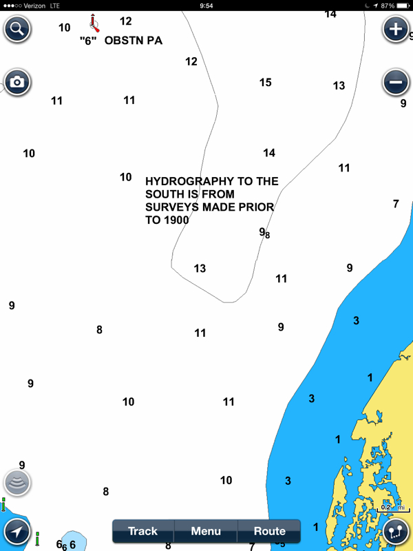

Many people feel the iPad is expensive, and they opt for a less expensive tablet that runs the Android operating system. I hear some folks have good results. I don't use Android devices, so I can't help. But what I can tell you is that you often get what you pay for…
I have been happy with my Apple iPhones and iPads through 4 different models now. I generally use my iPhone to provide GPS speed and direction on the boat. I would like to use an iPad Mini with cellular, but I honestly don't have the need for a chart plotter where I sail, so the iPhone showing me speed readouts is good enough. If I were to sail coastal areas like Barnegat Bay in NJ or the Upper Chesapeake, I would break down and buy a GPS adaptor for my iPad wi-fi only, or maybe a new iPad Mini...
