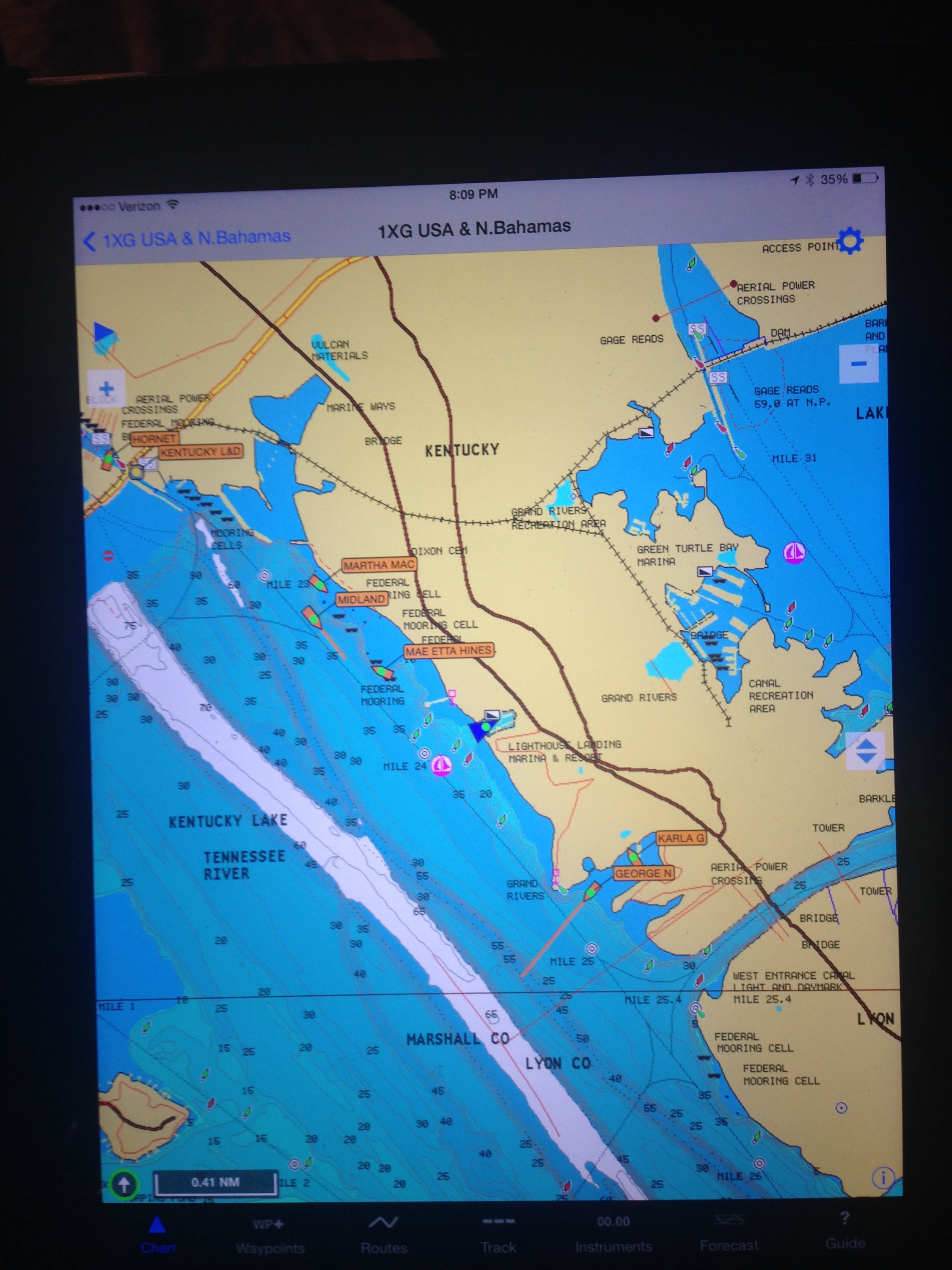

My favorite is INavX (top photo at Ky Lake). I get AIS from my Digital Yacht IAIS (wifi) for both class A and B and it is real time. You purchase charts and also get the ability to store routes and tracks on their website. That allows syncing with an IPhone and if you use MacENC on a Mac then you can also integrate all three.

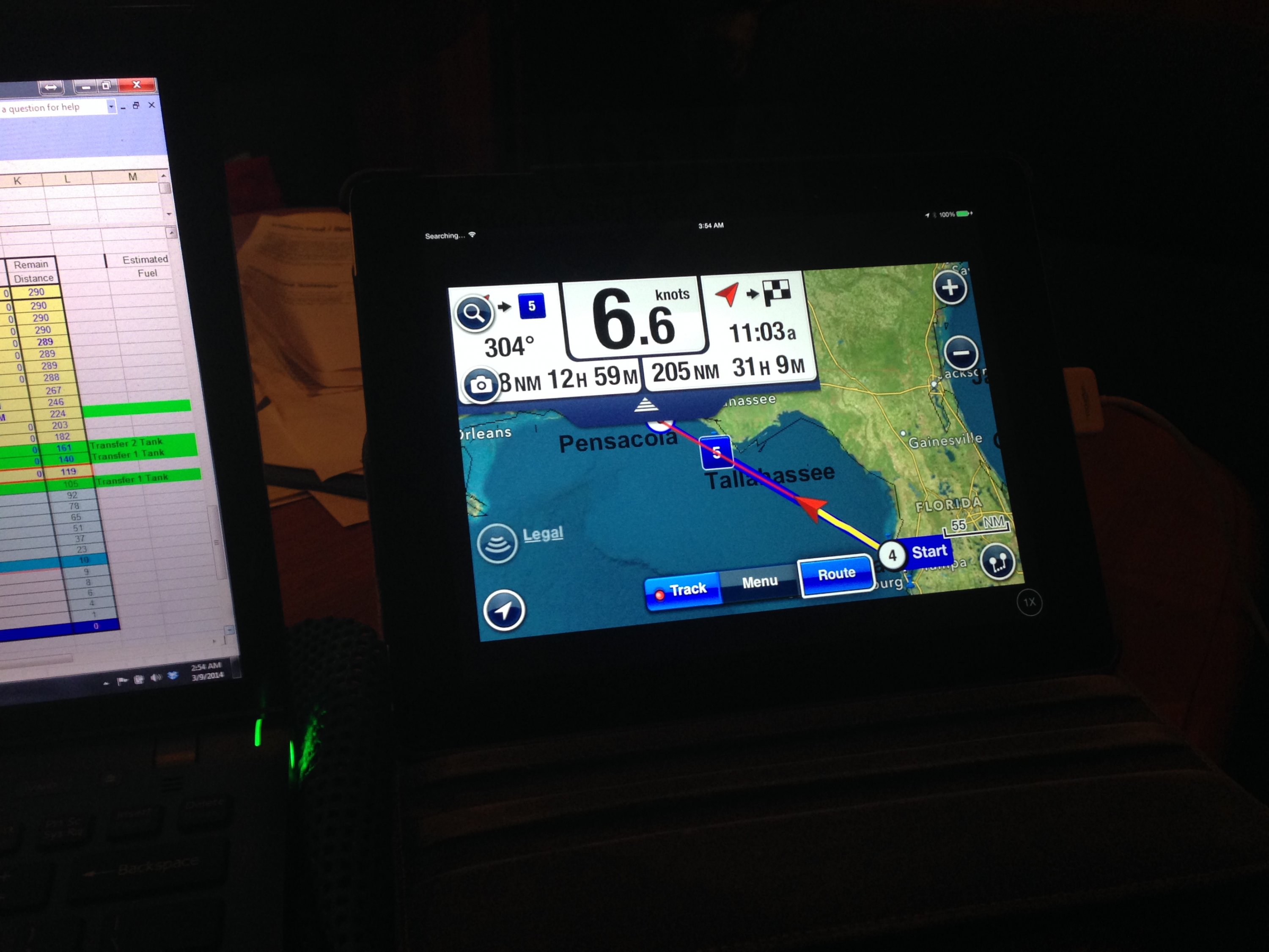

I also like Navionics (bottom photo crossing Gulf), but there is no AIS on Navionics. Both use Navionics charts. INavX also has weather integration for $25 per year and you can download grib files that display in the app over several days including wave heights, wind, precip, etc. I like that feature and use it in conjunction with Sailflow to get a good comprehensive picture of weather.
Some AIS units can also be hooked into boat instruments thru wifi and can display wind, etc. on INavX. The GPS built into the IPad gives you basic speed, ETA to waypoint and route destination, etc.
