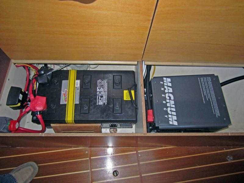

Here's how I installed an 8D battery & 2000w. Inverter in the port settee of my 326. A spare Optima blue top was placed in the starboard side, next to the fresh water pump as an isolated engine starter battery.
