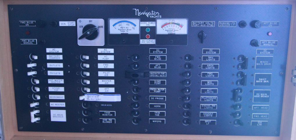

Ok, so... After my full DC system upgrade (and y'all were a huge help... thanks), we have taken the boat out to anchor a few times and realized we could probably use a small inverter to power a couple of fans in the bedroom while we sleep and the TV/Roku. Maybe give us a few other conveniences too like coffee in the morning. Nothing major like a microwave though. For that, we will fire up the genny.
I am thinking of getting a Victron Phoenix 800-1000 watts and even that might be a little larger than I need. My panel has two breakers that I assume are 20A that power all the 120V outlets throughout the boat (there are 10 outlets total). My question is: How do I energize just those two breakers with an inverter-only unit? Will there need to be a sub panel of some kind with wires to the current breakers? Or this less appealing way... Do I need to energize the entire 120V side of the bar and turn off the breakers/systems I don't want?
Below is a picture of my panel for no particular reason. :) The outlet breakers are at the top of the far left column.
Thanks y'all!
Respectfully, I think you're looking to re-invent a wheel that doesn't need to be re-invented.
What you need is a combined charger / inverter, and I recommend magnum.
Yes, it means replacing your existing charger., but that's life.
It's one box, wires in clean , safe & you're done. Why mess around????

I don't disagree. That is why I backed off of most of my idea.
Replacing the charger isn't out of the question in the future, but I like the Sterling charger and it is less than a year old. I waste enough money with this lifestyle choice, that I don't want to waste it by backtracking my own work :)
