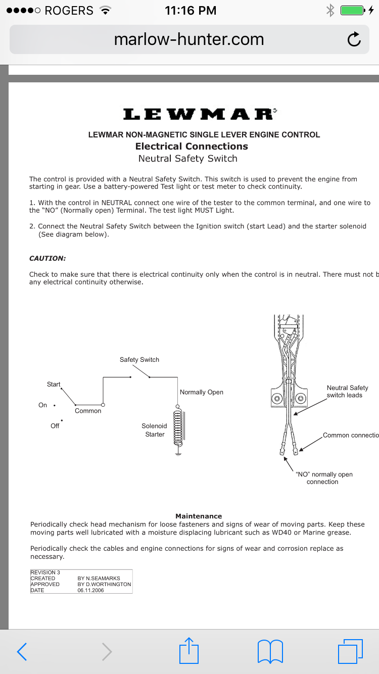

I had the same issue as many others have & have added a relay down close to the starter & has cured the issue & yes there are many posts about this issueI have a Vision 36 with the Yanmar 3jh2e. When I turn the key, she starts 90% of the time on the 1st try, but sometimes it takes a few (or more) turns of the key til she starts. There is no sound (other than screaming alarm), clicking, cranking, etc. when I turn the key until she just starts. Recently it took 6-8 turns of the key.
Loose wiring? Corrosion on wires? Starter going bad? Starter solenoid beginning to fail? All of the above???? Nut behind the wheel?
I took off the instrument panel and saw that there were no loose wires or corrosion. I am looking for the simple (obvious??) items to look for first before I start replacing parts.

You'll solve this by installing a relay. No question about it. Just do it, and your problem will disappear. It will be sort of anticlimactic.I have a Vision 36 with the Yanmar 3jh2e. When I turn the key, she starts 90% of the time on the 1st try, but sometimes it takes a few (or more) turns of the key til she starts. There is no sound (other than screaming alarm), clicking, cranking, etc. when I turn the key until she just starts. Recently it took 6-8 turns of the key.
