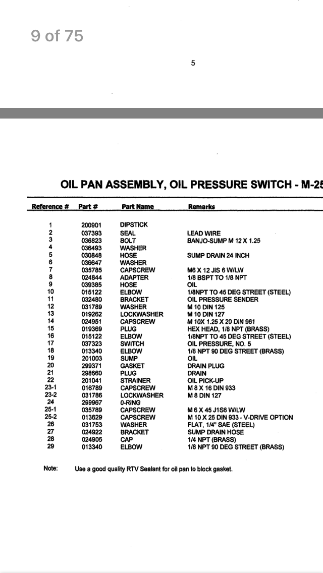

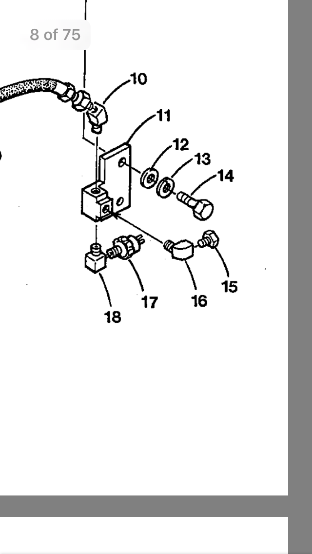

Recently began hearing the low oil pressure warning alarm. This is occurring at 2000 rpm intermittently and shuts off when I back down to 1500 rpms. Started shortly after my oil change done less than 10 engine hours ago. Universal m25xpb...help!
