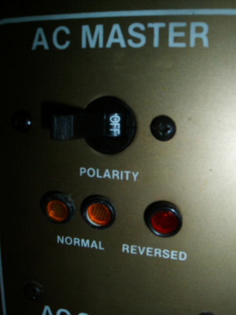

Your alternator (I guess I should say MY) will NOT power the battery with polarity switch in the wrong position. I checked this with my marina mechanic and a v.meter. The alternator was not sending power to the batteries with the switch in the shore power mode protecting the alternator, thus, no charging when not plugged in, and after a couple days motoring and on the hook, the batteries were not charged.
On the Catalina 30 I could not get the alternator bolt out ( was gonna replace it ), I would have had to drill a hole in the fiberglass seat area to get it out with out pulling the motor. Flipped the switch and they were getting plenty of power.
Dean
ps. not trying to argue with the experts (stu) but this is what we found.

Dean, yes, I understand, and, in spite of Ron, I am not arguing either. In this case, you have something VERY strange going on on your boat, because as we previously discussed (not argued:)) the polarity switch is for alternating current and the alternator is producing direct current.
Now that you've had a mechanic and/or tech to agree with you, I would be very curious to see a wiring diagram of your setup.
Here's my guess: the polarity is/was mis-wired into the alternator circuit. If you look at the C30 wiring diagrams, so kindly linked in another topic by Bob S (http://www.catalina30.com/TechLib/PartsManual/C30 Parts Manual.htm) it includes the electrical system. There is nowhere shown a connection between the alternator DC system and the reverse polarity AC. Actually there's not much there at all. If you check any other Catalina manual's electrical system diagrams, they are separate. Try ours: http://www.c34.org/manuals/1988/1988-C34-Owners.pdf Page 33 of the PDF file has the AC system.
Here's another guess: perhaps, Dean, I may be misunderstanding, but the ONLY thing on the electrical panel remotely close to anything called polarity is the "reverse polarity" indicator. Perhaps one of us is "mis-naming' or "mis-identifying" something here.
Extension of last guess: Could you be calling the 1-2-B switch the "polarity" switch? Since most boats come from the factory with the alternator output (AO) going to the C (B) post of the 1-2-B switch, my guess is that's what is happening. That's NOT unusual. I haven't heard anyone ever call the 1-2-B switch a polarity switch before. It is not a polarity switch, it simply chooses the battery bank for use (and for charging if so wired).
Last guess: your PO rewired something and used a switch on the panel for something pretty odd. Many people don't understand reverse polarity and it wouldn't be unusual for someone to disengage it and use the switch.
We do not have a switch on our panel for RP, there are three lights (the switch above is the AC main breaker). The newer boats may have a push to test button or momentary switch.
Dean, I'd love to learn more about what it is you have and hope to clear up this unusual condition. Perhaps a picture of your panel showing the "polarity" switch you mention would be a good start.

I'm with Stu on this one. Something is wired or labeled wrong, and shouldn't work in the way you describe. I was in the bowels of a C30 yesterday doing work for a friend (since I'm retired). Ye gads, how the plumbing has been bastardized over the years :eek: . Your electric may have had the same mechanic?
