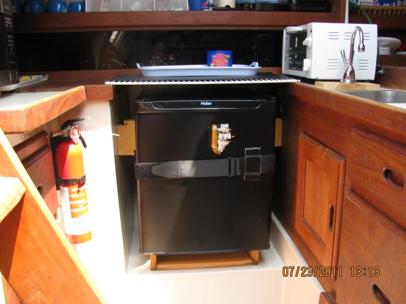

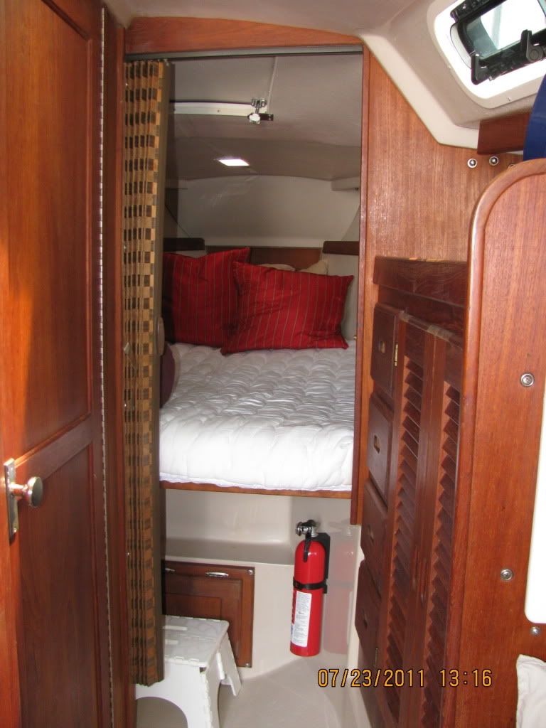

I don't think the PO did anything to it, does this look like oiled teak?
I really like the look of it now, and most of it looks nice there are just some areas that look a little tired. Any recommendations on a product to use?
Thanks a lot
Joe
23,165
I think it looks fine, just a little dry.
Get some teak oil at WM and soak a rag and go for it.
Nice looking boat.
