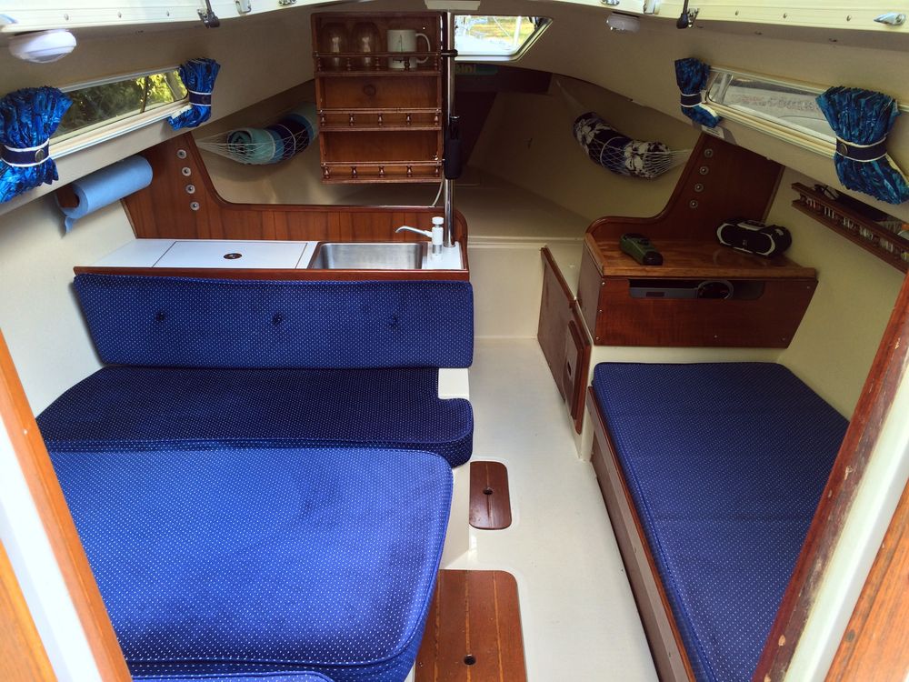

If I hadn't failed wood shop I would attempt to make a nice wood cover for my stove like that. The additional counter space is much needed. I tried finding a cabinet that would work above the sink after seeing yours but haven't been successful. No way could I make something nice like that from scratch lol. Marry me
