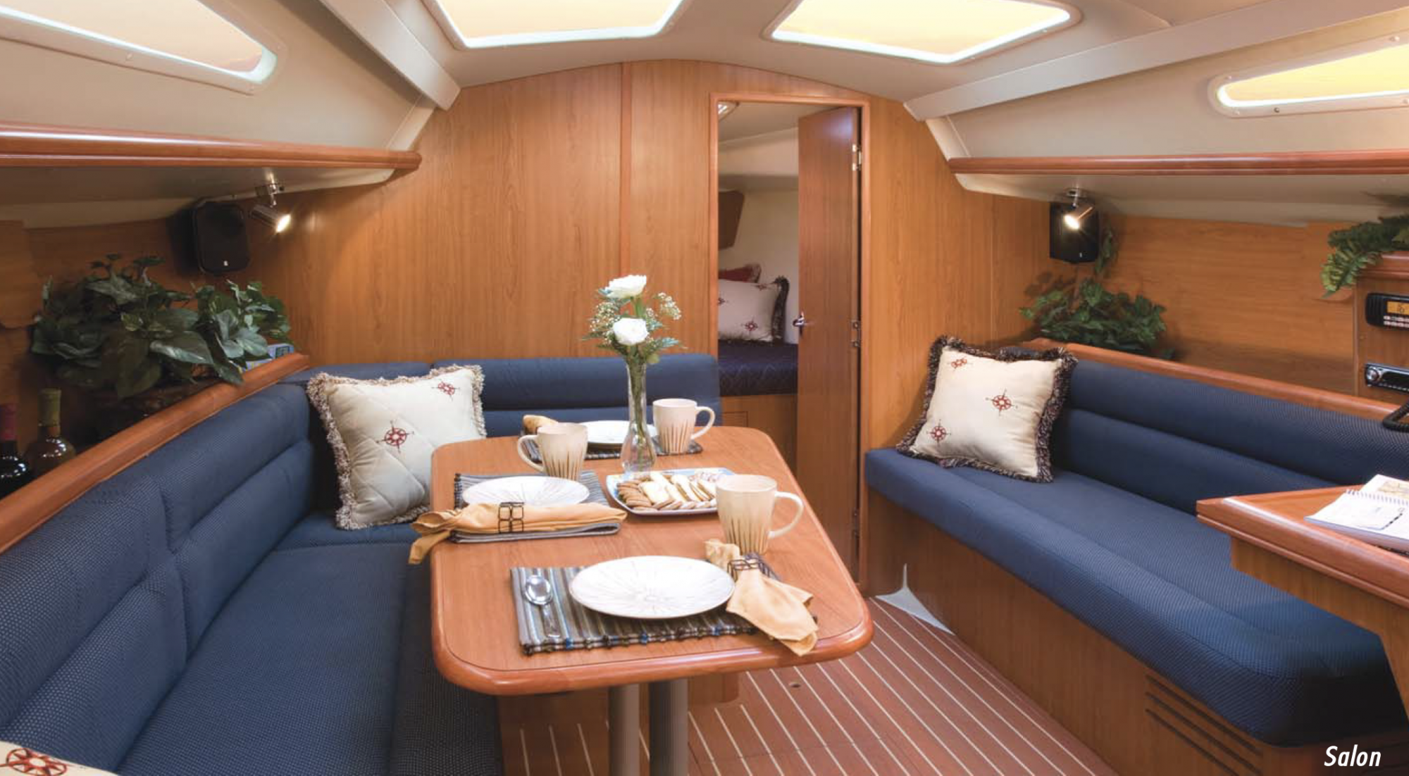

It is the standard teak veneer. A thin veneer, which is a concern I have when attempting the repair. As far as the lacquer finish, I'm going by the SOP from Hunter and the contents of the repair kit provided with the boat when it was newly delivered.
The finish is lighter in color than the usual teak finished with oil or varnish.
This is a picture from the brochure. The bulkhead and the navstation in this picture are identical to my boat. I'm just trying to get the sun damaged area back to a similar color and finish.

That grain does not look like cherry. Sometimes a repair means changing the area so it contrasts or is all the same finish compared to “kind of” blending in. Blending in tends to not meet expectations.
