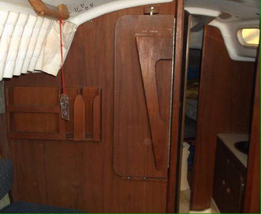

Here's the interior teak condition of our "new to us" O'Day 25 - getting her delivered this Friday - I was planning on a solution using vinegar and a little ammonia, mixed with water. Would love any better ideas, or specifics, on cleaning this up. I do have teak oil for after the cleaning. Thanks!

We use tung oil, is harder than teak oil, lasts forever almost and its put on by hand-no brush strokes etc, google tung oil

I use Star Brite teak cleaner and Watco teak oil....Watco because to me it has the best odor among the various teak oils I've tried, it goes a long ways and has good consistency (viscosity?) for application w/ a rag to vertical surfaces. The teak looks good for ~ 2-3 years. Star Brite cleaner is relatively expensive though--so thanks for the vinegar + Dawn suggestion, I'll try that next time.

The method and product you are looking for will depend on what you want for a look. Teak is often just oiled because it doesn't need protection from water as much as it does from drying out and oil is easy to apply. If you want a hard finish then decide if you want the soft luster of a mat or satin finish or the high gloss of a varnish. Tung oil and semi gloss urethane are good for a satin or semi gloss finish. Only urethane will do for a high gloss look. The more coats The better the shine, to a point. After about 6 to 8 coasts you are looking thru too much UV blocker if you go with a typical spar varnish.
Vinegar is a good suggestion for cleaning.
