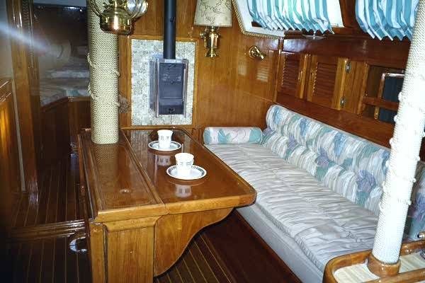

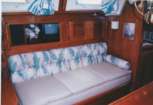

Into this void, I want to chime in with an observation/opinion. One of the primary reasons why I chose my particular used 1980 Cherubini over anything else that I looked at was because the interior cushions were recently new -- and done professionally. The PO (wife probably more than husband probably) had good taste with interior design (to my and my wife's viewpoint anyway) in regards to the fabric and how it interfaced with the interior wood and layout. All edges were (and still are) sharp and accentuated with piping. After buying the boat, I've refinished the wood in the interior and cleaned/scrubbed all grime off the interior surfaces. My wife and I now love sitting "down below" reading, enjoying food and drink and watching DVD's on our 15" big screen. This compared to friends' boats where somebody at some point decided that red/white/blue/green/yellow striped fabric stretched awkwardly over foam cushions was the proper nautical look for real men? (Hope I'm not offending any readers here.) OK these friends have 32" screens, but I still want my interior.
