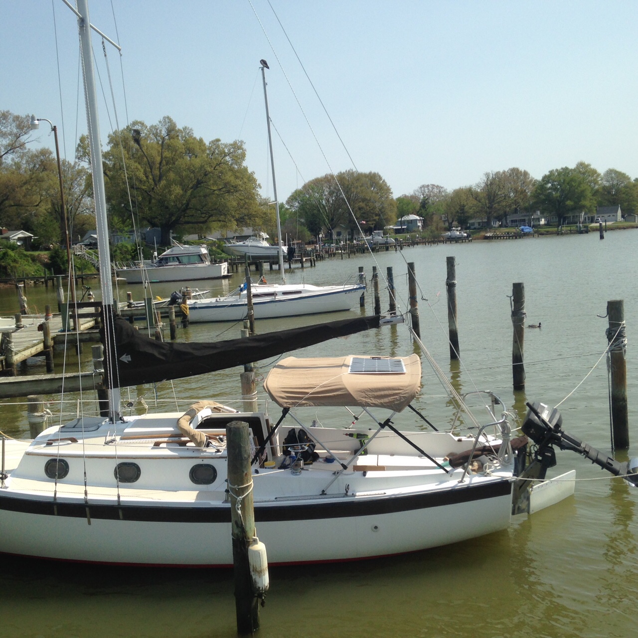

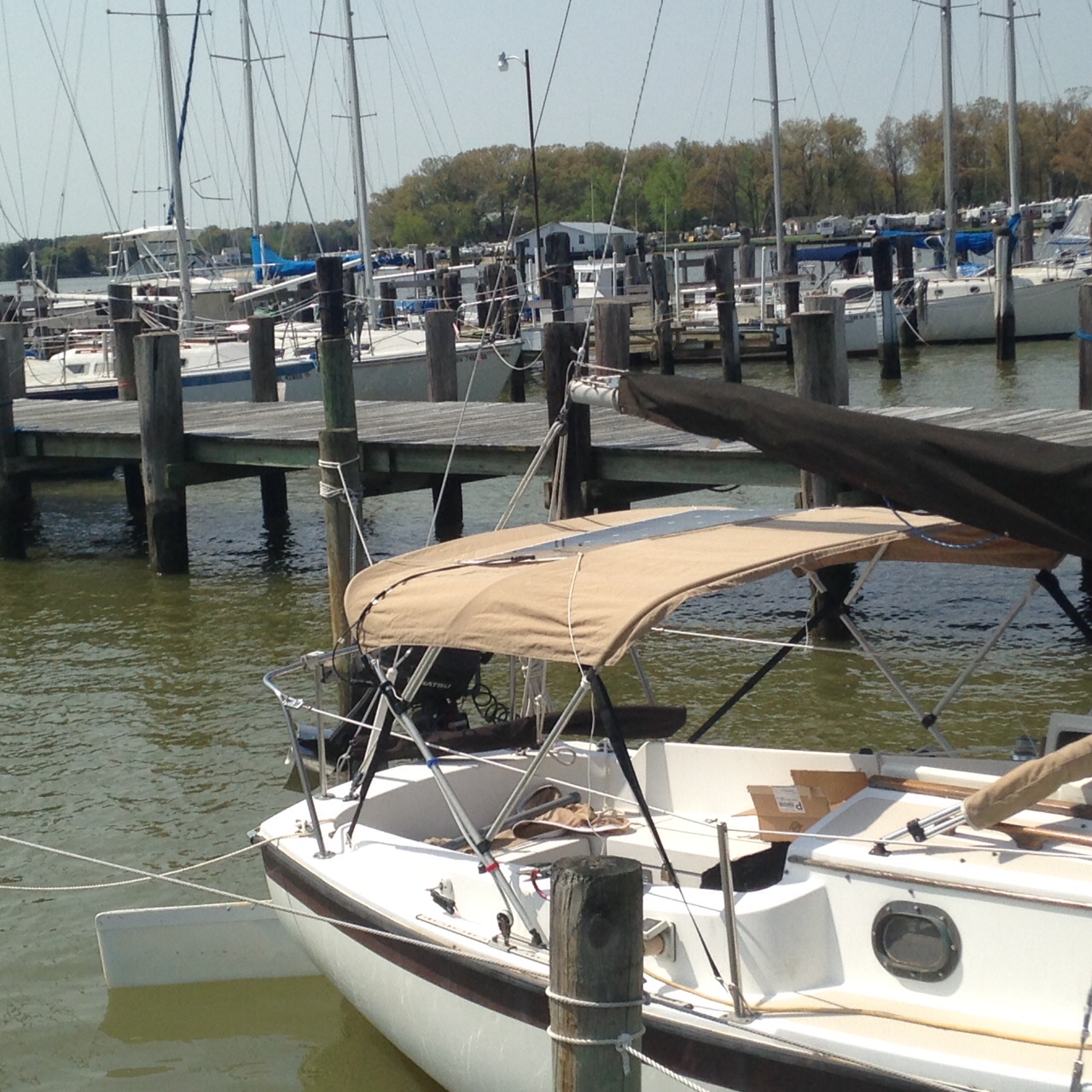

I have a great solar set-up on Saga. I am running a 100 watt flexible panel to a Genasun GV-10 charge controller. My house bank is 2 GC2 batteries for a total of 230 amp hours.
The flexible solar panel sits out of the way on top of my bimini when in use. I store it down below when the boat is at her slip. I simply tie it to the bimini. I may eventually add velcro to attach the solar panel but the tying on works for now.
If you can swing it check out the Solbian Flexible Panels. They are expensive but worth it. I am running a Renology Flexible panel but there have been a few reports of them causing fires. My set-up probably won't cause a fire since the panel doesn't sit against anything rigid but that is another reason why the panel is not hooked up when I am not there. I will eventually upgrade to a Solbian Panel someday.

I would never cruise without a bimini. After having one you learn that they are worth so much. Shade on a sunny day, cover on a rainy day. I can take this one up and down pretty quickly too.
If you want a good solar set-up then this would be a good addition. You won't regret the bimini. I was out 12 days without going into a slip. I had almost full batteries the entire time, even after a few days of rain.

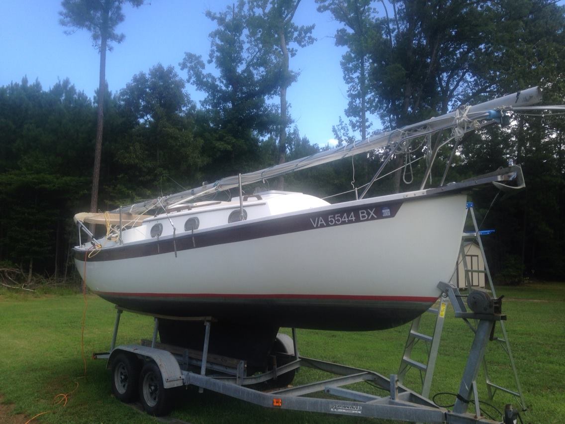

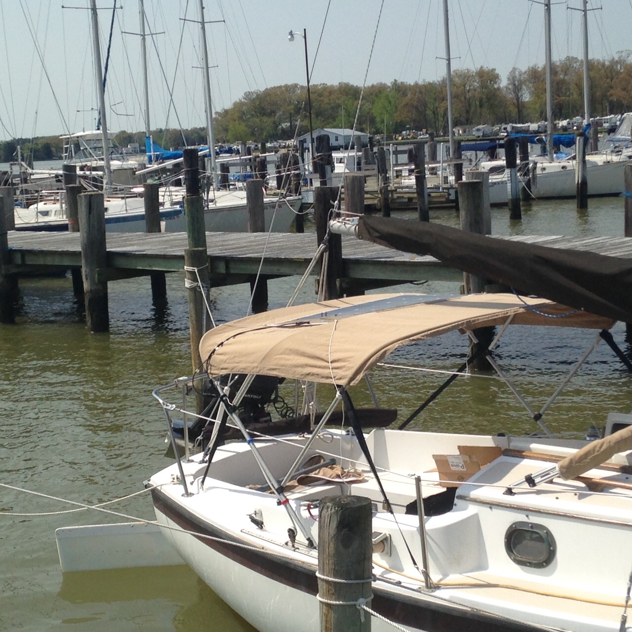

I can leave my bimini on my boat, folded down, and still remove the mast if I want to. I can take it up and down pretty quickly too. It is all about the design of the system. Me, I would rather take the trouble and save my skin from the direct sunlight.
I would hate to rig my mast everytime I sailed. I may have more rigging with my boat because I have to remove three stays just to drop the mast.
May 23, 2004
3,319
Yep, just as I remembered, the Bimini is folded down and covered and the mast was dropped over it. It works well. I have to remove my dodger, totally, but the rest seems to work just fine. I remove the bimini for the season and store it inside though.

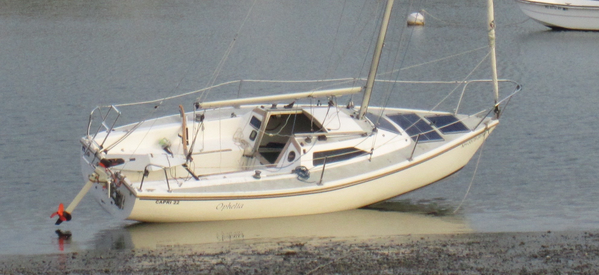

I used Ganz flexible solar panels flush mounted on the foredeck. 110 watt array that keeps the house and motive batteries charged. The panels will conform to the curvature of the deck. AND you can walk on them! They are slippery when wet, but there is plenty of deck space to walk and not slip.
The motor is a Torqeedo Cruise 2.0 purchased in 2011. The boat is (normally) on a mooring with no shore power. The solar panels keep the four GC2 batteries and one Group 27 charged. The Genasun charge controllers are set for 12 vdc nominal input. One provides the nominal 12 vdc for the house battery. The other provides the nominal 24 vdc for the motive batteries.
The picture was taken during an unplanned careening exercise.
