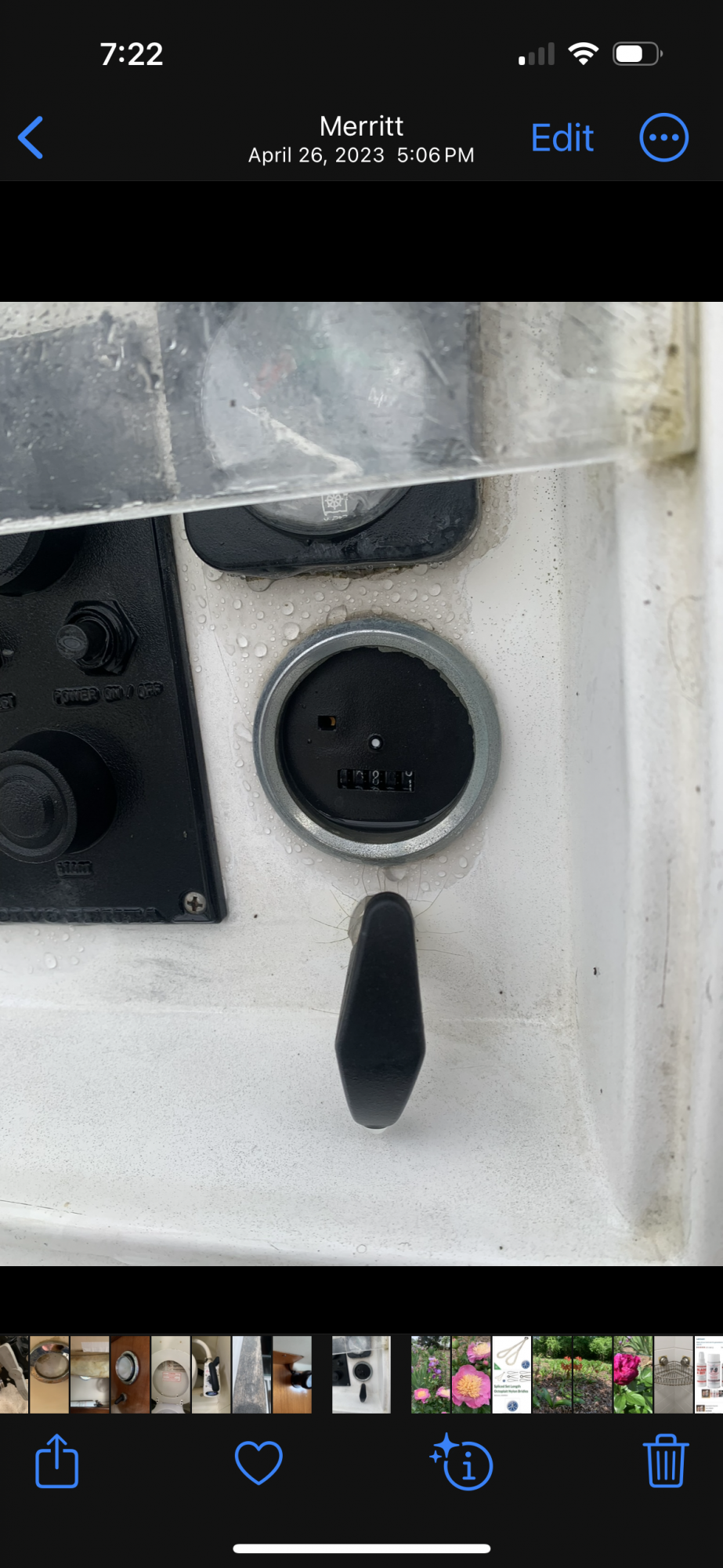

How do you get asses/open the instrument panel that houses the tachometer, hour meter, and starter switch. It is located at the stern/ starboard side of to the93 Beneteau 35s5. I need to check for corrosion, and secure connection, need to install a new starter switch. For the life of me, I cannot figure out how to open this panel.

Not a complete picture. But now that I think about it, the white part of this panel a molded in the boat but the black panel looks like you would remove the four screws and put it forward. The meters that are in the white part of the panel could then be accessed from the opening left by the black panel. Sometimes you look hard and just not see. But I just started working on this boat and quite nervous when I start pulling things off.

Yes, you can probably remove the screws holding the black panel in place, and you may need to work to “gently” pry the black panel out…as it undoubtedly has some sealant holding it in place. And the panel is probably brittle and will crack easily.
Or, as you said, you may be able to reach the back of the instruments through the lazzarette.

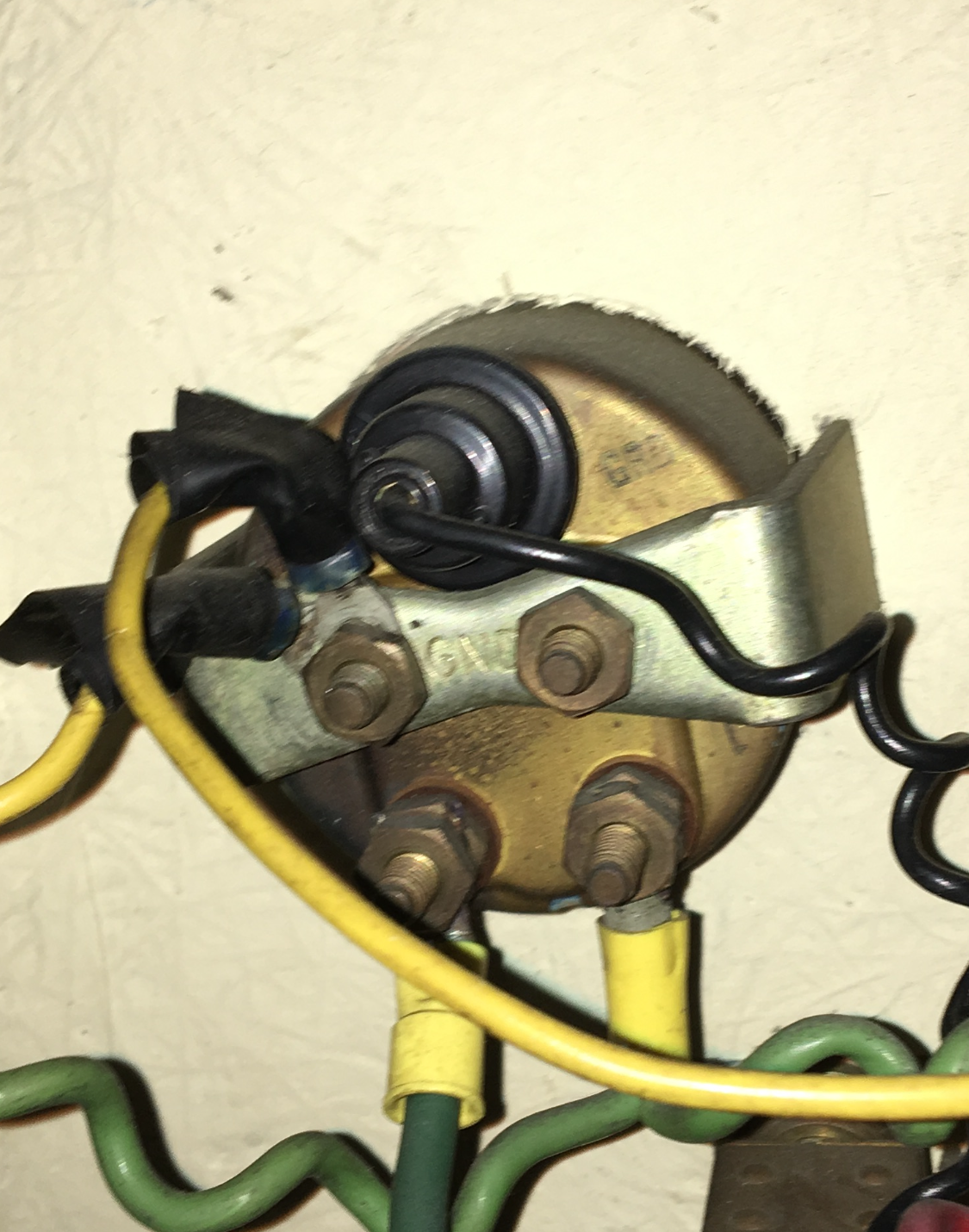

The black panel is likely held in place by the 4 corner screws. The appear to be stainless screws. Builders choose between two options. A machine screw with a nut or a metal screw into the fiberglass. If the screws don’t come loose then they likely have a washer and a nut holding them in place. This will require holding the nut behind the panel to get it free.
The Hobbes like engine clock most likely uses a clamp like fitting. You can release from the back and it will pop out the front. It may look something like this.
