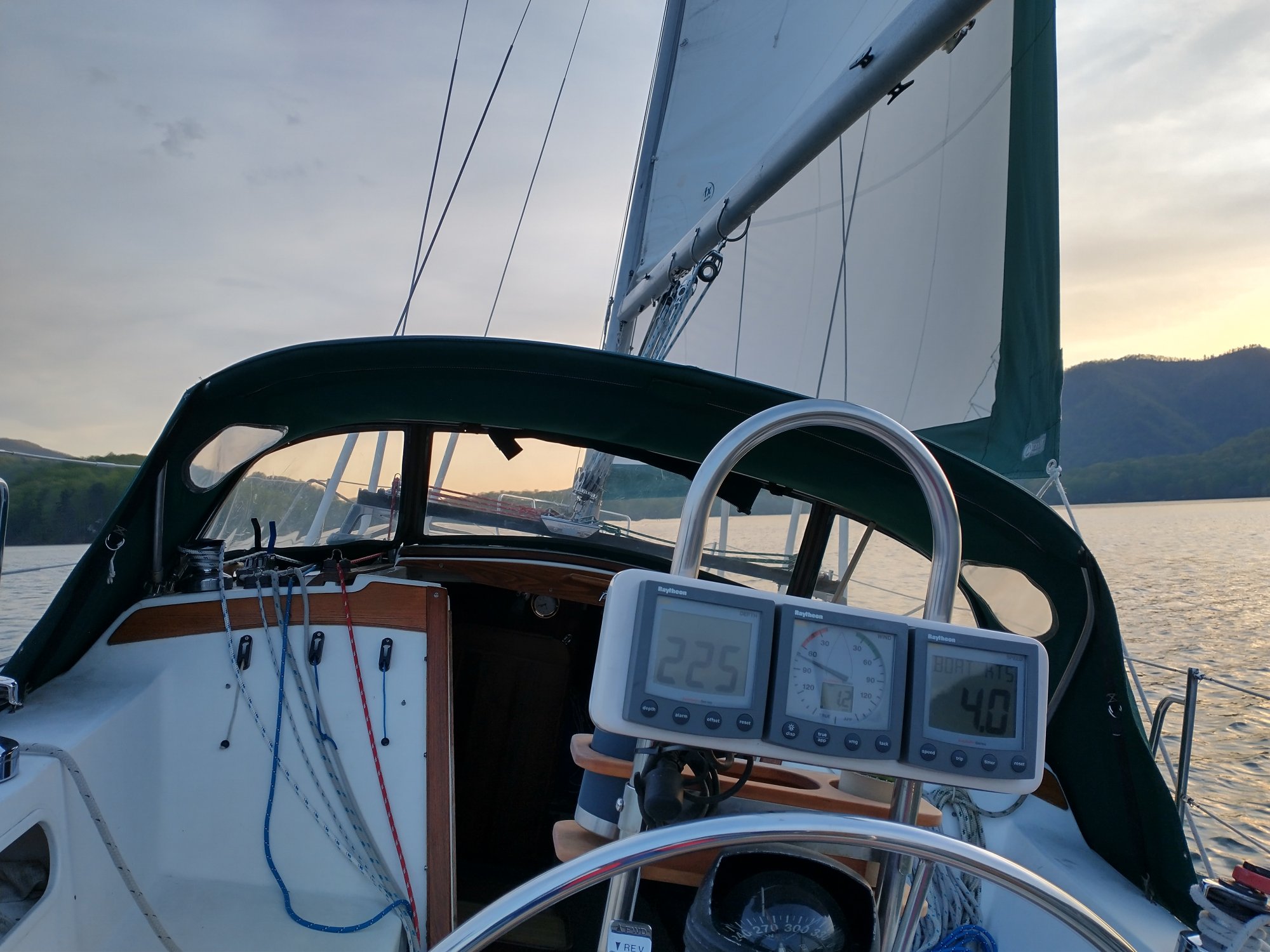

Sorry, but you mention "Starboard side just forward of the aft bunch" do you mean on the starboard cockpit side of the aft cabin wall? Why not on the pedestal rail? Saves cutting holes as you mentioned, puts them where you can easily see them (particularly at night), and leaves the cabin bulkhead clean and available for aft run control lines/halyards. If you plan to race, trying to see your instruments will be tough when crew is hustling through tacks or responding near sheeting adjustments in squirely air.

Yes, just forward of the aft bench on the stbd side of aft cabin wall. My pedestal rail is much lower than yours and an instrument box/enclosure would be on top of the rail. I like your set up and going to steal your traveler rigging. Mine has new canvas with hole cut through the glass for the traveler line which is not ideal. Maybe I'll look at extending the height of the pedestal rail and doing something similar to what you have. Thanks for the quick response and common sense.
