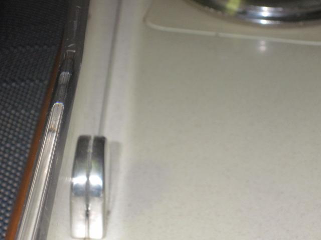

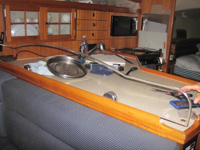

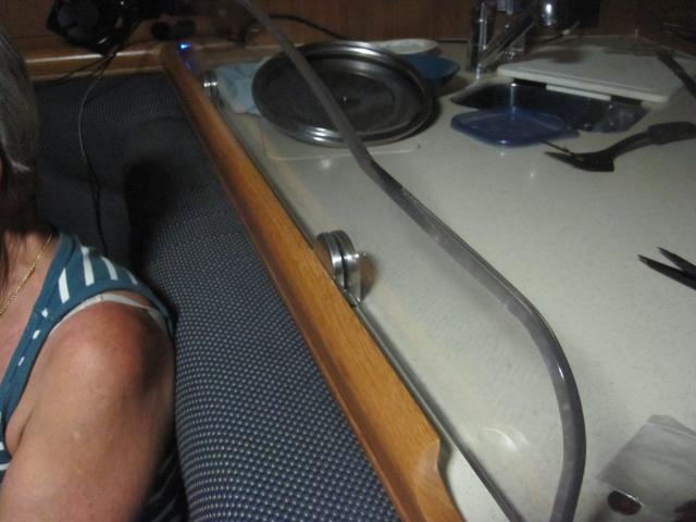

Look at pictures in Owners modification for 356. We have glued with Sikaflex and it hav been OK for 5 years. Clean the Corian well.

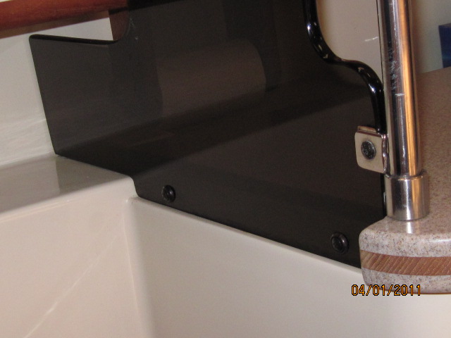

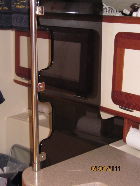

Coincidently I spoke to Ronnie Barnes at Hunter Marine (800-771-5556 ext 4 or retailparts@huntermarine.com) today about same for my boat. They offer a couple of options in clear Plexiglas with brackets. You could get same from a plastics shop or tempered glass from a glass shop. Consider how to secure it to either the counter top with screws and brackets or backstop in some fashion. Steve offers guidance if you drill into a Corian countertop.

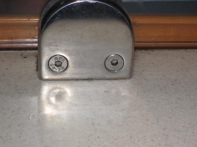

How did you secure the brackets to the Corian? Did you use machine screws?

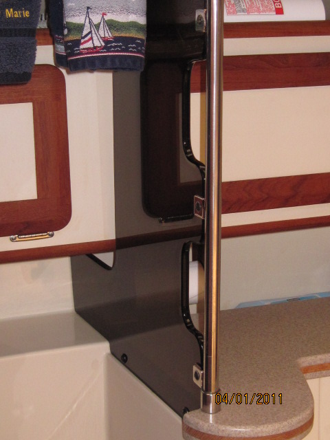

5,832
Hunter 36 Punta Gorda
Machine Screws
I think Hunter supplied all parts but I may have gotten some stainless screws and predrilled small hole first what ever size in the mounting braket that Hunter supplied,was going to use nuts and bolts but did not and it is very strong since 2007,it was used on the new 2007 38 so just measured to check and it fit right in on or counter and we love the way it looks yes $$$$ but well worth it.

Seadaddler, that's exactly what I want done albeit my glass is shorter. it'll do. I tried double-sided tape. Its kinda shaky when bump into but holds for now. For permanent think I'll drill a pilot hole for ss wood screw. Thanks for info/pictures.:dance:

I am not sure if I used sheet metal stainless type or wood type I guess either is good but did not tap at all just made sure the screws went in snugg but not too tight or loose,if the screws were going in too hard I stopped and drill next size with out too big because I think I could only use certain size to fit in the stainless bracket.
