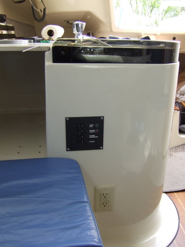

I was a dealer and installed many shore power installs on the 26 and to be blunt, I installed the first one on those boats.

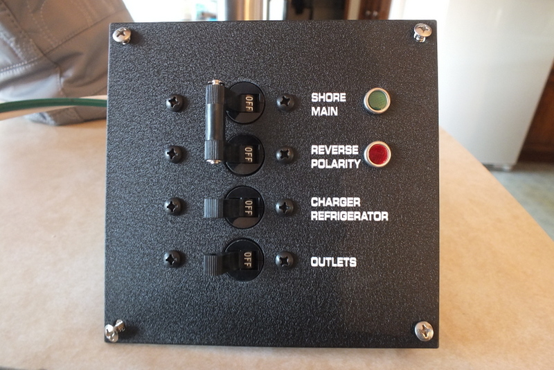

First, I suggest a simple Blue Sea panel on and off switch with reverse polarity light. I use to put those on the right side of the galley unit. You will need a back cover over that. Use of marine grade 12-3 is suggested as it is more flexible versus what you can purchase at a regular store due to construction. I placed that there as it was out of the way and if at night you had to turn it off, it is right there where you can reach for it quickly. If the reverse polarity light ever came on after hooking up somewhere, I would tell my clients to consider that electrocution and immediately unhook from that dock and get the heck away from there and then report the issue.
As for placement of the outlets, that will be left up to you but do tuck and secure the electrical lines so they will not lie loose. I asked my customer where they planned to dock and put the connectors on that side transom. Later on, I started placing it in the cockpit storage locker port side as on Kermit's boat as an added safety protection from the weather.
Add a GFI at the galley unit and that sir is a must. Hope this helps.

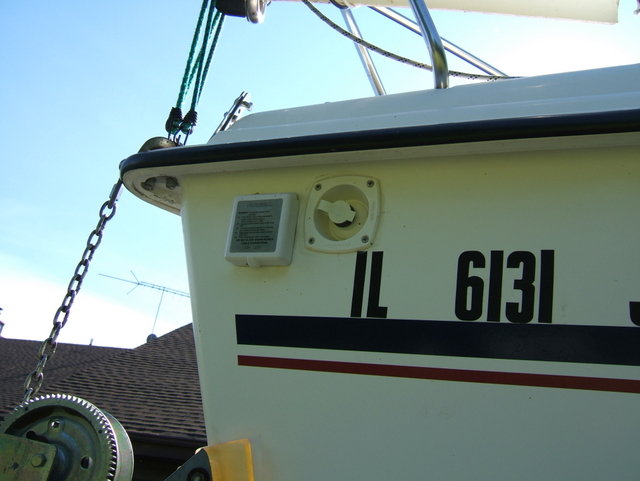

OK, this is what I did.
I get grief for this but we are always bow-in and so the logical place to add the power inlet is is the bow. Otherwise I need an extra 25 feet of shore power cord. Once you get into the bow, you can cut a hole in the forward bulkhead, bring the wires through the seats on the starboard side, into the galley, add a breaker and outlets and you are done.
I used a 25 foot shore power cord that had a burned out outlet for my wiring to the breaker. No one fixes these, they just get another so it was free. Total cost, less than a $100. The shorepower breaker and marine wire for the outlets was $69 at Skipper Bud's.
10,524
-na -NA Anywhere USA
From experience as a dealer over the years who installed over a thousand shore power systems, just a few comments. Never put the shore power inlet on the transom due to water intrusion. If you can relocate it above the hull to deck joint, I would suggest doing that. In addition, if it came off and the plug was hot falling into the water with someone in the water nearby, it would be quite dangerous.

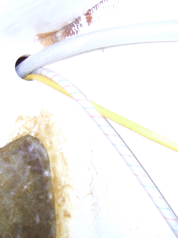

As for lines running thru holes, in time it will chaff and wear thru. I suggest that you attaché the split loom or cut black corrugated plastic to the hole to prevent that.
I am glad to see the reverse polarity on the distribution panel but please make sure you have a cover plate on the back inside under the main sink area.
278
Hunter 26 Illinois
Dave
The electric inlet has been there for 10 years and no water has ever come in the boat. After a rough water sail only a few drops ever come out when I lift the lid to attach the electric. I always have a wrap on both sides of the bow pulpit and the plug is held to a few inches below the inlet if the ring somehow unscrewed. I will add anti-chafe to the bulkhead opening, even though I don't see any wear to be safe.

10,524
Kermit;
Please chime in and let them know where your outlet is with photo and reasons why I put it there. Sometimes folks do not realize I have experienced and do things a certain way as discussed.
In addition I will never recommend adding shore power inlet or connectors on the transom. Like I said, I experienced a lot in all types of weather and that includes a hurricane two or more in my time.
