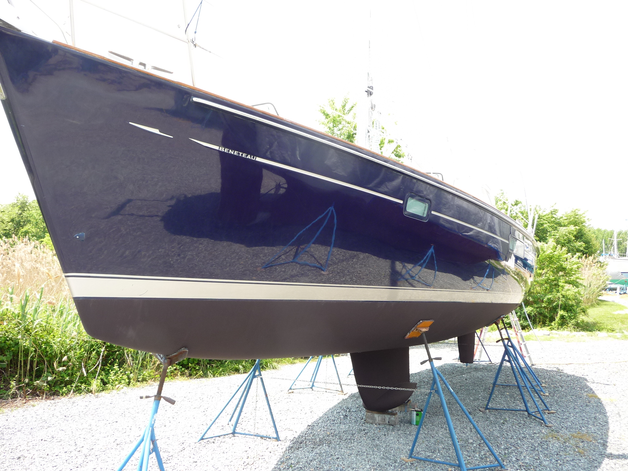

Hi I have a Beneteau 361 year 2000 and would like to install a rub rail. I have checked on Beneteau spare parts site and found the rub rail that they install. I have contacted them to find out how it was done but did not get an answer back. I used to ask Ward Richardson at Beneteau but it seems that they don't want to help us anymore. I have seen a picture of a 361 with a rub rail just under to toe rail and would like to do the same.
Can anyone tell me please how to install, I am afraid of screwing the rub rail in the hull but maybe that is how it is done.

Attached a photo of my installed rub rail, detailed in the thread Ralph links to. You will screw this rail to your hull, within a few inches of the toerail where the hull is strong. It works well, and keeps your topsides protected. Good luck mon ami!

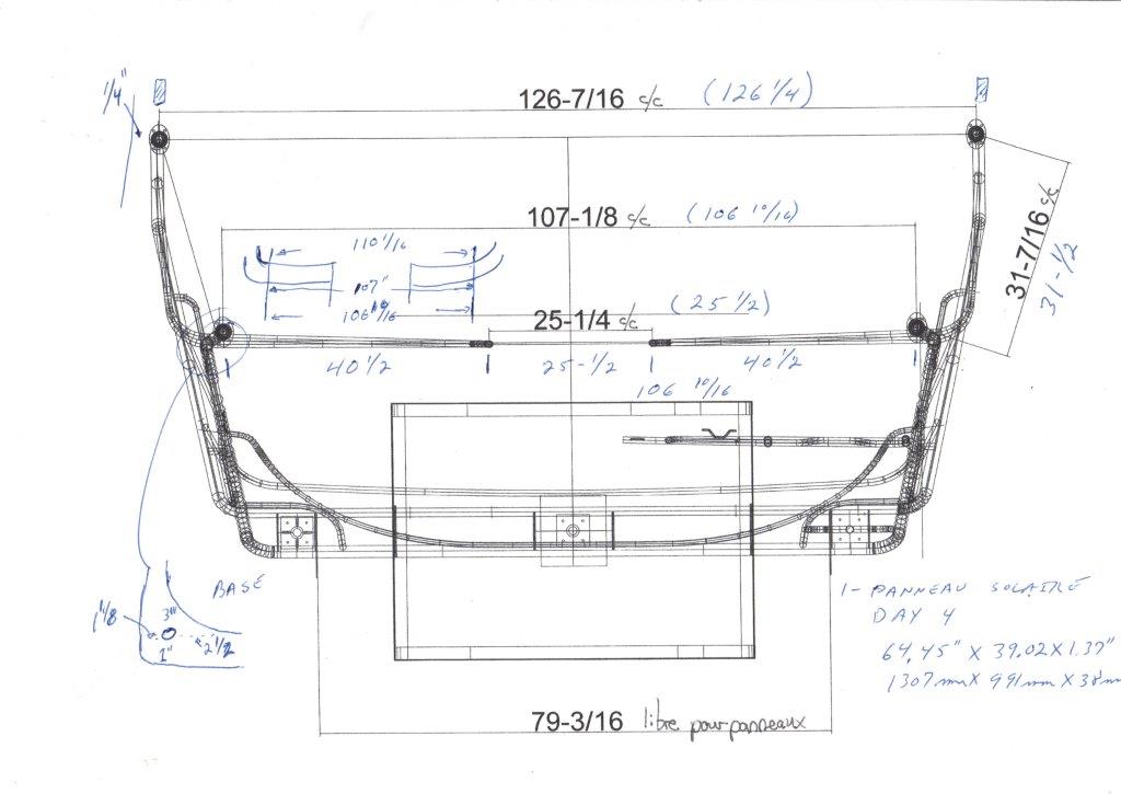

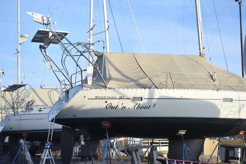

Hi Syversens, I got the arch custom made by a Produits Metaux DT, company that specializes in arches. (they ship everywhere and have big contract with cruiser builder in the US). They already had done one for a 361 so I checked the measurement to make sure they were the same. I removed the balcony (not sure if it is the right word) and the integrated it in the arch as you can see in the attached pictures. The arch comes in 2 sections that are easy to put together. With a friend and using the boom top lift to raise the arch it ook us about 6 hours; we started the installation at 8AM and the job was completed at 2PM. They provided all the hardware including the backing plates. Easy job and I can take more pictures if you want more info.

That arch looks great! foldable arms too, I'll definitely contact them and get a price, it might be a bit over my budget though. So you replaced a lot of the existing railing? I couldn't tell if the base on the far aft is replacement for the existing pole or placed side by side.

Hi Gunni, I will get in touch with you when I am near Annapolis. Looking forward to meet you. By the way, how did you screw the rub rail into the hull? I assume you have pre-drill the rub rail and then screw with some 3M caulking.
Hi Syversens, no I did not replace the railing, I took it off and they integrated the arch with the railing. The vertical sections at the far aft, where you lower the seat to gain access to the scoop, are the only vertical pieces that were kept. When I installed the arch these two vertical pieces went right back in the original holes and I bolted them in place with backing. The two section of 2'' SS that you see on the sides have special plates on top and backing plates underneath. I don't have detailed pictures but when I go back to the marina I will take more pictures and post them.
The folding arm is nice and when opened you can lock it in place to lift the outboard. I asked them to install a special railing on the starboard side to install a Edson outboard support. I choose starboard for the outboard because the 361 has a tendency to list to port. The arch also comes with special brackets that are used to lift the inflatable. I have installed 3:1 purchases to lift the dinghy, very easy, my wife can do it and it is a AB rib, about 130lbs. Again I will take some pictures.

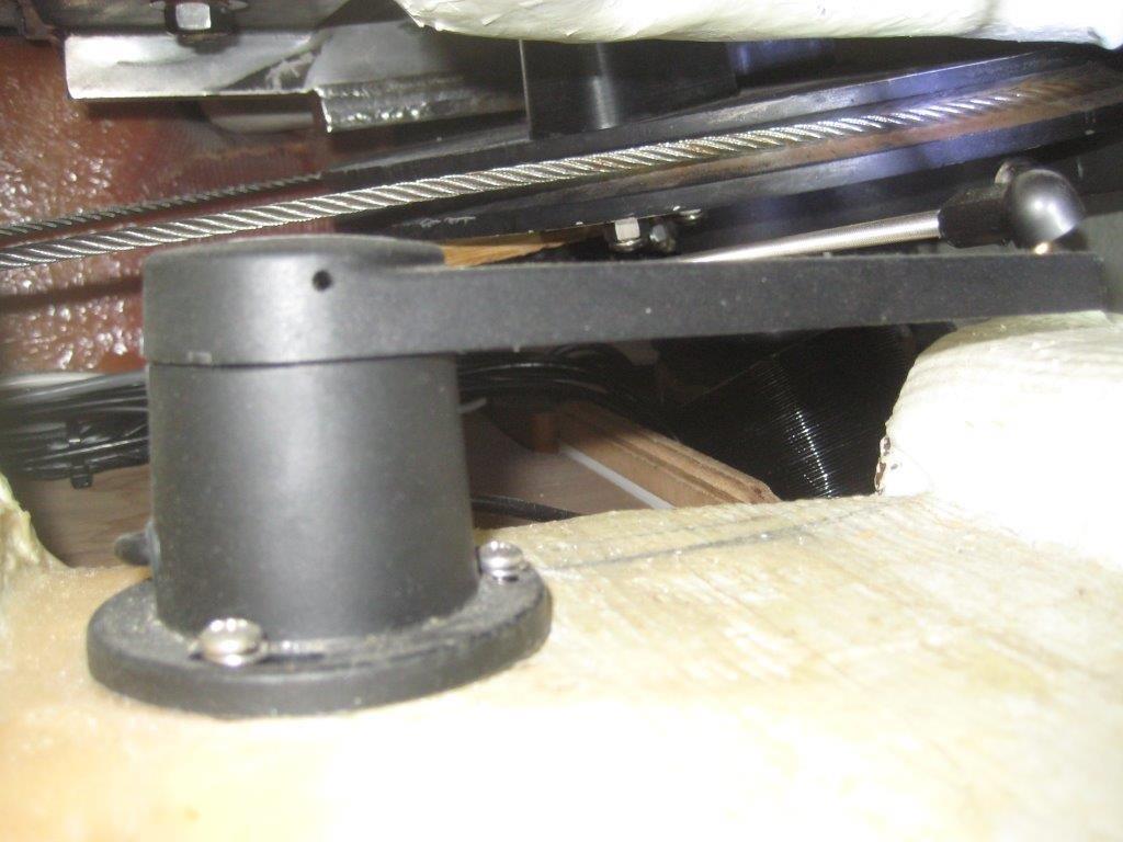

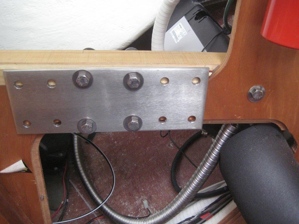

Beneteau install the linear drive in the port lazarette, see the attached diagram. I choose to install it under the propane tank container because this is not a space that is frequently and it is difficult to access. I also installed a Webasto heater in that section, you can see it in IMG2. You will notice that I had a backing SS plate made and that the other side there is a solid piece of wood to distribute the linear drive push. The linear drive is bolted thru the SS plate, wood and supporting bracket. I bought the special bracket made by Beneteau that fit nicely under the quadrant. I also attached the dimension that I measured for the arch.
Metaux Produits DT, Alexandre Lahaie, 1-819-533-3222. around $7,000CND for the arch so maybe $5,000US depending on options.

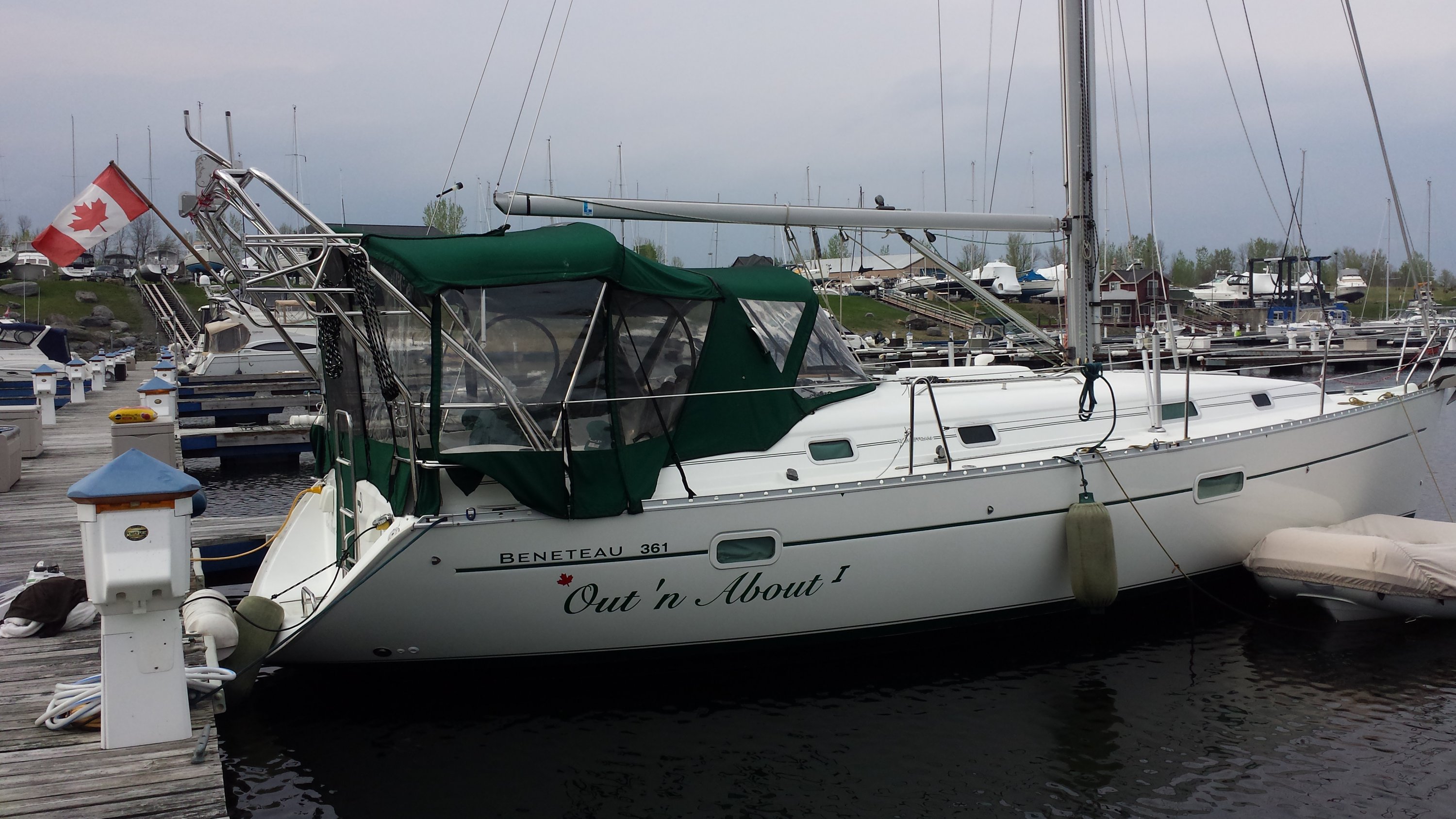

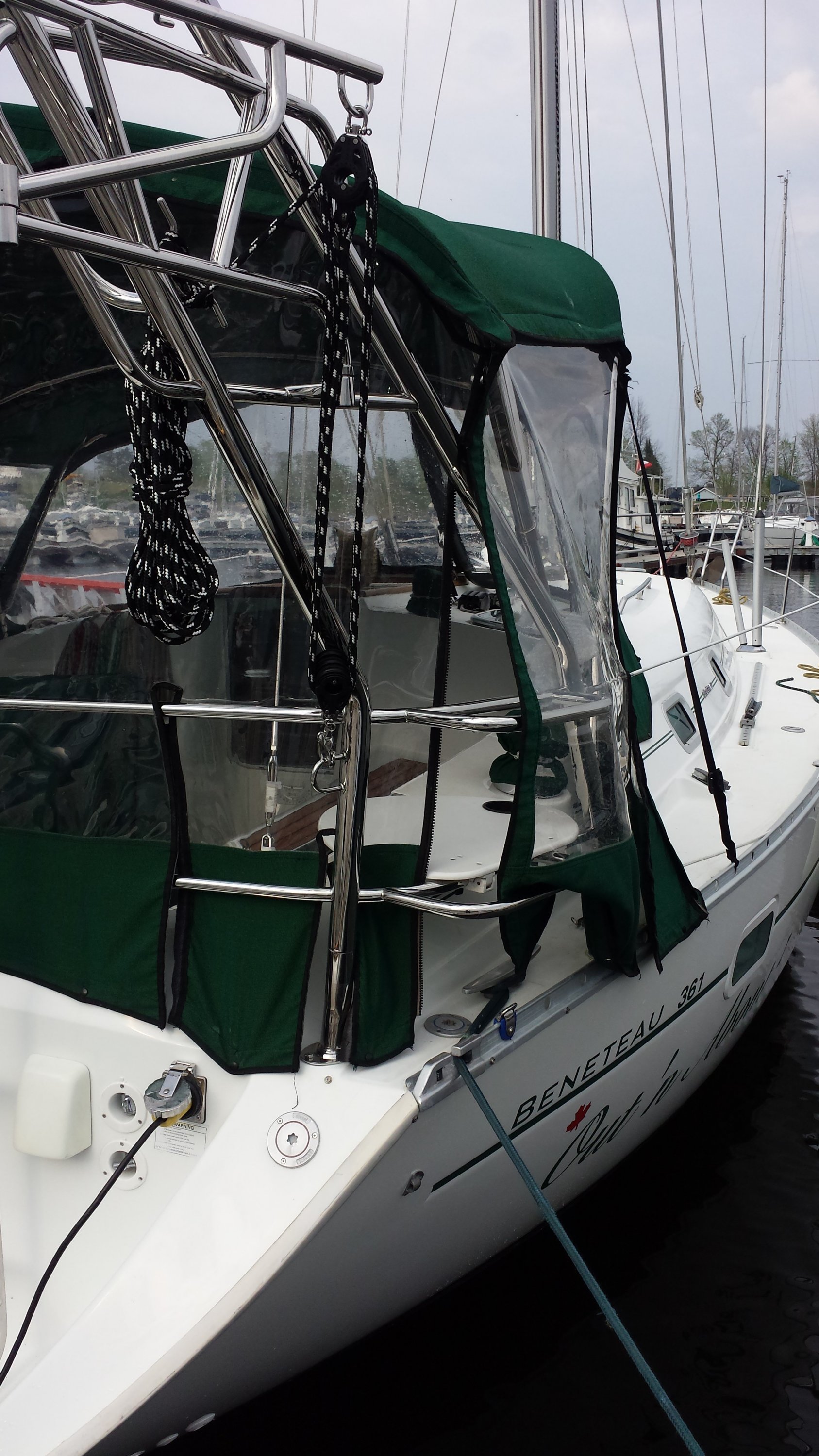

Oups, forgot to mention that I had to get the full enclosure modified to fit around the arch.

Suttonski you seem to have a very beautiful Ben 361!! I would love to see lots of pictures of your boat (if that's fine with you of course). Always willing for new ideas...

Very nice, just so I understand, the autopilot is installed under propane tank in the picture, the black box is the heater right? I don't remember clearance between the propane tank bottom and the bulkhead but you still have tank there so it must fit right? So let me know if you are considering replacing it, I'd be interested, I might do this either way once I get a good idea of the pieces I need, either way works.

The rubrail location is a thickened spot on the topsides, attachment is mostly via the 3M 5200 adhesive, and the screws were selected to length so that they do not penetrate the hull laminate. Suggest solid-back SS strike, not hollow back. More expensive, and more durable.

Syverseens, yes the Webasto heater is the black and grey box on the side. The electric linear drive fut nicely under the propane box. It is attached to the quadrant with a bracket that I got from Beneteau. Qudrant is already pre drill for this piece, just need to install with bolts and nuts. Will try to find the part number for you.
In that space I have installed on the bulkhead, facing aft, a TriStar MPPT regulator for the solar panel, the wind generator regulator as well as the wind generator dump resistance.
