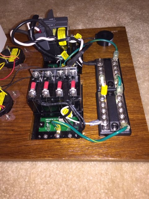

Here's my panel inside the cabinet I made. The next step is to mount it on sidewall of the nav station.

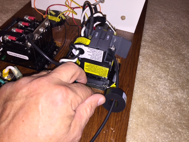

The AC main ELCI and branch circuits are mounted side by side. The coil is fixed on the ELCI, shown with the yellow tag that indicates that the wires should be twisted. Hot and neutral leads are twisted as they pass thru the coil and secured with a tie per instructions. The hot post is actually very close to the coil so I had to loop the hot lead around to join with the neutral as they pass thru the coil. The hot lead connects to the post on the AC branch circuit, while the neutral lead connects to the neutral buss. The disc at the top is actually the coil for the AC ammeter.
When I am at the boat and have mounted the cabinet, I'll be ready to connect the hot lead from shore power. It will pass thru the AC ammeter loop. I'm not sure how I'm going to secure that donut ... it is loosely connected to the ammeter at the upper left with those 2 thin black wires. It seems odd to me that there is no instruction. I guess Blue Seas assumes that only those in the know will be doing the installation. (The black lead that I show is used just for illustration)
I haven't shrunk the crimp connectors yet if they look unfinished.
Those orange wires are provided for 24V backlight. I'm not sure what to do with them other than to simply clip them off. The red wires are positive for 12V backlight. I crimped them together to pass them thru the shield to the DC panel. I haven't decided if I want backlights to be permanently on with the main switch (connected to hot lead) or wired to a breaker so I can switch the meters on and off. Same with the water tank and fuel tank gauges. The Batt monitor is wired direct to Batt post, so is on all the time, unless I change the wiring.

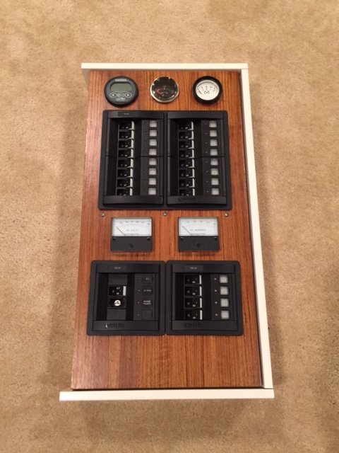

Thanks! Yes, the white board in the last picture separates DC section from AC section with small holes to pass the DC wiring thru for backlights. The back of the cabinet will have a lexan cover with passages for the AC wiring that comes into the cabinet. All will then be enclosed. The passages have to allow the wires to remain relatively stationary when the panel swings open on its hinges.
