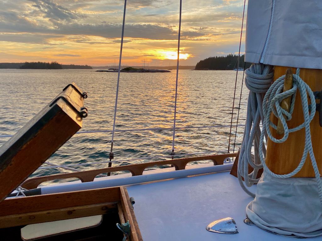

I ran the vent for our dry toilet through the house roof and covered it with a small clamshell.
After one season, we're surprised at much of an improvement the composting toilet has been. Easy (I think), no head odors.
TomY, I'm considering routes for an Airhead vent. Curious what's preventing water from your deck draining into that clamshell vent?
TomY
Alden Forum Moderator
Jun 22, 2004
2,769
The 1 1/4" PVC pipe is set and clamped (below with a strap) 1/2" proud of the house top. There is a length of clear flexible hose that connects between the OGO and the PVC. I left a drop in that in case water entered. So far, not a drop.
