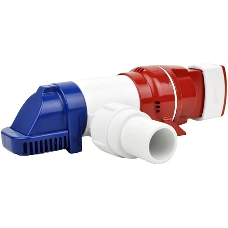

I have done this. My O'day 30 is a '83 centerboard version, so our bilges may or may not look similar. I used a
Rule Lopro 900gph Bilge Pump Automatic, available at Hodges marine at a great price, lowest I've found.
I wired it up to a bilge switch which is hooked up direct to the battery, therefore being always on. (My solar panels constantly charge the batteries)
The Pump lays in the lowest part of the bilge. The hose runs through the upper bilge wall immediately under the sole board lip, past the water tank and around, through the head bulkhead, T's with the sinks thru hull to let the water out. I installed a check valve to avoid back flow.
