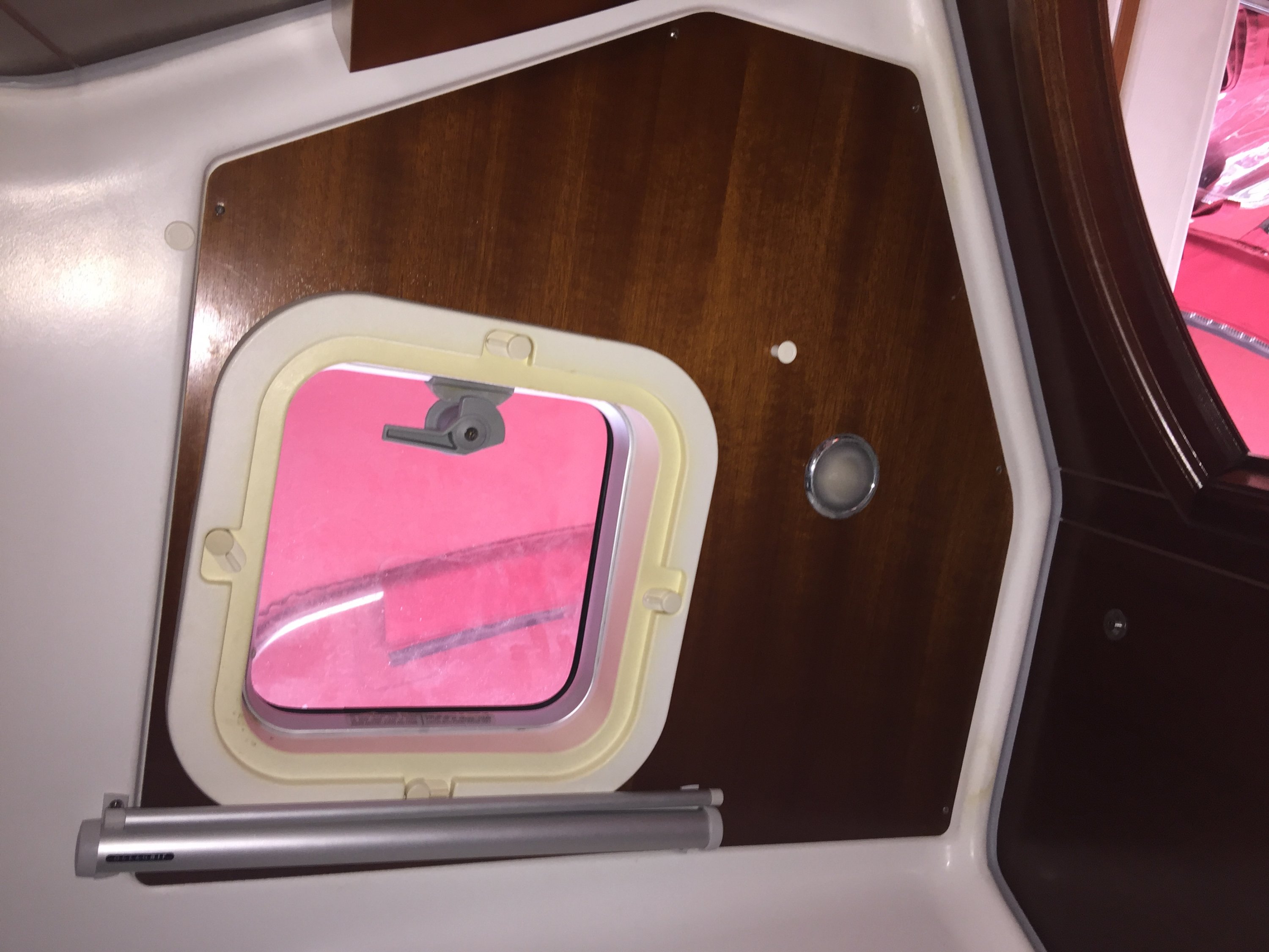

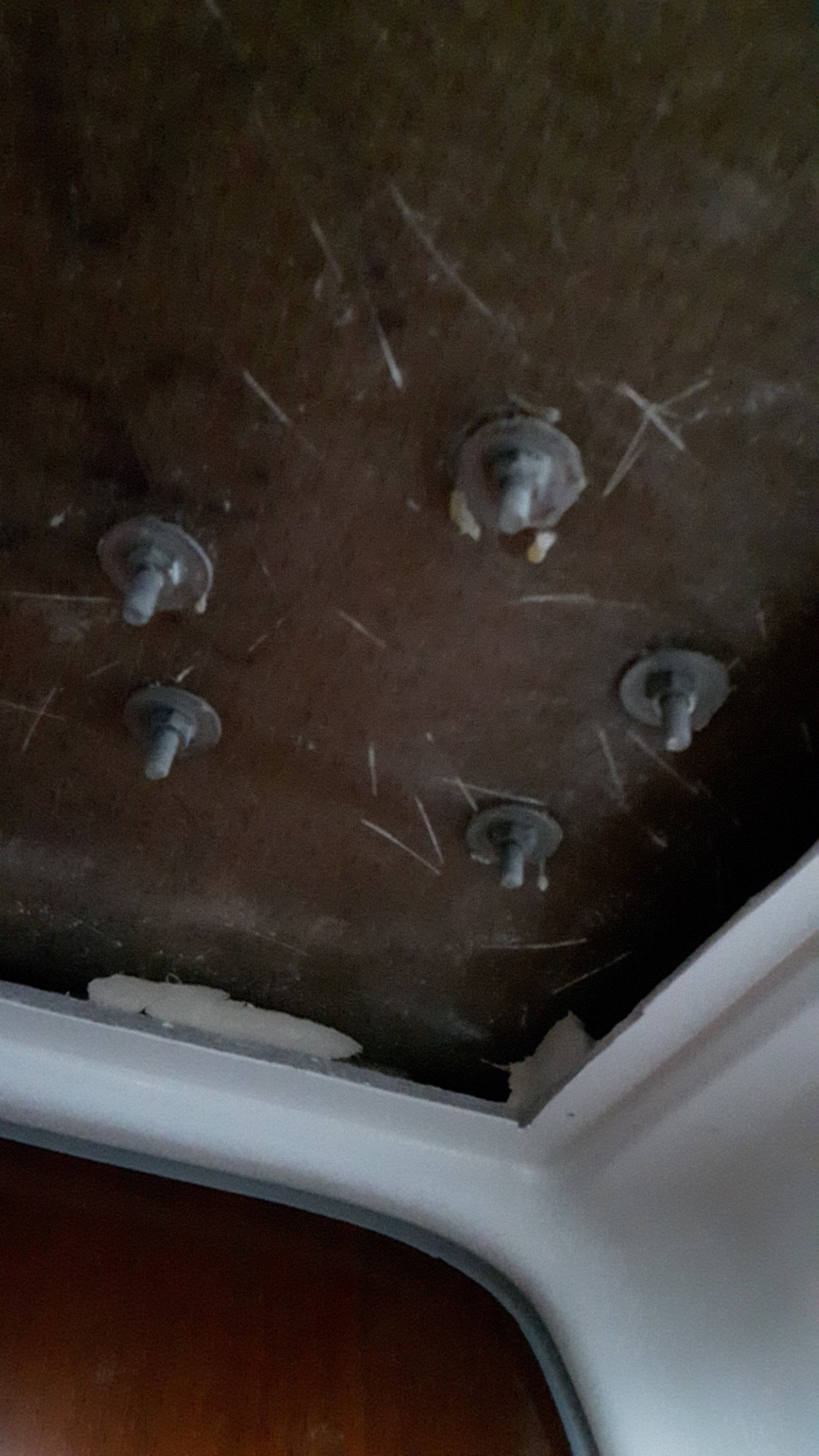

As the weather invited today to inside work it was a good day to investigate further. Removing the plastic around the windows made removal of the wooden plating much easier ☺. Luckily those were not glued and easy to remove.
I opened also up on the portside to see how the original installation was performed. Was a little disappointed to see the size of the washers used. Was thinking to use a bigger size myself, even considering a ring connecting all bolts together. But this might be overkill?
Pictures attached.

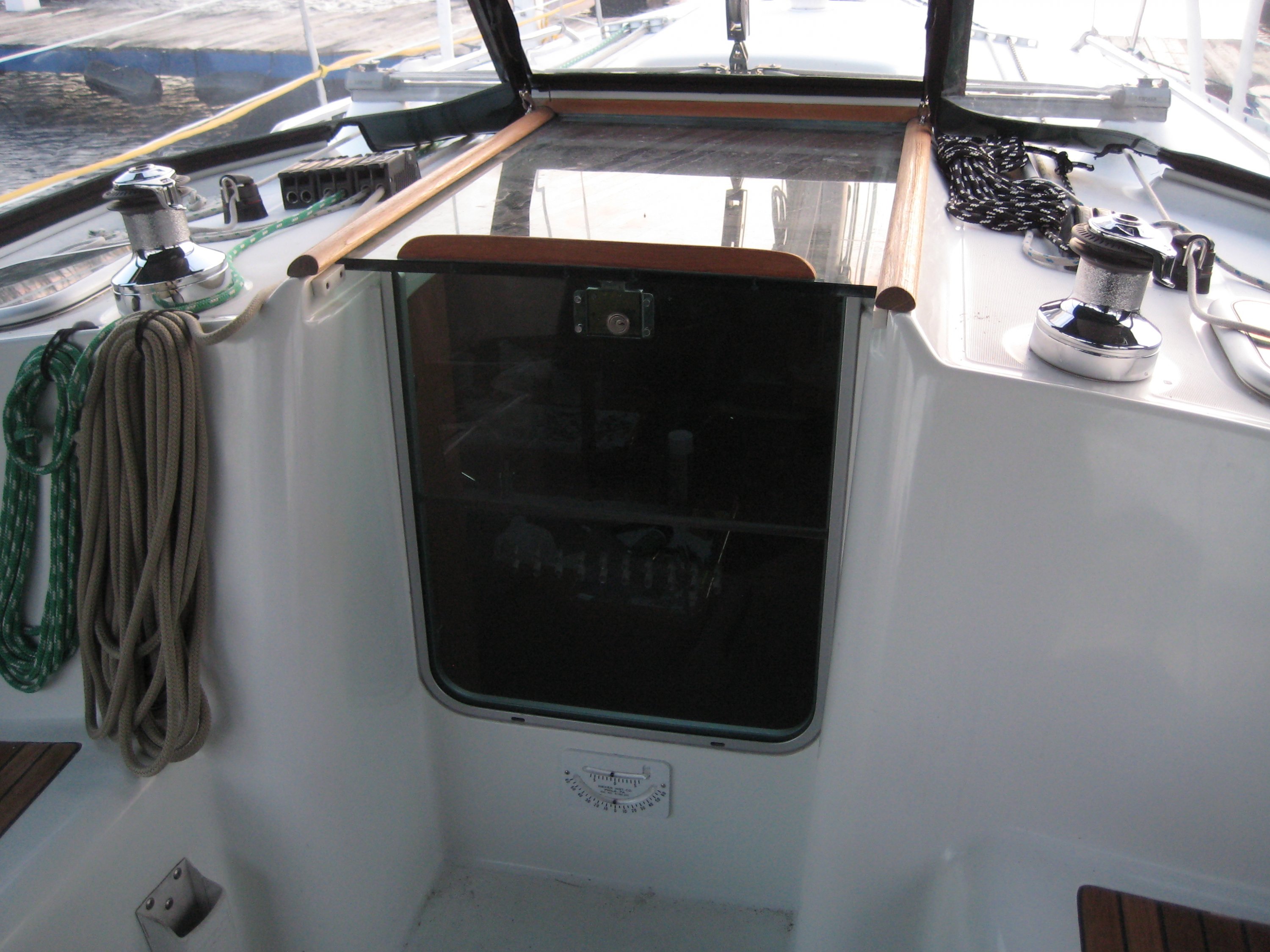

Hi, I have moved the Lewmar 30CST winch from port side to the starboard side and installed a new 40CST winch on port side. Not a difficult job, just removed the wood panel and you will have access to the nuts. I have increased the washer sizes just to be on the safe side. You will notice that I have also added Spinlock clutches and change the main sail traveller arrangement.
Overkill.
Consider:
The glass there is solid, thick, and supported by complex three dimensional structure.
The load on winches is in SHEER, not TENSION. That makes the load mostly horizontal, and not pulling vertical. That matters hugely.
Beneteau had real mechanical and structural engineers that figure out what build is needed based on both loading and structure. They create build policy based on that engineering. Some guy in the shop didn't pick that hardware.
And finally some emperical evidence, Beneteau has makes thousand of boats like that, and has for years. Have you ever heard of a winch pulling out, or even stress cracks? Not me. And I listen. And I've also been under there on our raced First 36.7, which is subjected to much bigger loads than you will ever see Looks like new 8 years on.

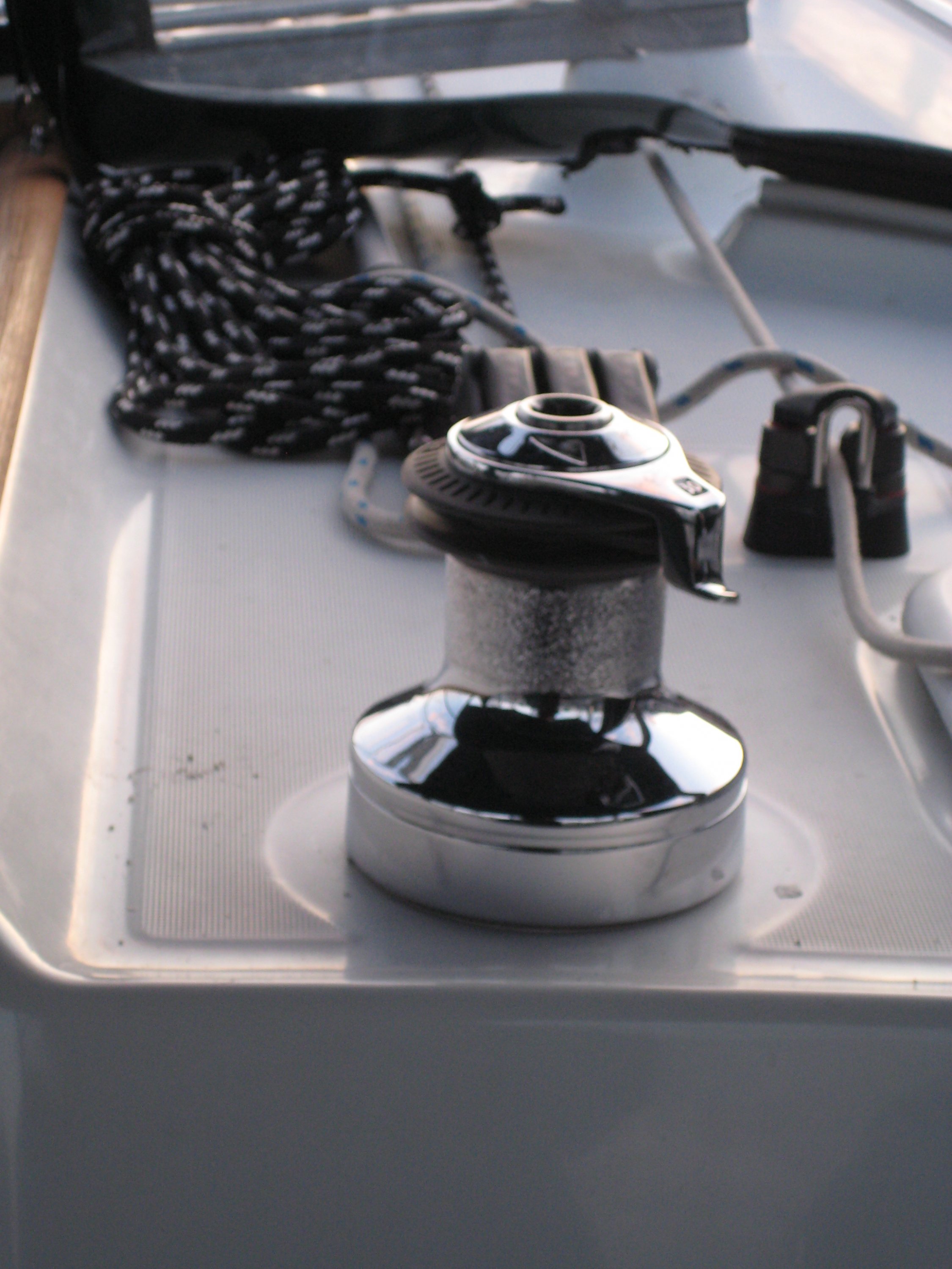

I also installed a new lewmar winch and spinlock clutches on the starboard cabin top. Might have been the easiest boat project to date. Remove the access plate. Use some masking tape to tape a garbage bag around the opening to collect dust and debris. Mark and drill your holes in the surfaces already laid out by Beneteau. Remove the garbage bag. Lay out some butyl tape. Have someone above and below and install your your hardware.
