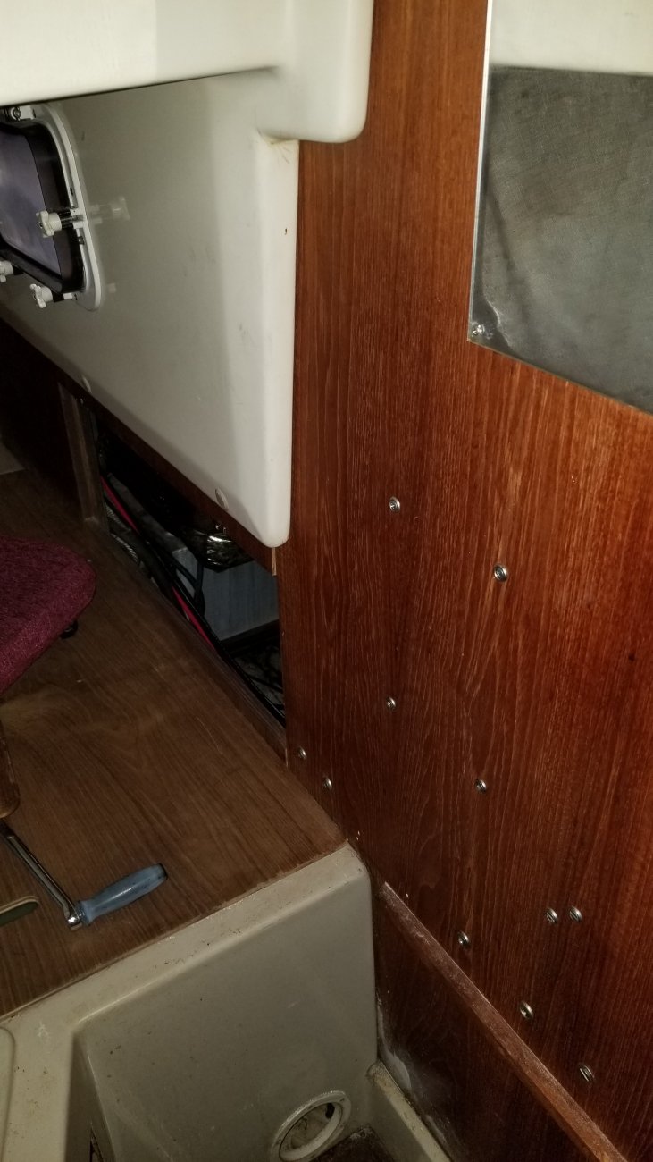

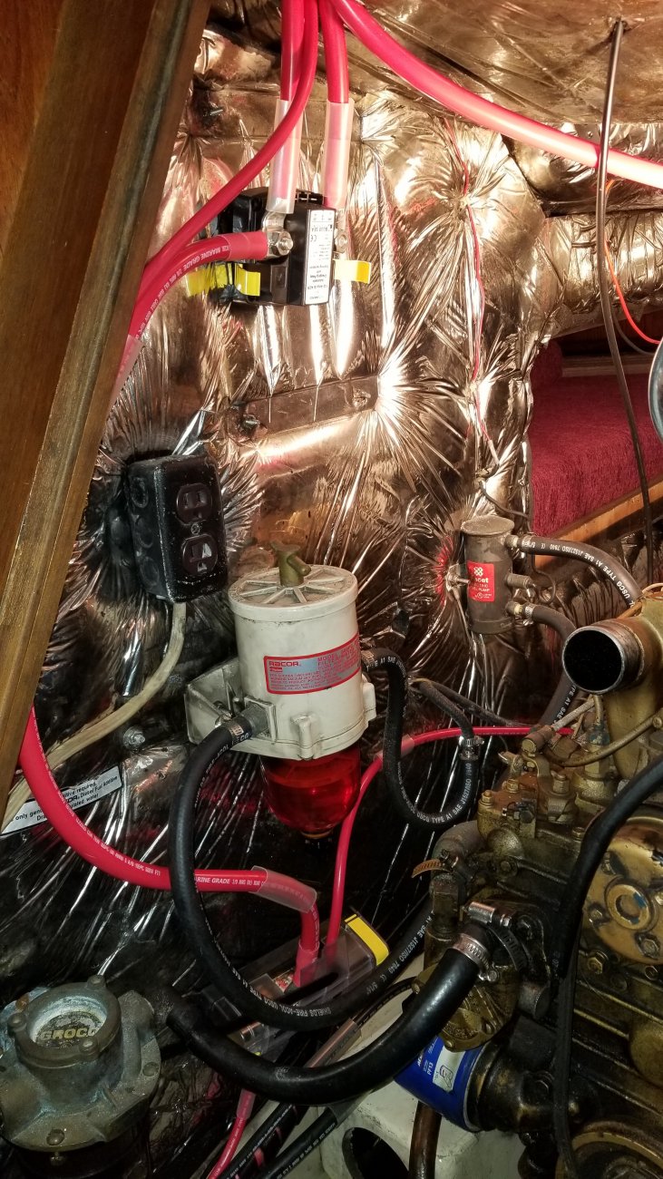

Not sure this will help, but this is the area where I want to re-arrange the existing items and secure the new items. Also pictured is the backside of the engine bay/aft cabin bulkhead with all of the fasteners. I'm not crazy about how everything mounted to the bulkhead compresses the insulation, so I'm wondering if it is feasible to fasten another plywood panel using some of the existing fastener holes, and using stand-offs so that the insulation isn't compressed. Then all the items that need mounting could be screwed directly to the plywood panel instead of the bulkhead.

I wouldn't worry too much about compressing some insulation. That insulation is for sound deadening, not for heat protection.
I would be concerned about the AC outlet in a metal box and I would be concerned about the type of wiring you plan to install in the engine compartment. The heat in the engine compartment will increase the resistance of any wiring runs that go through the compartment. Increased resistance leads to voltage drop, so wires and cables will have to be sized to compensate.

I’ve had success with cutting small wood mounting blocks into the insulation where I need them and sealing them with Mylar tape. That way the accessories are mounted over solid blocking and don’t crush the insulation.
If you create a mounting board in front of the insulation, you minimize the locations where the insulation is either crushed or interrupted, but you will have placed a noise reflecting surface in front of your otherwise sound absorbing insulation, which defeats part of it’s purpose. You will also effectively reduce the size of you engine compartment where every inch counts.
Bus bars in the engine compartment? Not sure what is going on there, and I am no electrician, but I think of bus bars as something that belongs in a reliably dry location behind an electrical panel or at least behind a cover of some sort.

I would compress the insulation behind some sort of spacer and I would be sure to seal the area of compression to insure that in the event that some kind of failure, say a fuel leak would not get behind the insulation.
