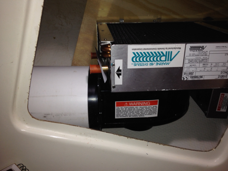

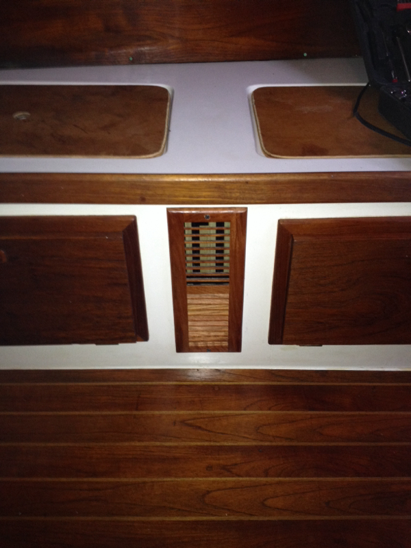

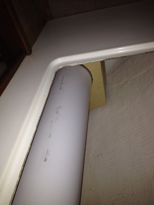

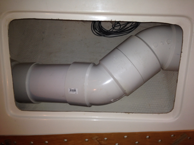

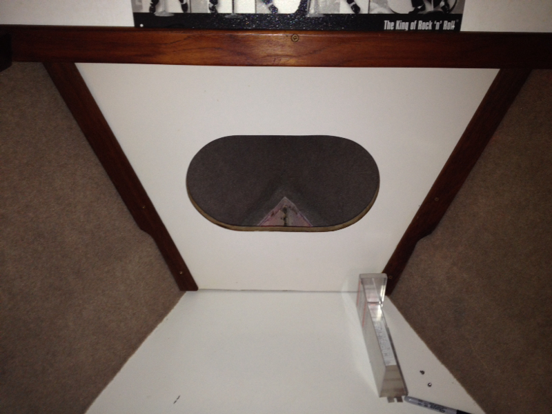

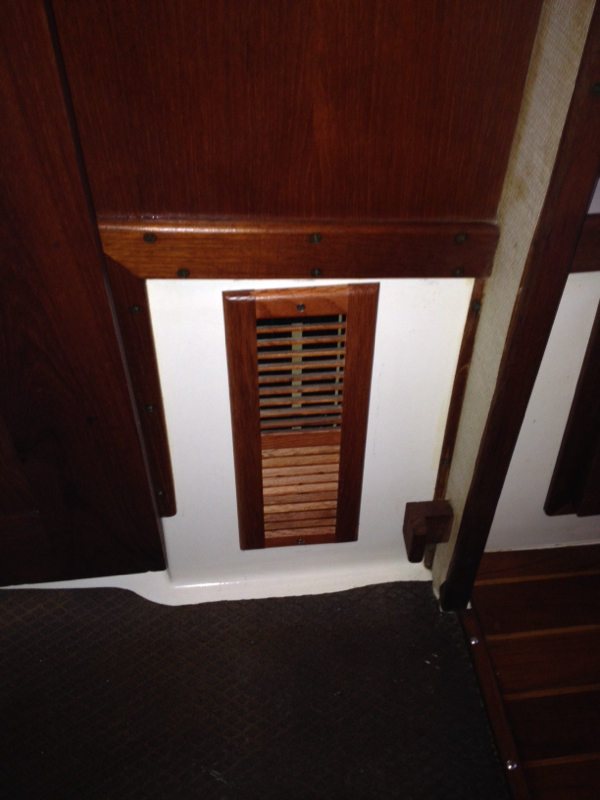

Well I decided to install it on the starboard side. The unit is in the v-birth at the front with the ducting running down the starboard side. I went with 6" PVC pipe for the ducting and made my boxes. I also used two 4"x 12" floor registers. I'm not done with the install; will keep you up to date as I have time.

The registers are red oak with cherry stain. The reason I went with PVC is because I was worried about damaging the flex pipe with all the stuff I store.

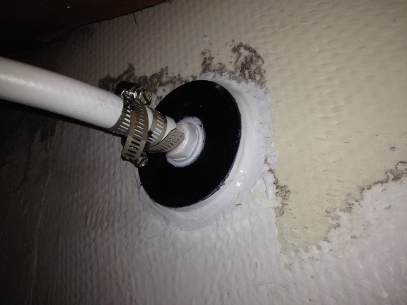

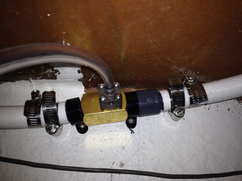

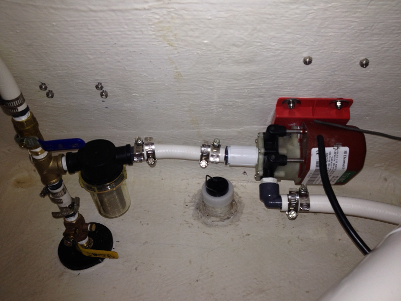

Here are some photos of the plumbing. The first one us the out line above the water line, thus is the Mermaid for the drain pan so the water will not have to go to the bulge, this the the water supply then the shut off then a T with another shut off for winterizing with the strainer and then the pump. This one us the area that will supply the return air. I will install a wire grade with a filter too. Still waiting for the wiring and breakers too; so I will give you a update later.

Feb 1, 2010
210
Hunter 33.5 El Dorado Lake, Kansas
Our v birth has three storage areas. The AC unit is in the one at the front and the pump, strainer and throw hull are on the starboard side. All the pipe goes down the starboard side throw the closet and then to the salon area. I hope this helps.
