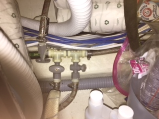

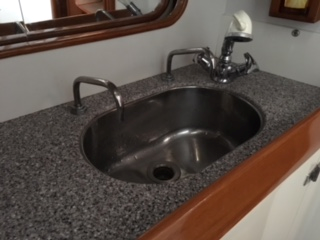

First, I would install a line from the water maker to a sink.
(On our boat, there are two spigots, one for the footpumped fresh water; and the second one, for the watermaker in the aft head's sink.)
This is allow you verify by taste and smell that you want to put what's coming out of the watermaker into you tanks. Also, it allows you take this water out and use it as part of the servicing of the tank (purifying, etc.) -- but that's a different subject.
Below the sink we put three valves which tee-off the line from the watermaker, This allows you, by creating a simple manifold with hardware store parts to i) use the sink, ii) put water in one or the other tanks.
We never turn-off the tank to the sink line. If the tank(s) are full, then the water once again comes out of the sink. I wouldn't every "block" the discharge line from the water maker. I was told that creates unacceptable back pressures in the water maker.
Once you commission a water maker, you need to continually and regularly use it; or, service it. You can't just drain it, let it freeze, or not flush it regularly. You need to keep it with a biocide in non-chlorinated water; except when you put the biocide in potable antifreeze, if you keep it winterized. Etc., etc., etc.
YOU NEED TO CHECK THE WATER COMING OUT OF IT BEFORE YOU PUT IN YOUR TANKS.
Water seeks it's own "level". You can cut new holes in your tank (which I wouldn't do; or you can run the lines from the water maker (manifold described above) and tee-them into lines that are from the tanks to your y-valve.

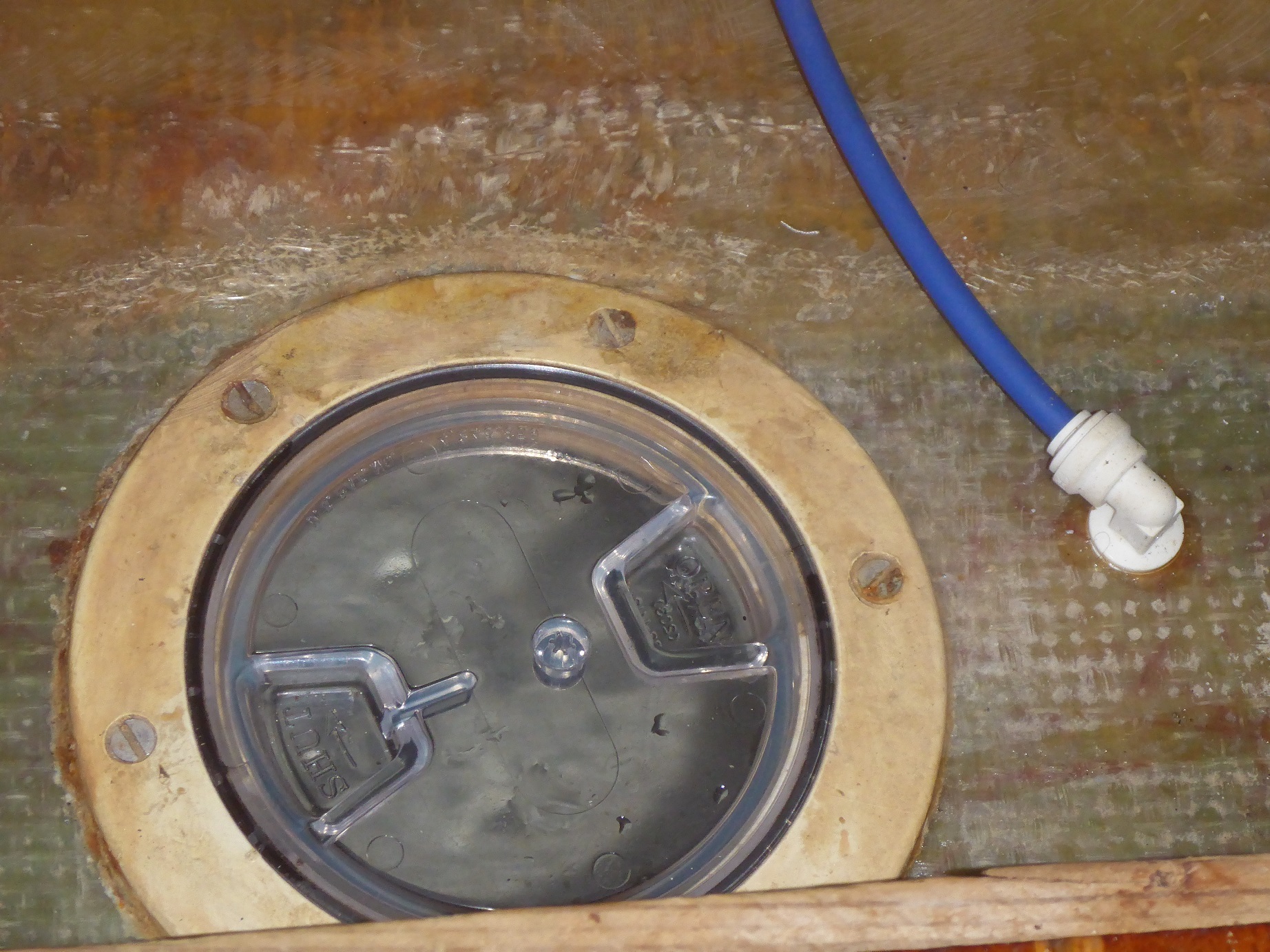

We built our own water maker system. We used 1/4" blue pex hose from the water maker output to a selector valve and then to each tank, terminating in a 90 degree pex fitting epoxied into the top of the tank.

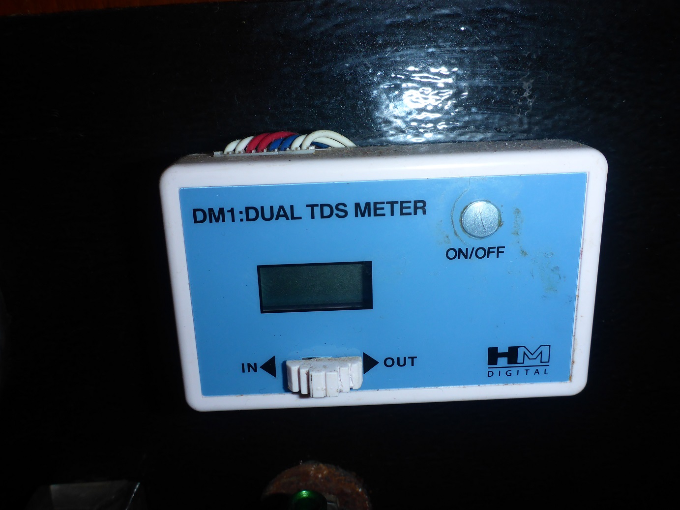

Mentioned above is the water testing. When I was designing our system I was just not interested in turning valves or pulling out hoses just to test the TDS of my water with a portable tester. I also wanted to monitor the water fairly often while the unit was operating, which would be a pain with a hand held tester. A quick search of the web (and I'm terrible at that) and I found this little beauty for about $25.00 that would install in the fresh water output line before the tank distribution manifold, and I can simply push a button to get my TDS reading, anytime. Attached to the panel w/velcro to change the battery which has had to be changed once in 7 years. And best of all, it has two probes, which means a spare should one fail: just slip it into the pex fitting.
Also, I used the proper size pex tube and fittings, color coded (normally green for sea water and blue for potable water) for all low pressure lines. They are fantastic IMO, zero maintenance and super easy to assemble or take apart if need be.

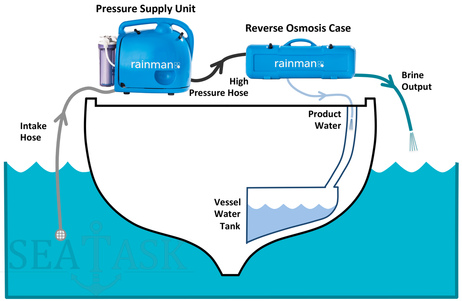

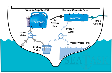

pateco
Aug 12, 2014
2,207
Rainman had some pictures of suggested installs.
Permanent:
Portable:
