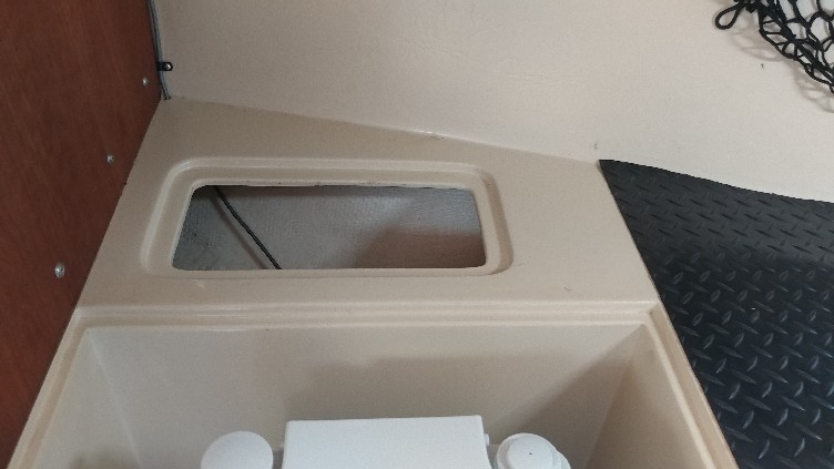

I am in the process of installing a "Visa 319 MSD" in our 1987 Catalina 22 New Design.
This 18 litre (4.75 us gallon) portapottie MSD is from a Canadian company
It's a newish product from what i can tell.
Price was good. (Cost me the equivalent of $140 USD from my local brick and mortar marine dealer)

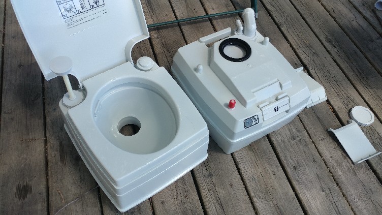

Seems well made. (Time will tell)
Has a dual action pump instead of a bellows. (Instructions say it needs to be lubricated occasionally)
Parts are available from my local marine supply store.

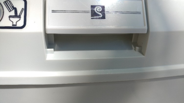

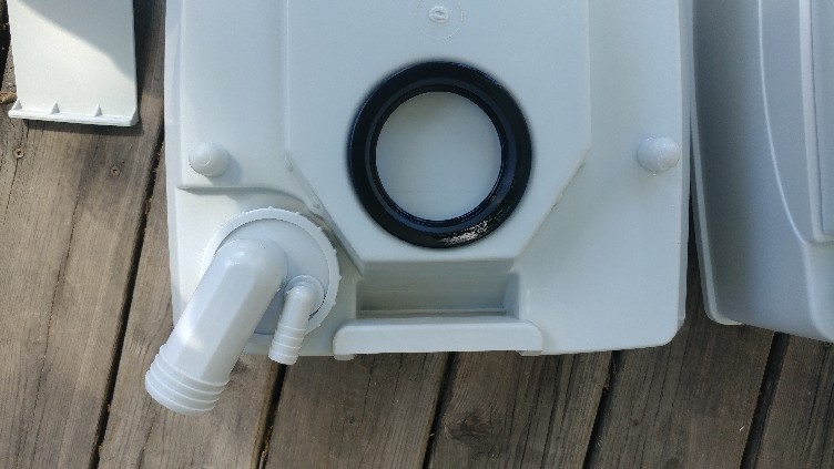

it comes configured for MSD use so you can hook it up to a pumpout and vent, but the a normal cap and spout are included if you ever need to dump in the old fashioned yucky way. The spout is stored in the bottom of the waste tank.

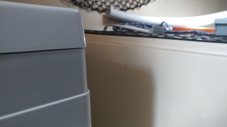

The pottie is too tall to have the v berth insert in place. Opening the lid makes little difference because of how the top section is made. This doesn't matter to us, because we took the v berth cushions out and use it simply as storage. YMMV.
The height is perfect for sitting on it, unlike our old 2 gallon dometic.
Hold downs attach front an back. They lock onto little ribs on the waste tank.
Time will tell how well they work. (@Gene Neill has posted complaints about how his Thetford hold downs work. Our old Sanipotty was ok, but the clamps were a bit loose due to age)

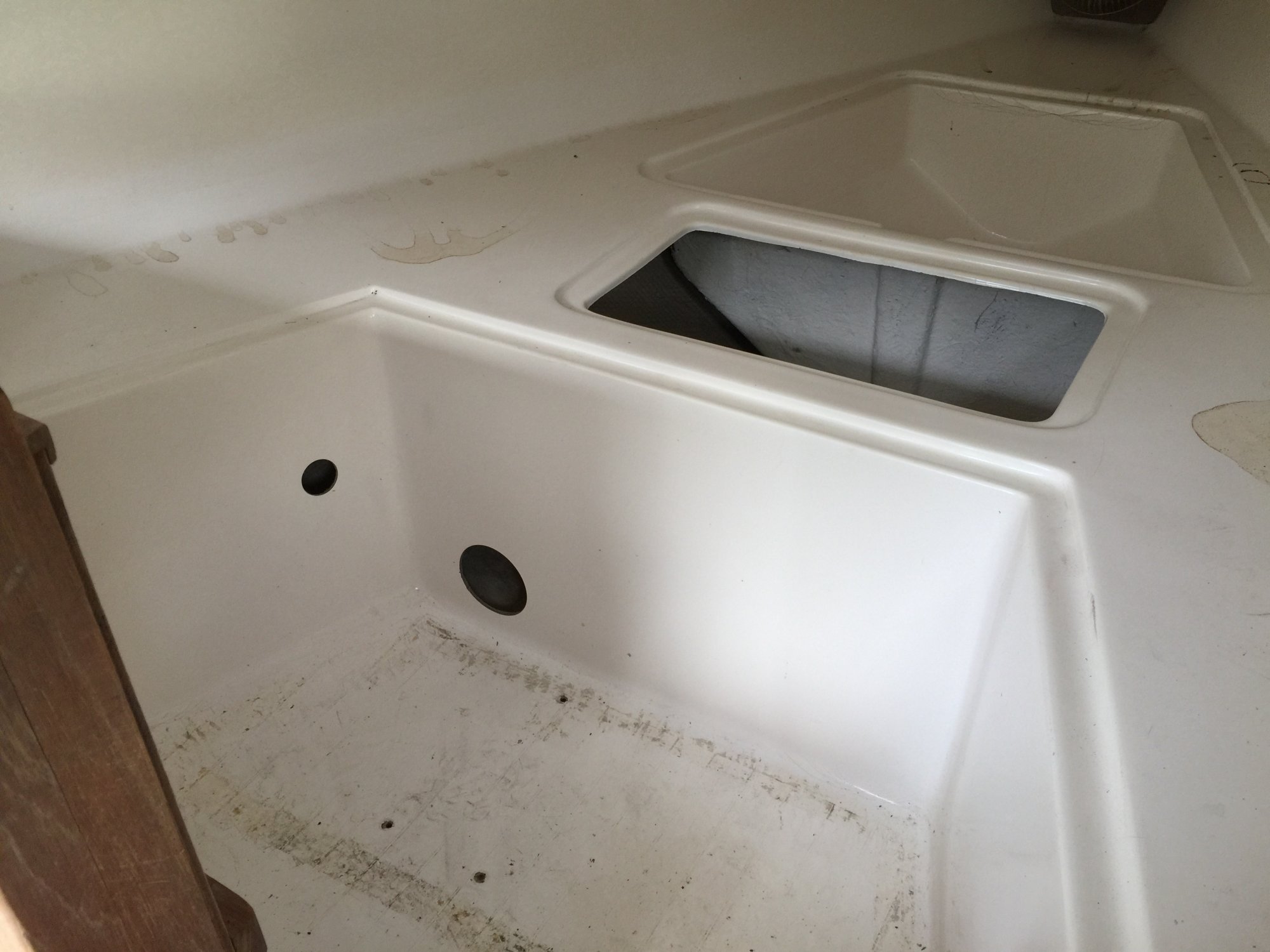

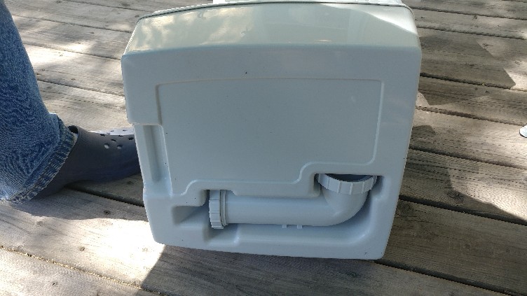

The waste tank outlets are configured differently that the Dometic units, but I don't think that will be an issue.
I will be running the vent and pumpout hoses to the same location as @AaronD did for his install.
That way i can use some left over plywood i have from my galley modification and create a nice removable cover for the hoses against the port bulkhead.
Stay tuned. Time to get out the hole saw.
If I'm reading that correctly, I would not want to have to retrieve it to use it...so you might want to store it somewhere else. :what:
Don't really see it as an issue. The toilet has a separate cap and spout. The photo shows the storage location for the spout.
If i ever need to empty it the old fashioned way, i would swap the pumpout fitting with the cap. Then remove it from the boat. Once in a bathroom or dump location, i would then install the spout.
I will store the cap where the toilet supplies are.
Fwiw: i wouldn't want to manually empty a heavy 5 gallon waste tank, while hunched over in a small C22. Here's hoping i never have to.
As for keeping the pump lubricated, do the instructions tell you what to use?
pump= silicone lube
flush valve gasket seal = vaseline or silicone lube

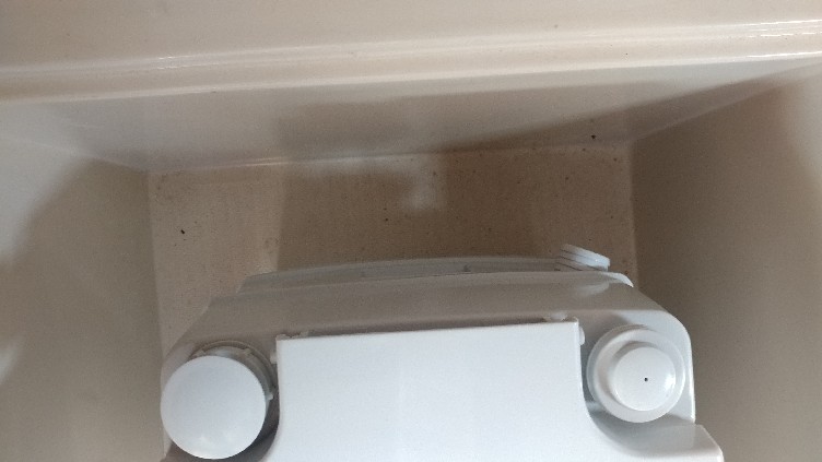

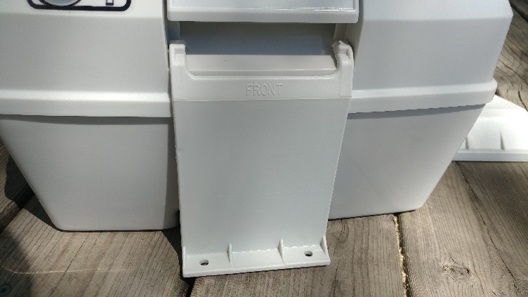

Just finished installing the potty hold down brackets.
Not sure how good they will be over the long term.
They appear to be designed so they sit tight to the front and back of the potty.
Because they are plastic, with angled sections that can flex, they look like they could flex enough to come unclipped from potty.
I screwed them to the cabin sole further away from the potty so they have some tension on them, but it worries me that the tension may eventually pull the screws loose so i will need to monitor that.
Hiya! Wondering how the brackets have held up for you over the years? I'm just about to install the same model of potty. What material did you attach the brackets to on the boat?
I sold the boat so I don't know the current condition of the unit. I will contact the new owner and see what he says.
Mar 20, 2015
3,298
C&C 30 Mk1 Winnipeg
Brackets were just attached like the original porta potty. Screws and washers.
New owner said the visa marine unit has worked fine so far.
