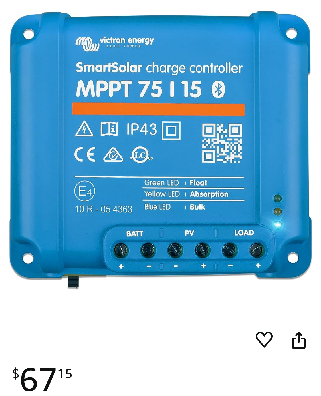

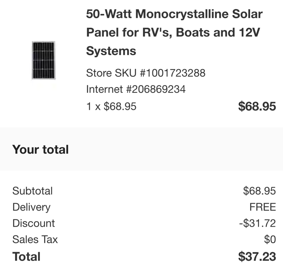

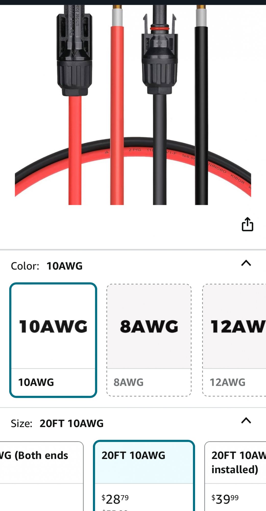

23,786
I like your thinking.
I am playing with a 50watt panel by GrapeSolar.
A controller from Victron.
And a wiring kit.
About $130 all in. If the test bed works it is easy to scale up
