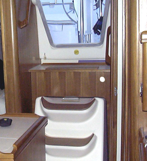

Hi Guys, Bought a Hobbs right after taking delivery of Java. I plan to install it just above the engine step where the white dot is, in the photo. Is there a different way to hook it up without running a wire all the way to the ignition swtich? Jim S/V Java Were are supposed to get 3-6 inches of snow tonight. Anyone wish to go sailing?

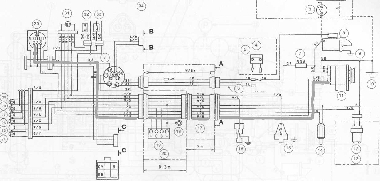

Wiring the Hobbs!
