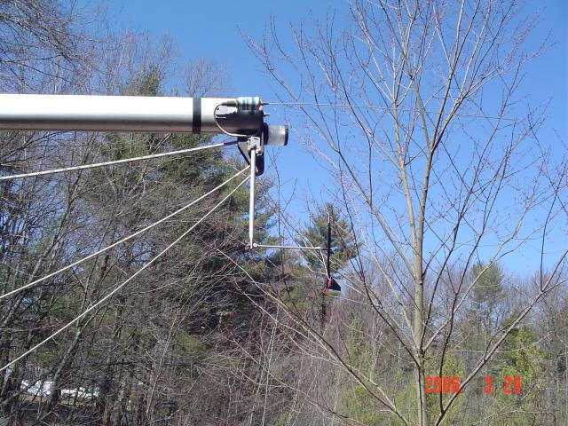

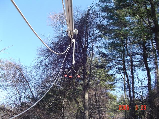

When I installed my coax cable years ago, I just bought the cable and the connectors separate and installed them myself. I don't remember how I ran it in the mast, but if I were to do it again I would disconnect the electric wire for the mast head anchor light and tie a string to it and pull it out. then I would tape the coax wire to it and pull them both back into the mast with the string. Use a polysulfide caulking for the thru-hull connector. Just snug up the connector and let the caulking set up for a day or two, and then tighten it down being careful not to allow the connector to turn. This same procedure also goes for any hardware on the boat that needs caulking. For the antenna, I was able to drill the holes and tap them for screw threads. If you don't have a Davis Windex at the top of your mast, now would be a good time to install it. I installed a 12" extension bracket facing aft for my Windex. It's out of the way of the antenna, and it's within perfect few from the cockpit. If for any reason you need to remove the Tabernacle from the mast; If it's stainless steel and it's held on with stainless steel machine screws, you should use thread lock cement on the screws. Also, stainless steel and Aluminum can cause corrosion through electrolysis. If you can separate the two metals somehow, it would be advisable. Anything you can use to insulate the two metals should work. Good luck.

Thanks for your feedback Joe. I don't have a mast head light so I don't have an easy way to pull the cable thru. The only light is on the front of the mast about 2/3 the way up. Should I have a mast head light? This would be the time to add that too. I did get the Windex recommended by the salesman at West Marine and do plan to install that at the same time. Thanks for the pictures. I like your Windex extension idea. Your comment about the polysulfide caulking for the thru-hull connector is appreciated. That's the kind of feedback I was hoping for.
