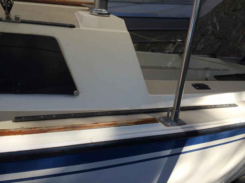

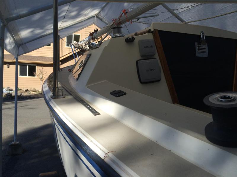

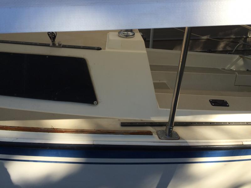

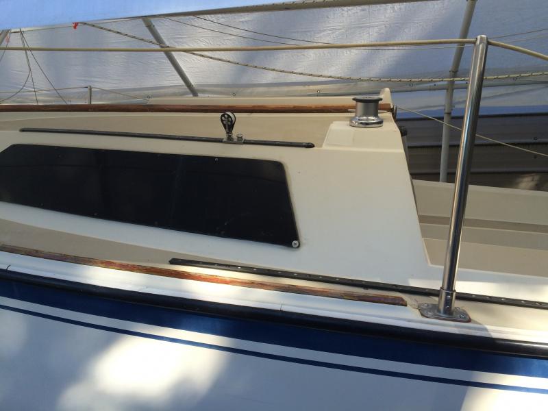

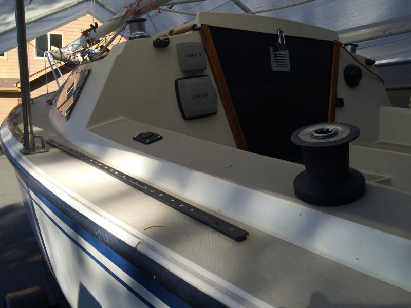

I'm looking to configure my genoa rigging to make "single handing" my 222 easier. I'm looking at mounting a second set of genoa tracks, and small winches that could be easily reached, and controlled from the cockpit. I've seen the pictures of the modification Joe Alves (rip) made on his 222, Trinkka, and I could easily copy that. But I'd like some comments/discussion on the best track placement location to make things easily reachable, adjustable, and providing the best angle for trimming the genoa shape.
I'm have 1"x39" tracks, and, for starters, plan on using "pin stop" track cars.
I've attached a couple of pictures of potential track location options. I'd appreciate thought/views, and anything I may be missing in the project.
