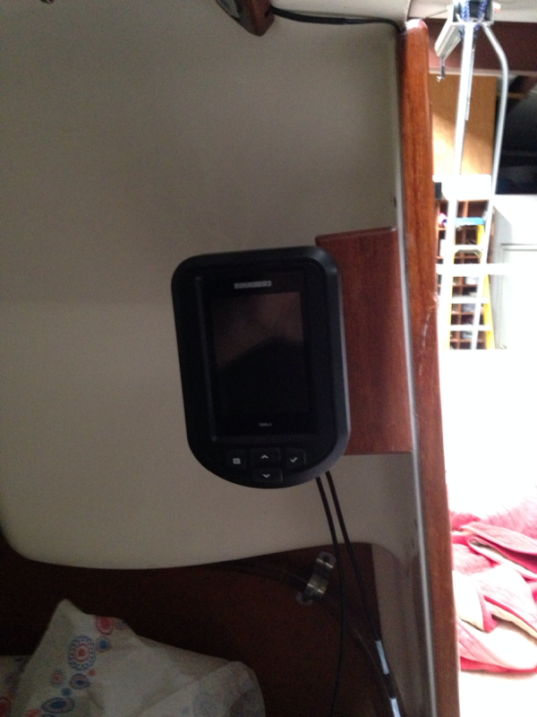

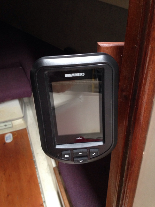

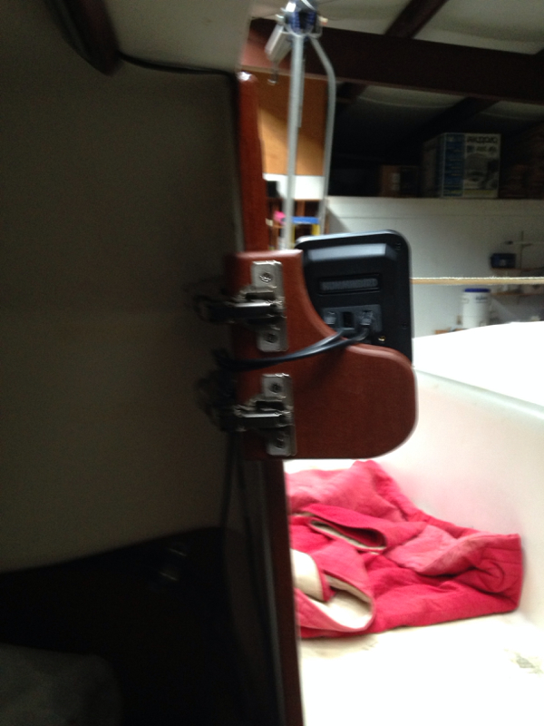

Installed depth finder
Ward H
Nov 7, 2011
3,815
I agree with Chief, very nice. Just might need to borrow this idea.
Jul 12, 2011
1,165
Leopard 40 Jupiter, Florida

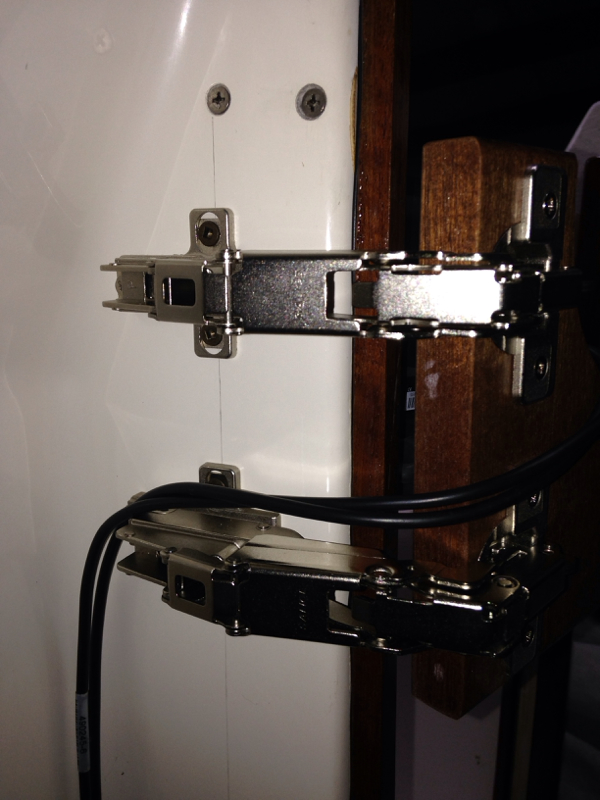

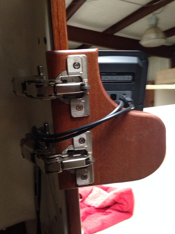

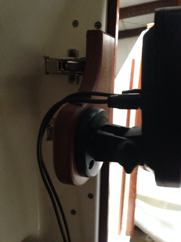

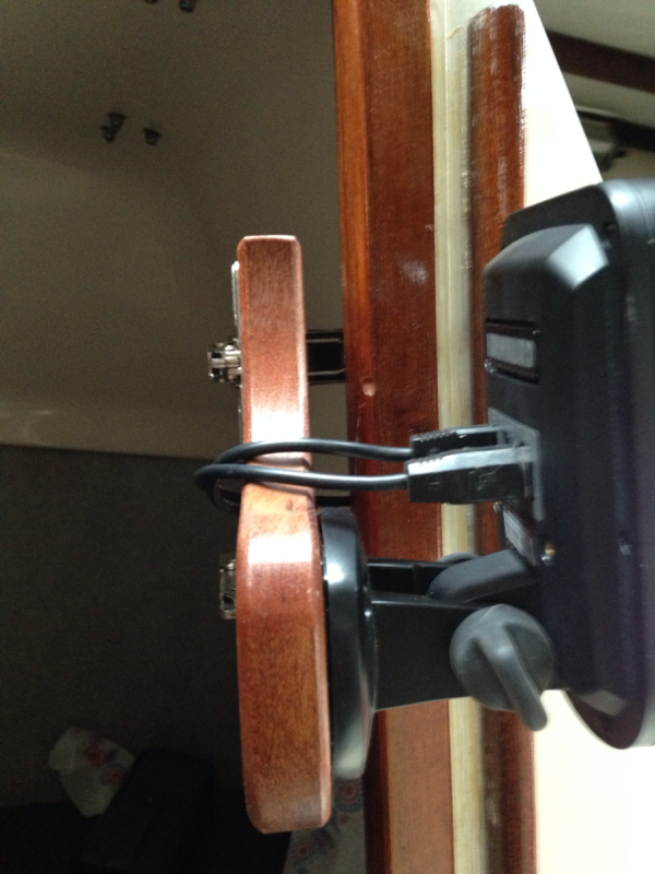

Great idea to keep it out of the weather when buttoned-up. How did you do the mounting bolts on the boat - screwed directly to fiberglass with wood screws, or through-bolted with a backing washer?
Apr 19, 2012
99
Hunter 18.5 Clark Hill
I predrilled holes through the fiberglass and into the back of the aft cabin board support for wood screws for the hinge plates. I used 3/4" long wood screws.
I used Salice hinges and plates.
Salice plate number: BAR3R29
Salice hinge number: C2RFP99
