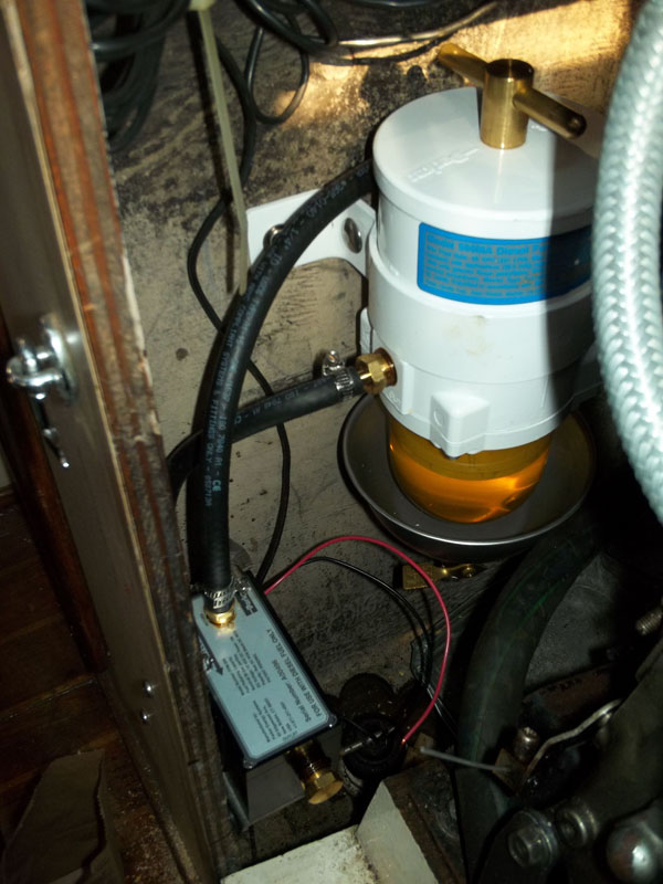

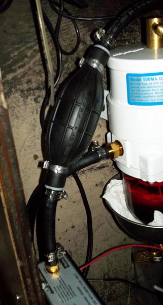

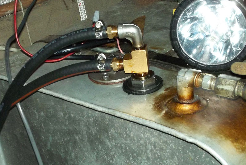

When I first changed the Racor's filter on my 2GM20F, it was so loaded with sediment, I couldn't understand how any fuel was getting through to the engine. I promptly bought a then new Parker polishing system, which has a small pump and another Racor filter. It sat on the parts pyramid for about two years, while I worked on other things. I'm happy to report that I installed it last week and it's working well. Part of my reluctance to tackle the job was my thinking that I had to cut into the hard fuel line coming from the tank. I finally found a way to modify the original fuel tank to accept a second pick up and return, so that the polisher runs completely independently of the engine's lines and filter. When done this way, you can run the polisher while the engine is running without affecting its performance.
I had the boat out for about ten hours last Saturday in pretty bumpy conditions. The tilt-o-meter was reading well over 30 degrees much of the time, so it was a great time to have the polisher running and taking advantage of all that agitation.
I'll attach a shot of the tank mod. More pics and details coming.
I know Maine Sail has said this system is no longer supported, and Defender has the Parker pump on closeout, but I was able to get support from the Parker folks when I had some questions during the install.
Here's the source for the tank pick up:
http://www.suremarineservice.com/
They also have the shut off valve that fits the bottom of the Racors for less than half what the official part goes for.
Forgive the wire nut in the background and the lack of double clamps on the hoses. I'm still cleaning up the install.
John
