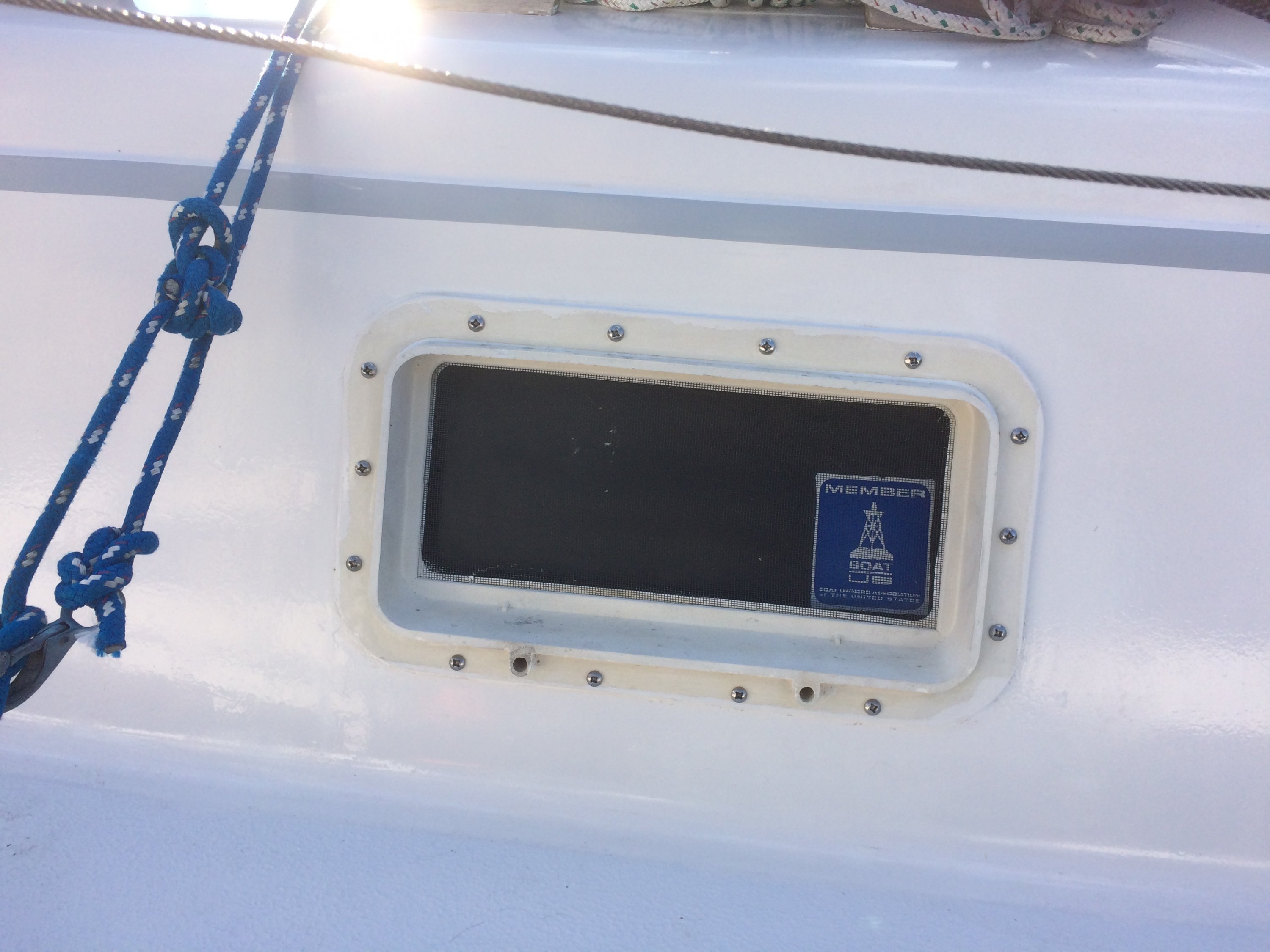

In addition to the Dow 795, I used a few screws to add a mechanical advantage.
I used one of the old rings as a template

Just finished four more on mine, now total of six, all with Dow 795. Seems to work fine. Easy to tool. Need to clamp the trim ring in place until the silicone sets up.
I used a full 10oz cartridge for my largest, 818's maybe 3/4 for the smaller 714's I think but that was last year.
