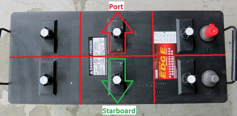

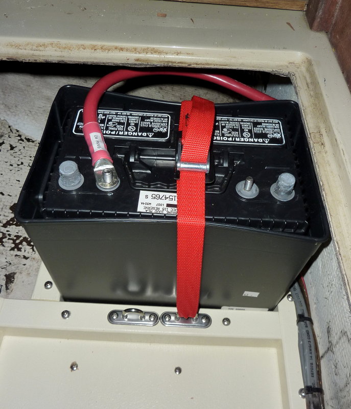

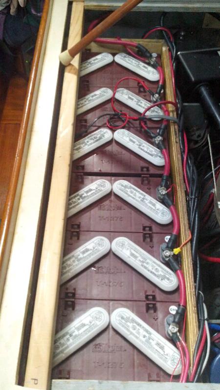

Maine Sail, I'm confused. I understand the logic behind mounting the batteries transverse so the plates stay covered, but I don't understand why +/- starboard/port orientation matters. What am I missing?
I'm perfectly willing to turn my (sealed) G31 battery 180 degrees, I'd just like to understand why I'm doing it. :D

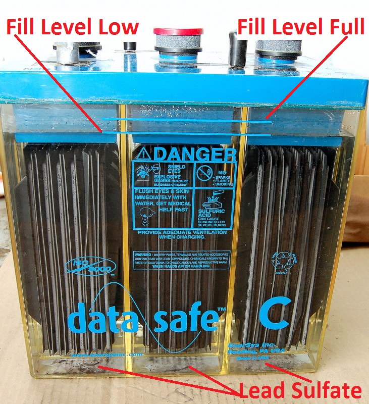

Studying the pictures MS posted, youll note that as you look down at the battery, the individual cells are generally rectangular shaped. Keeping the cells oriented so their longest sides are longitudinal with the boats center line axis will prevent most of the problems being discussed.
Note, were not talking about the entire battery, but the individual cells that make up the battery.
Oh, duh. I read his comment (several times too) to mean that it mattered which battery post was to starboard and which was to port, when you oriented the entire battery port/starboard (which mine is). I just couldn't figure out why it would matter which side of the boat the + post was facing as long as the cells were parallel with the center line axis.
I really shouldn't try to comprehend this kind of stuff after 9 PM. And especially not after a freezing cold weekend spent rerouting and replacing most the wiring between the battery, solar panel and main panel. :D
