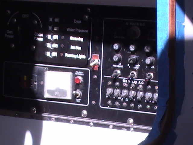

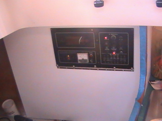

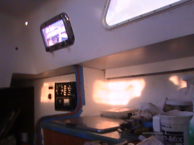

I did a complete wiring job on my 33 with shore power and an inverter wired into a distribution switch and a new panel for all 12 and 120 circuits, relocated the panel above the quarter birth. I hope this photo helps.

Bugaloo,
thanks for that, looks like a neat job. Can i ask where your shore power inlet is, and if it is > 10 ft from the distribution switch? If so, where and how did you add the initial breaker?
bugaloo - what year is your boat? your panel installation looks impressive. . . the pictures you posted, are they shots of different panels?

1978, I removed the pnl under the qbirth and installed another one above it. I built a wall above for the pnl to mount on. I rewired the complete boat (almost finished) the pnl is the same one with a few mods, it was bought on ebay for $35.00 and modified after I figured out what was to be on it. I can post more photos if u r interested
Yes, we definitely want more pictures- how you built the wall, everything... Thanks
