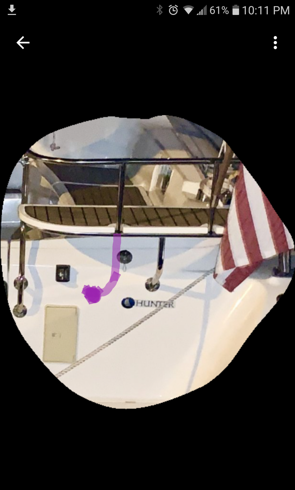

The stern pics show that the load path to the hull by the lower arm under the seat vs the location of the motor mount is
the cause for the deflection. As an Aircraft Engineer I would look at adding a similar connection directly under the engine mount to the hull. It should reduce and possibly eliminate the deflection. There might need to be additional larger backing plate that ties the 2 aft lower arms together.

This is what I was thinking, did it on the phone really quick.
This is exactly what I was thinking.... a stainless welder can do this easily. Also I must say I am not a big fan of the engine bracket as it puts the load in a small area at the top of the rail.. I have an edson engine bracket (bought at a consignment shop in Newport for $75. SCORE!!)... what I like about it is that it spreads the load vertically along the rail and does not create such a lever.

Well I guess I could do a static calculation based on exact measurements, weights and distances, but the design solution will be the same:cool: Like any boat owner that has pride in their vessel, I'd want it to match the original look and style so adding one arm under the vertical stanchion the motor mount is tied too will get the load to the stern. It might be better to move the additional arm inboard the same distance as the existing arm is offset to starboard too. This would be better because then the load will be equal to both lower arms. Thinking about this a bit more I'd try to make this work if there is space available inside stern. Backing plates inside with this approach is what I would still recommend, backing plates alone probable won't help the deflection.
