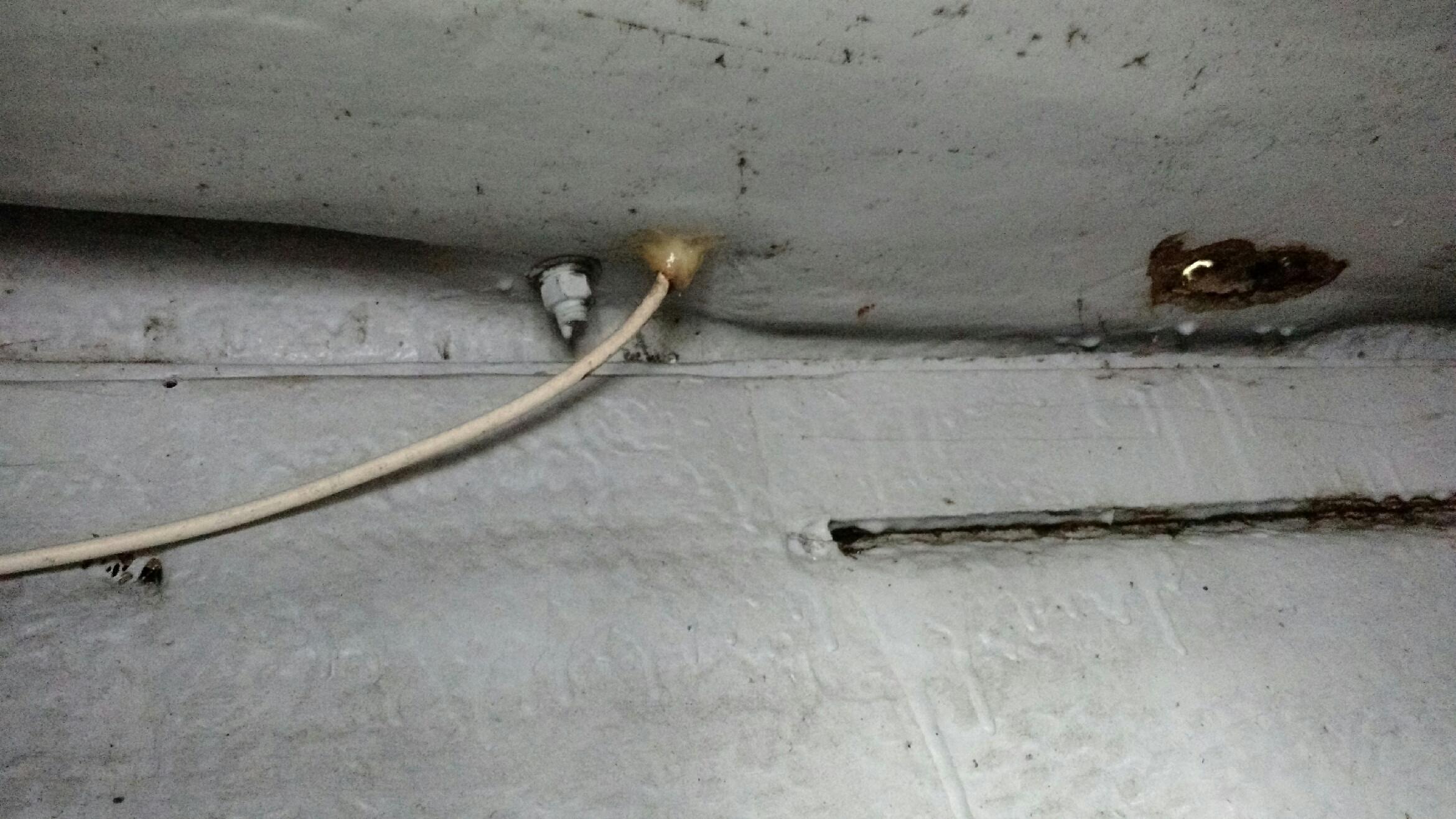

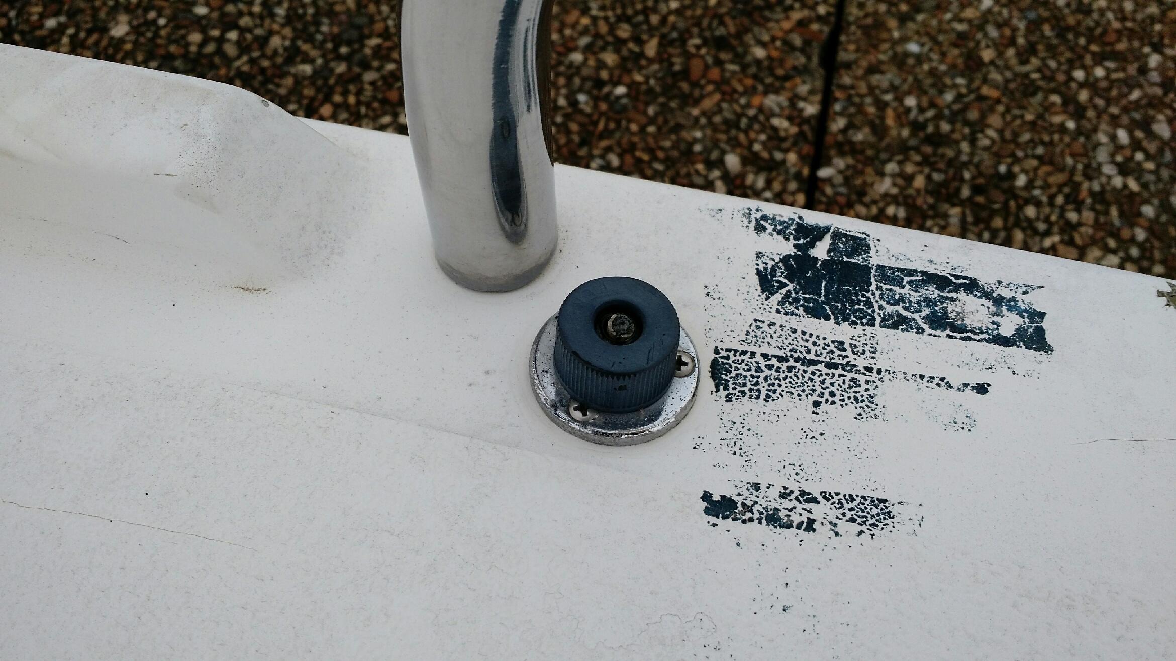

Here are the pics that you requested. I traced the original Coax cable it ran from the back of the old radio through the cabinetry into the starboard cockpit stowage compartment and connected to the thru deck old antenna port. It seems as though it had one that was broken off and this is all thats left.
24,478
I think you are looking at the end of the coax that ran through the deck seal (that's the fitting) attached to an antenna that was fitted to the pulpit.
You'll be able to remove the old coax. Run a new coax. You might be able to use the old one to fish the new coax to the same location in the cabin if the old wire is loose behind the cabinets.
