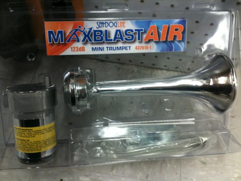

Forgot to mention, the SeaDog below was one I had been looking at last week. 123 dB and it's an air horn with an air pump. I'd really like a louder one but this one is interesting.
