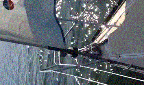

This spring I added an anchor roller on the bow and had to move the single large cleat to the port side of the foredeck. Now I want to install cleats on the toe-rail near the bow by incorporating an existing toe-rail bolt and then drilling a new hole to secure each cleat. Has anyone tried this? I am concerned that about leaks since the bolts will go through the toe-rail and the hull/deck joint. Would that be a problem? The new anchor roller is visible in the pic. (Sorry about the quality of the pic- I pulled it from a video) Thanks. Ed H
